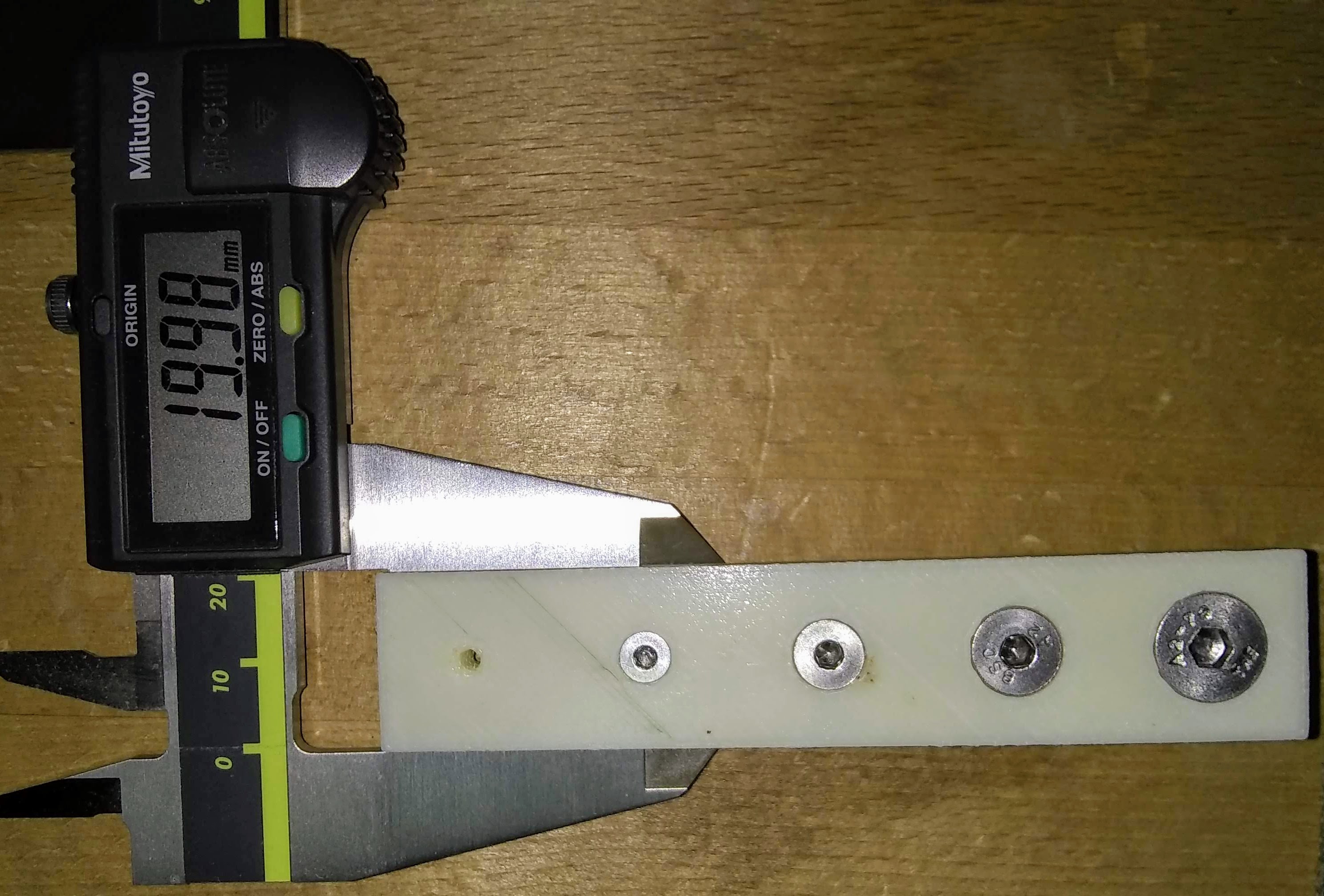

Sun, Jul 25, 2021 8:23 AM
I calibrated my machines about 10 years ago and have always used Skeinforge
for slicing. Recently I printed some test pieces for checking the fit of my
countersink holes. The test blocks were an arbitrary 100 x 20mm and when
somebody was asking me about calibration I measured the outside to see how
well my settings had held over time. Amazed to find they are within 0.1mm
over 100mm and .02mm under 20mm, so with 0.1% and 0.1mm.
[image: IMG_20210323_212659826.jpg]
[image: IMG_20210323_212544674.jpg]
And I can fit a 2in object in a 2 in hole with soft plastic like ABS, it
will be a press fit. I leave a 0.2mm gap if I want them to fit without
