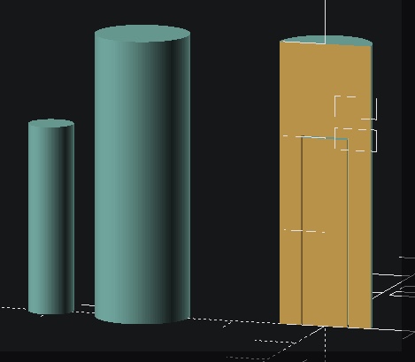

I’m pretty new to OpenSCAD but I have 50+ years of programming background, so I approach OS as a programming project.
Right from the beginning I defined t (for tolerance) and t2. I guessed at .1 mm for t and that has worked perfectly for me. This has produced positive and negative spaces that fit perfectly at least for me. I have an MK3S+ and use PrusaSlicer. For a negative volume I add t or t2 and for a positive volume I subtract one of them. Obviously when a surface does not have to accommodate another, a t adjustment is not necessary. This allows me to use nominal measurements and apply the tolerances where needed. The code below demos that idea. The plug should fit snugly in the sleeve, but still rotate easily. If I use t instead of t2 as the diameter tolerance I believe I’ll get a tight but usable fit. The last difference is an example of using t to avoid the shading that occurs when a positive and negative surface coincide. Sorry, the sample uses BOSL2. I only recently started using it, but I can’t get along without it now. I think you can see why I have t AND t2 from the sample.
include <BOSL2/std.scad>;
$fn = $preview ? 45 : 120;
t = .1;
t2 = 2 * t;
iD = 5;
oD = 10;
oH = 30;
iH = 20;
module sleeve() {
zcyl(h = oH, d = oD, anchor = DOWN);
// REMOVE
    zcyl(h = iH + t, d = iD + t2, anchor = DOWN);
module plug() {
zcyl(h = iH - t, d = iD - t2, anchor = DOWN);
left(20)
sleeve();
left(30)
plug();
sleeve();
plug();
// REMOVE
down(t)
cube([oD + t2, oD, oH + t2], anchor = [0, 1, -1]);

Back when I was designing the Snappy printable 3D printer, about six or seven years ago, I had a variable called printer_slop which worked pretty much the same. That has actually made its way into the BOSL2 library as $slop, which defaults to 0.0, but the user can set to what makes sense for their printer.
I found that $slop was often not needed for the XY accuracy of the printer, but instead for the slight layer staggering caused by a sloppy Z axis.
