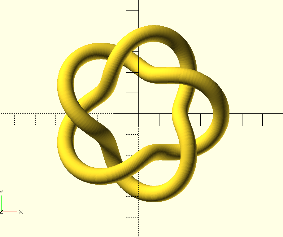

cinquefoil torus knot in openSCAD
Sat, May 27, 2023 11:45 AM
I thought this would be interesting for few of you
scad file can be downloaded from here:
https://github.com/sprabhakar2006/openSCAD/blob/main/cinquefoil%20torus%20knot.scad
[image: Screenshot 2023-05-27 at 5.03.47 PM.png]

simplest i can think of doing this in purely openSCAD is with following
code:
include<dependencies2.scad>
path=[for(t=[0:360])
[10cos(2t)(3+cos(5t)),
10sin(2t)(3+cos(5t)),
10sin(5t) ]];
p_line3dc(path,8);
you would need the file dependencies2.scad for the same (attached here)

My code is 400 times smaller (*):
d = 10;
R = 27;
rr = 10;
n = 5;
module onesphere (t)
r = R + rrsin (n360t);
x = r * sin (t * 2 * 360);
y = r * cos (t * 2 * 360);
z = rr * cos (n
360*t);
translate ([x,y,z]) sphere (d=d);
step=0.005;
for (t = [0:step:1]) {
hull () {
onesphere (t);
onesphere (t+step);
(less typing, i'd say :-) )
(Try n=3, 7, and 9 too! )
(*) Measured BEFORE I made it generic for n=...)

hull is not very neat in this case
for finer models you would need some modules like path_extrude, which
extrudes the circular section along the path.
long back i wrote this function which is in the file dependencies.scad
now mostly i work in python
if you try that, it would be a very smooth knot:
include<dependencies.scad>
path=[for(t=[0:359])
10sin(5t) ]];
sec=circle(4);
sol=path_extrudec(sec,path); // extrudec means closed extrusion
swp(sol); // module to render the extruded solid "sweep"

The turtle function in BOSL2 is meant for creating shapes that are
irregular in form.  This shape has a tidy mathematical definition, so using
turtle does not make sense.  If you want to do it in BOSL2, I'd suggest the
code below.  It's about 50x faster than the code posted by Rogier---10s for
Rogier's code vs 0.2s for the BOSL2 code.  Perhaps lazy unions would help
Rogier's code run faster---I didn't check.  I also think that the
polyhedron approach used in BOSL2 produces a better looking model.
include<BOSL2/std.scad>
$fn=32;
d = 10;
R = 27;
rr = 10;
n = 5;
step=0.005;
function onept(t) =
let(
r = R + rrsin (n360t),
x = r * sin (t * 2 * 360),
y = r * cos (t * 2 * 360),
z = rr * cos (n
360*t)
[x,y,z];
path = [for(t=[0:step:1]) onept(t)];
path_sweep(circle(d=d), path);
