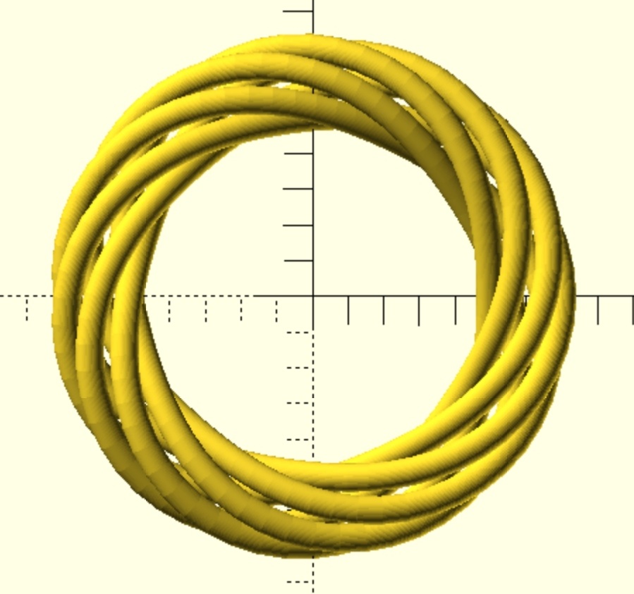

If step is set to 0.003, there's a gap in the figure.  0.002 and 0.001 go back to no gap.  That's all I tried.  The difference is that 0.003 doesn't fit evenly into 1 so the for loop needs to be adjusted to compensate.
Lenore

If step is set to 0.003, there's a gap in the figure. 0.002 and 0.001 go back to no gap. That's all I tried. The difference is that 0.003 doesn't fit evenly into 1 so the for loop needs to be adjusted to compensate. Lenore > On May 30, 2023, at 22:39, Adrian Mariano <avm4@cornell.edu> wrote: > > include<BOSL2/std.scad> > $fn=32; > > d = 10; > R = 27; > rr = 10; > n = 5; > step=0.005; > > function onept(t) = > let( > r = R + rr*sin (n*360*t), > x = r * sin (t * 2 * 360), > y = r * cos (t * 2 * 360), > z = rr * cos (n*360*t) > ) > [x,y,z]; > > path = [for(t=[0:step:1]) onept(t)]; > > path_sweep(circle(d=d), path);
Wed, May 31, 2023 11:22 AM
It will look better if the step size evenly divides the range, but if you
really want to use a stepsize that does not, add closed=true to the
path_sweep call in order to close the shape.  That will eliminate the gap.

Adrian, I added closed=true and it threw up a syntax error. So I updated my bosl2 from github- no difference. If I change it to closed=false it's happy, but it won't work with closed=false. Any ideas? On 2023-05-31 21:22, Adrian Mariano wrote: > It will look better if the step size evenly divides the range, but if > you really want to use a stepsize that does not, add closed=true to > the path_sweep call in order to close the shape.  That will eliminate > the gap. > > -- Cheers, Ken bats059@gmail.com https://vk7krj.com https://vk7krj.com/running.html ---------------------------------------- A baby can be defined as an ego with a noise at one end and a smell at the other. Your job as parents is to teach them to control all three. My job as a grandad is to tell you how you are doing it all wrong!
LH
Lenore Horner
Wed, May 31, 2023 1:57 PM
I got an error when I used closed=true with a step that divides evenly into 1 but when the step doesn't divide evenly into 1 the closed=true works (no error message and no gap in the structure).
Lenore

I got an error when I used closed=true with a step that divides evenly into 1 but when the step doesn't divide evenly into 1 the closed=true works (no error message and no gap in the structure). Lenore > On May 31, 2023, at 09:34, Ken <bats059@gmail.com> wrote: > > Adrian, I added closed=true and it threw up a syntax error. So I updated my bosl2 from github- no difference. If I change it to closed=false it's happy, but it won't work with closed=false. > Any ideas? > > On 2023-05-31 21:22, Adrian Mariano wrote: >> It will look better if the step size evenly divides the range, but if you really want to use a stepsize that does not, add closed=true to the path_sweep call in order to close the shape. That will eliminate the gap. >> >> > > -- > Cheers, Ken > bats059@gmail.com > https://vk7krj.com > https://vk7krj.com/running.html > ---------------------------------------- > A baby can be defined as an ego with a noise at one end and a smell at the other. > Your job as parents is to teach them to control all three. > My job as a grandad is to tell you how you are doing it all wrong! > _______________________________________________ > OpenSCAD mailing list > To unsubscribe send an email to discuss-leave@lists.openscad.org
K
Ken
Wed, May 31, 2023 3:30 PM
Thanks Lenore, that fixed it.

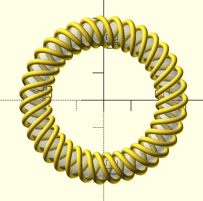

path=[for(t=[0:359]) [10*cos(2*t)*(3+cos(11*t)), 10*sin(2*t)*(3+cos(11*t)), 10*sin(11*t) ]]; keep increasing the number 5*t -> 7*t ->11*t and you can see more interesting knots On Sat, 27 May 2023, 19:00 Sanjeev Prabhakar, <sprabhakar2006@gmail.com> wrote: > hull is not very neat in this case > > for finer models you would need some modules like path_extrude, which > extrudes the circular section along the path. > > long back i wrote this function which is in the file dependencies.scad > now mostly i work in python > if you try that, it would be a very smooth knot: > > include<dependencies.scad> > > path=[for(t=[0:359]) > [10*cos(2*t)*(3+cos(5*t)), > 10*sin(2*t)*(3+cos(5*t)), > 10*sin(5*t) ]]; > > sec=circle(4); > > sol=path_extrudec(sec,path); // extrudec means closed extrusion > swp(sol); // module to render the extruded solid "sweep" > > > > > On Sat, 27 May 2023 at 18:27, Rogier Wolff <R.E.Wolff@bitwizard.nl> wrote: > >> On Sat, May 27, 2023 at 01:36:39PM +0100, terrypingm@gmail.com wrote: >> > Brilliant, can’t wait to see how it’s done! >> >> My code is 400 times smaller (*): >> >> --------------------------- >> d = 10; >> >> R = 27; >> rr = 10; >> n = 5; >> >> module onesphere (t) >> { >> r = R + rr*sin (n*360*t); >> x = r * sin (t * 2 * 360); >> y = r * cos (t * 2 * 360); >> z = rr * cos (n*360*t); >> translate ([x,y,z]) sphere (d=d); >> } >> >> step=0.005; >> >> for (t = [0:step:1]) { >> hull () { >> onesphere (t); >> onesphere (t+step); >> } >> } >> ------------------------------- >> >> (less typing, i'd say :-) ) >> >> (Try n=3, 7, and 9 too! ) >> >> Roger. >> >> (*) Measured BEFORE I made it generic for n=...) >> >> > >> > BTW, I’d expect it will be interesting to MANY not FEW. ;-) >> > >> > -- >> > Terry >> > >> > On 27 May 2023, at 12:46, Sanjeev Prabhakar <sprabhakar2006@gmail.com> >> wrote: >> > >> >  >> > I thought this would be interesting for few of you >> > >> > scad file can be downloaded from here: >> > >> https://github.com/sprabhakar2006/openSCAD/blob/main/cinquefoil%20torus%20knot.scad >> > >> > <Screenshot 2023-05-27 at 5.03.47 PM.png> >> > >> > _______________________________________________ >> > OpenSCAD mailing list >> > To unsubscribe send an email to discuss-leave@lists.openscad.org >> >> > _______________________________________________ >> > OpenSCAD mailing list >> > To unsubscribe send an email to discuss-leave@lists.openscad.org >> >> >> -- >> ** R.E.Wolff@BitWizard.nl ** https://www.BitWizard.nl/ ** +31-15-2049110 >> ** >> ** Delftechpark 11 2628 XJ Delft, The Netherlands. KVK: 27239233 >> ** >> f equals m times a. When your f is steady, and your m is going down >> your a is going up. -- Chris Hadfield about flying up the space shuttle. >> _______________________________________________ >> OpenSCAD mailing list >> To unsubscribe send an email to discuss-leave@lists.openscad.org >> >
Wed, May 31, 2023 5:35 PM
more generally the equation will be of the form
a=6;
p=6;
q=11;
[10cos(pt)(a+cos(qt)),
10sin(pt)(a+cos(qt)),
-10sin(qt)] ];
you can vary the values of a, p and q
with above values of a,p and q the result is attached

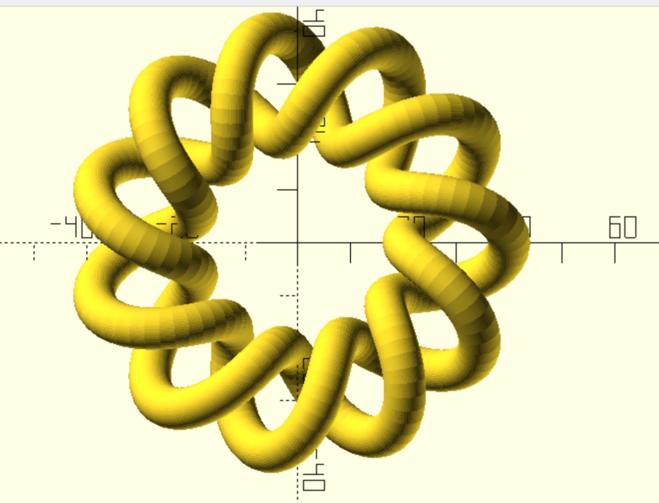

I've been having a lot of fun playing around in Customizer:
// Sanjeev Prabhakar via emwd.com 5/27/2023
// 1 for single twist, 2 for double, 3 for triple was:2 good: 5
alp = 2;
// larger increases radius of the 'ring' was:3 good: 4
plu = 3;
// was: 5 larger is number of minor 'cycles' around the 'torus' good: 13
mul = 5;
sec = circle(4);
path2 = [for(t=[0:359])
[10cos(alpt)(plu+cos(mult)),
10sin(alpt)(plu+cos(mult)),
10sin(mult) ]];
sol2 = path_extrudec(sec, path2); // extrudec means closed extrusion
swp(sol2); // module to render the extruded solid "sweep"

refer to the file attached
added some explanation
this is quite interesting
[image: Screenshot 2023-06-07 at 10.01.40 PM.png]
