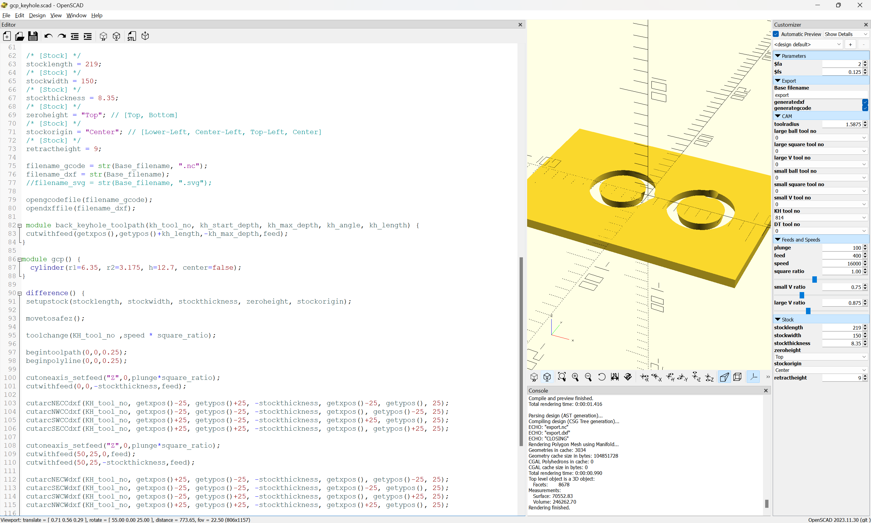

I've actually just finished adding support for arcs in my current project:
[image: Inline image]
(though I need to improve it to have Z-axis movement/cutting as well, and
yes, for some reason the arc generated come in as 25.1mm x 25mm curves
which don't meet up so as to make a circle, and they generate an error when
importing the DXF into some programs...)
Once that is done, I eventually hope to start working on adding some sort
of support for curves in 3 dimensions, or representing a curved surface ---
what is a way to do this which is:
  • reasonably concise
  • expressive and powerful
  • suitable to be calculated out within OpenSCAD
My current plan is to just do curves of tool movement in 3 dimensions ---
an overhead view of a Bézier curve for X and Y coordinates, and a
representation of a side view as a curve which shows Y and Z coordinates
--- to make a curved surface it would be necessary to arrange a sufficient
number of toolpaths so as to represent that tool movement when cutting out
that surface and ultimately this would need to be captured as G-code for
making that cut.

and I would be glad of reading recommendations, or example code which is
carefully and thoroughly explained.
https://designinto3d.com/
I have posted an example of my design approach in a youtube video (designing a mobile stand). https://youtu.be/qb4QSLyCpNI On Mon, 3 Jun 2024 at 06:58, Sanjeev Prabhakar <sprabhakar2006@gmail.com> wrote: > I am not good at explaining things. When I start explaining with diagrams, > it takes too long and I don't have that much time. > You can read the code in my github file openscad1.py and I can answer some > specific questions. > There are some 18 types of arc functions defined. > Key idea in these functions is to define the arcs in 2d which are not very > tough to define in openscad language as well and thereafter the same > functions can be used in 3d arcs. What you need is a method to transform 3d > points to 2d and then back to 3d at its original location. > Also there is no complex mathematics involved here > > On Sun, 2 Jun 2024 at 21:47, William F. Adams via Discuss < > discuss@lists.openscad.org> wrote: > >> On Sunday, June 2, 2024 at 07:26:06 AM EDT, Jon Bondy via Discuss < >> discuss@lists.openscad.org> wrote: >> >> The OpenSCAD file is incomprehensible, to the point of being useless. >> You are writing in Python, not in OpenSCAD. You are just using OpenSCAD as >> rendering engine. >> >> Let's turn this around --- if there was an OpenSCAD module for >> representing such a design what would the interface look like? >> >> I've asked before about representing curved surfaces in a fashion which >> was elegant and expressible, and which folks who do not have an >> understanding of higher maths could not merely grasp, but also write/use >> --- while a couple of techniques have been put forward, I wasn't able to >> wrap my mind around them, and I will readily admit to this being my >> deficient education. >> >> I've actually just finished adding support for arcs in my current project: >> >> https://github.com/WillAdams/gcodepreview >> >> [image: Inline image] >> >> >> (though I need to improve it to have Z-axis movement/cutting as well, and >> yes, for some reason the arc generated come in as 25.1mm x 25mm curves >> which don't meet up so as to make a circle, and they generate an error when >> importing the DXF into some programs...) >> >> Once that is done, I eventually hope to start working on adding some sort >> of support for curves in 3 dimensions, or representing a curved surface --- >> what is a way to do this which is: >> >> - reasonably concise >> - expressive and powerful >> - suitable to be calculated out within OpenSCAD >> >> My current plan is to just do curves of tool movement in 3 dimensions --- >> an overhead view of a Bézier curve for X and Y coordinates, and a >> representation of a side view as a curve which shows Y and Z coordinates >> --- to make a curved surface it would be necessary to arrange a sufficient >> number of toolpaths so as to represent that tool movement when cutting out >> that surface and ultimately this would need to be captured as G-code for >> making that cut. >> >> At one point in time I had a number of links which I had researched: >> >> >> - >> https://en.wikibooks.org/wiki/OpenSCAD_User_Manual/Other_Language_Features#Surface >> - Thingiverse: Bezier Heart in OpenScad >> <https://www.thingiverse.com/thing:8483> >> - https://www.thingiverse.com/thing:8931 >> - >> http://climberg.de/page/openscad-implementation-of-bezier-curves-of-any-degrees/ >> https://climberg.de/post/openscad_bezier_curves >> - https://github.com/JustinSDK/dotSCAD [19] >> <http://forum.openscad.org/larger-number-of-control-points-for-Bezier-td22435.html> >> https://openhome.cc/eGossip/OpenSCAD/BezierCurve.html >> https://openhome.cc/eGossip/OpenSCAD/lib-bezier_surface.html >> - http://forum.openscad.org/smooth-3-D-curves-tc7766.html >> - https://github.com/RLuckom/bezier-scad >> https://www.raphaelluckom.com/posts/bezier_curves.html >> - >> http://forum.openscad.org/Rectangle-with-one-curved-edge-td21097.html >> - http://kitwallace.tumblr.com/post/76273401911/loxodrome-in-openscad >> - http://www.thingiverse.com/thing:1208001 [20] >> <http://forum.openscad.org/Spline-interpolation-nSpline-td15207.html> >> - https://www.blockscad3d.com/community/projects/68284 >> >> >> >> >> and I would be glad of reading recommendations, or example code which is >> carefully and thoroughly explained. >> >> William >> >> -- >> https://designinto3d.com/ >> Sphinx of black quartz, judge my vow. >> >> >> >> >> _______________________________________________ >> OpenSCAD mailing list >> To unsubscribe send an email to discuss-leave@lists.openscad.org >> >
