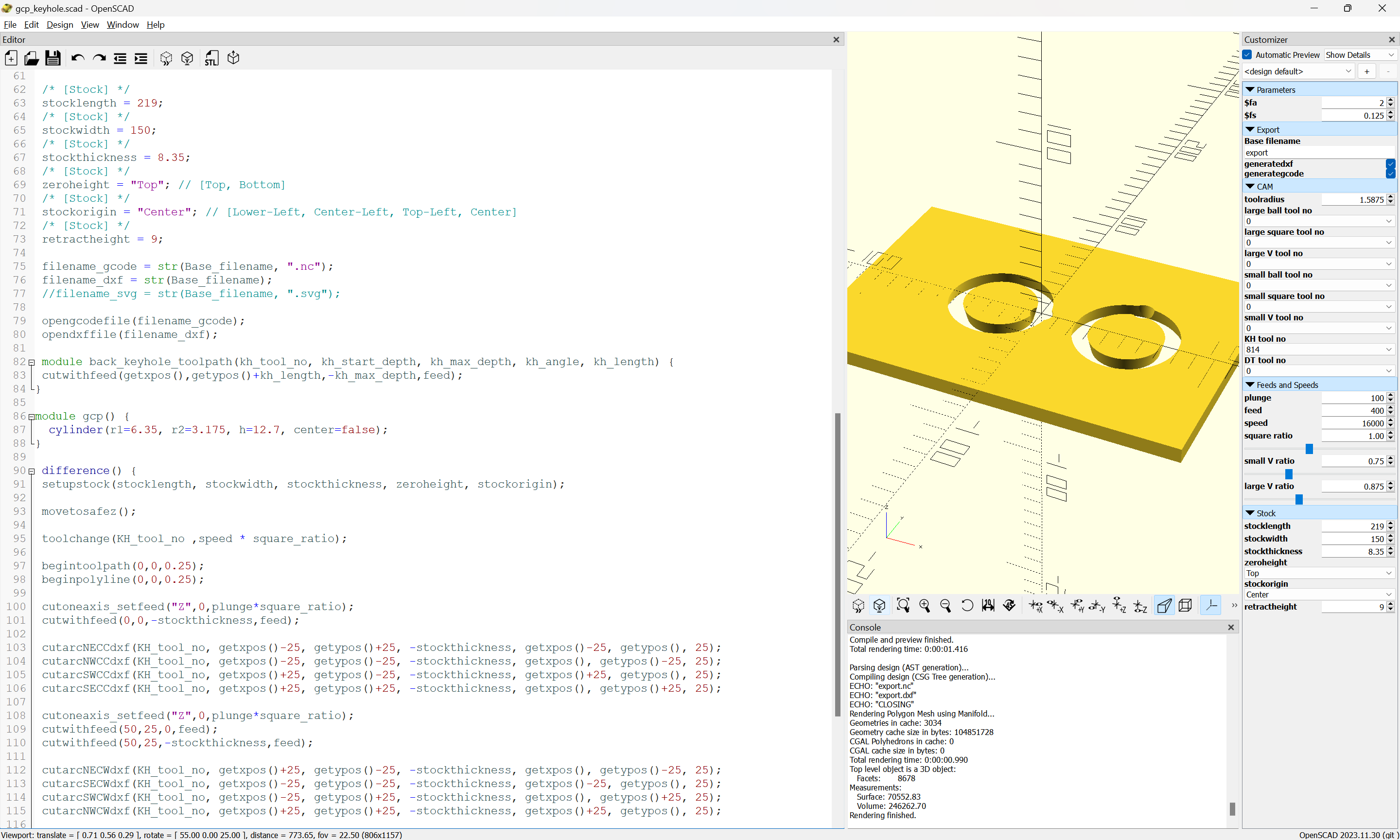

I've actually just finished adding support for arcs in my current
project:
[image: Inline image]
(though I need to improve it to have Z-axis movement/cutting as well,
and yes, for some reason the arc generated come in as 25.1mm x 25mm curves
which don't meet up so as to make a circle, and they generate an error when
importing the DXF into some programs...)
Once that is done, I eventually hope to start working on adding some
sort of support for curves in 3 dimensions, or representing a curved
surface --- what is a way to do this which is:
  • reasonably concise
  • expressive and powerful
  • suitable to be calculated out within OpenSCAD
My current plan is to just do curves of tool movement in 3 dimensions
--- an overhead view of a Bézier curve for X and Y coordinates, and a
representation of a side view as a curve which shows Y and Z coordinates
--- to make a curved surface it would be necessary to arrange a sufficient
number of toolpaths so as to represent that tool movement when cutting out
that surface and ultimately this would need to be captured as G-code for
making that cut.

You are assuming that a bezier curve can be represented by its endpoints
and two control points, I think.  That means you are assuming cubic
beziers.  But if you want to establish G2 continuity then cubic beziers
probably do not suffice.  I had to use quartic ones for that purpose.  It
may be that ultimately beziers aren't powerful enough.  That xnurbs thing I
linked to earlier is using nurbs, after all, which are much more powerful
than beziers.
I'm not sure what you mean about "derive a bezier from half of two other
curves".  But maybe this also links to the question about
3-dimensionality.  A cubic bezier surface requires a 4x4 array of control
points, and you don't seem to include that situation in your framework.
I'm not sure how you imagine that the different planes give rise to full
three dimensionality.
It seems to me like you need some method to be able to construct a bezier
patch (3d surface section) and then construct a continuation that mates to
the first one.  But it's not clear how to manage this, especially when it
comes to closing corners, and how to ensure that everything meets up
consistently.
