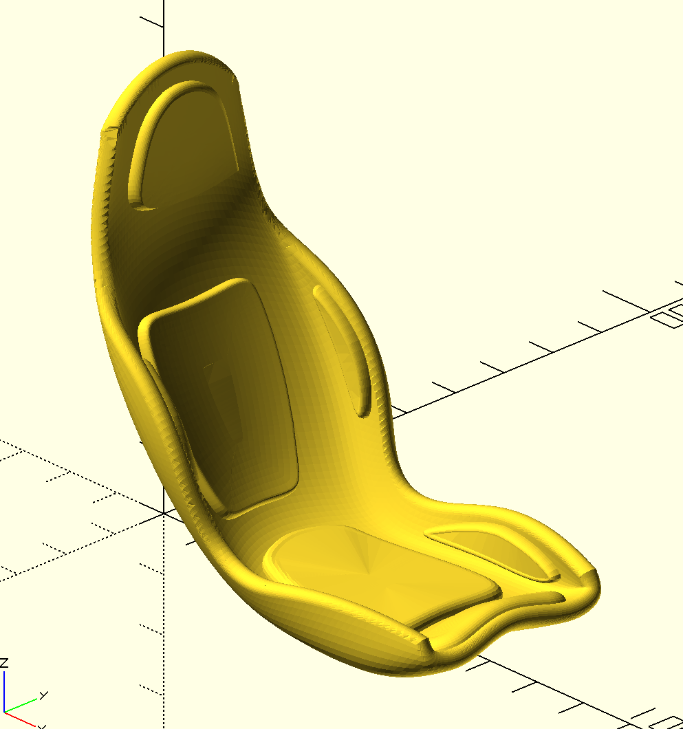

another improved attempt on designing a seat:
my point here is that python can improve the capability of openscad which
probably is extremely difficult with pure openscad language alone.
So it would make sense in investing some time to add python as another
language. Maybe there could be 2 separate versions
openscad file can be downloaded from here:
https://github.com/sprabhakar2006/openSCAD/blob/main/seat.scad
[image: Screenshot 2024-06-02 at 8.48.58 AM.png]

The OpenSCAD file is incomprehensible, to the point of being useless.
You are writing in Python, not in OpenSCAD. You are just using OpenSCAD
as  rendering engine.

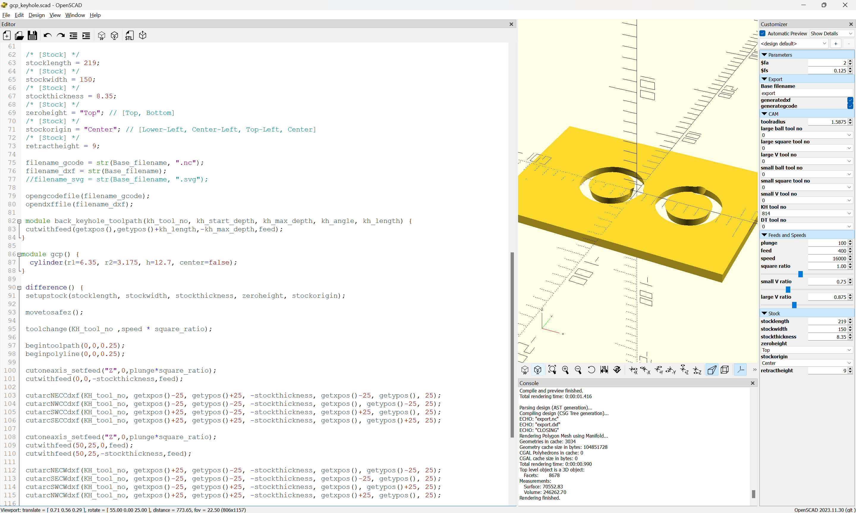

I've actually just finished adding support for arcs in my current project:
[image: Inline image]
(though I need to improve it to have Z-axis movement/cutting as well, and
yes, for some reason the arc generated come in as 25.1mm x 25mm curves
which don't meet up so as to make a circle, and they generate an error when
importing the DXF into some programs...)

Mon, Jun 3, 2024 1:28 AM
I am not good at explaining things. When I start explaining with diagrams,
it takes too long and I don't have that much time.
You can read the code in my github file openscad1.py and I can answer some
specific questions.
There are some 18 types of arc functions defined.
Key idea in these functions is to define the arcs in 2d which are not very
tough to define in openscad language as well and thereafter the same
functions can be used in 3d arcs. What you need is a method to transform 3d
points to 2d and then back to 3d at its original location.
Also there is no complex mathematics involved here

and I would be glad of reading recommendations, or example code which is
carefully and thoroughly explained.
https://designinto3d.com/
I am not good at explaining things. When I start explaining with diagrams, it takes too long and I don't have that much time. You can read the code in my github file openscad1.py and I can answer some specific questions. There are some 18 types of arc functions defined. Key idea in these functions is to define the arcs in 2d which are not very tough to define in openscad language as well and thereafter the same functions can be used in 3d arcs. What you need is a method to transform 3d points to 2d and then back to 3d at its original location. Also there is no complex mathematics involved here On Sun, 2 Jun 2024 at 21:47, William F. Adams via Discuss < discuss@lists.openscad.org> wrote: > On Sunday, June 2, 2024 at 07:26:06 AM EDT, Jon Bondy via Discuss < > discuss@lists.openscad.org> wrote: > > The OpenSCAD file is incomprehensible, to the point of being useless. You > are writing in Python, not in OpenSCAD. You are just using OpenSCAD as > rendering engine. > > Let's turn this around --- if there was an OpenSCAD module for > representing such a design what would the interface look like? > > I've asked before about representing curved surfaces in a fashion which > was elegant and expressible, and which folks who do not have an > understanding of higher maths could not merely grasp, but also write/use > --- while a couple of techniques have been put forward, I wasn't able to > wrap my mind around them, and I will readily admit to this being my > deficient education. > > I've actually just finished adding support for arcs in my current project: > > https://github.com/WillAdams/gcodepreview > > [image: Inline image] > > > (though I need to improve it to have Z-axis movement/cutting as well, and > yes, for some reason the arc generated come in as 25.1mm x 25mm curves > which don't meet up so as to make a circle, and they generate an error when > importing the DXF into some programs...) > > Once that is done, I eventually hope to start working on adding some sort > of support for curves in 3 dimensions, or representing a curved surface --- > what is a way to do this which is: > > - reasonably concise > - expressive and powerful > - suitable to be calculated out within OpenSCAD > > My current plan is to just do curves of tool movement in 3 dimensions --- > an overhead view of a Bézier curve for X and Y coordinates, and a > representation of a side view as a curve which shows Y and Z coordinates > --- to make a curved surface it would be necessary to arrange a sufficient > number of toolpaths so as to represent that tool movement when cutting out > that surface and ultimately this would need to be captured as G-code for > making that cut. > > At one point in time I had a number of links which I had researched: > > > - > https://en.wikibooks.org/wiki/OpenSCAD_User_Manual/Other_Language_Features#Surface > - Thingiverse: Bezier Heart in OpenScad > <https://www.thingiverse.com/thing:8483> > - https://www.thingiverse.com/thing:8931 > - > http://climberg.de/page/openscad-implementation-of-bezier-curves-of-any-degrees/ > https://climberg.de/post/openscad_bezier_curves > - https://github.com/JustinSDK/dotSCAD [19] > <http://forum.openscad.org/larger-number-of-control-points-for-Bezier-td22435.html> > https://openhome.cc/eGossip/OpenSCAD/BezierCurve.html > https://openhome.cc/eGossip/OpenSCAD/lib-bezier_surface.html > - http://forum.openscad.org/smooth-3-D-curves-tc7766.html > - https://github.com/RLuckom/bezier-scad > https://www.raphaelluckom.com/posts/bezier_curves.html > - http://forum.openscad.org/Rectangle-with-one-curved-edge-td21097.html > - http://kitwallace.tumblr.com/post/76273401911/loxodrome-in-openscad > - http://www.thingiverse.com/thing:1208001 [20] > <http://forum.openscad.org/Spline-interpolation-nSpline-td15207.html> > - https://www.blockscad3d.com/community/projects/68284 > > > > > and I would be glad of reading recommendations, or example code which is > carefully and thoroughly explained. > > William > > -- > https://designinto3d.com/ > Sphinx of black quartz, judge my vow. > > > > > _______________________________________________ > OpenSCAD mailing list > To unsubscribe send an email to discuss-leave@lists.openscad.org >

Jon, I think you're underestimating the severity of the concern here.  We
don't merely need an API to do this kind of design.  At least to me that
suggests that a design approach exists and you just need to write its
interface.  There is a perfectly satisfactory API to beziers in BOSL2, for
example.  In actual fact it seems like what's needed is a design philosophy
or strategy.  And indeed, if anybody has any ideas I'd be interested in
hearing them.  I've implemented various things in BOSL2 that do curves
using beziers, but none are particularly general.  I started with
round_corners to round the corners of a polygon, which can apply beziers to
the corners in 2d.  Later I wrote rounded_prism which does a sort of
analogous thing of rounding edges of an arbitrary prism in 3d by placing
beziers at the various corners.  I also implemented smooth_path which takes
a polygon and converts each edge to a bezier curve so that they meet
smoothly (C1) at the corners with a specified amount of bulge.    And I
implemented join_prism() which joins various kinds of prisms or prism to
sphere or plane with a fillet.  But none of this provides a general
framework for designing some arbitrarily curved 3d object.
One approach to that sort of design is to start with a polyhedron and then
smooth it.  There are ways to do this such as Catmull smoothing and other
more sophisticated ones.  They depend on how the starting shape is
triangulated and are hard to control, though.  In particular, what if you
only want to smooth part of a polyhedron?  About a year ago Martin
Herdieckerhoff posted an intriguing message about a library called Yari
that used some subdivision methods to design rounded shapes, but I don't
think I ever saw any details about how it worked, or a link to the actual
algorithm.

Adrian:
My use of the term API was a poor one.  I think William said it better.
We need a way of thinking about such complex shapes as procedures and
functions and data, as in a C .H file, and then find a way to implement
those functions in OpenSCAD, if that is even possible.  Up until now, I
thought the problem lay in OpenSCAD's quirky feature set (no variables,
minimal data structures), but now I can see that the problem is more in
finding a design approach that is practical.  It seems that Sanjeev has
conceived of how to create such complex shapes.  Perhaps we can learn
from what he has done, and explore how and whether these functions can
be implemented in OpenSCAD directly.

Well, a C language .h file basically describes an API.  Here's an example
of a solution that does a lot of interesting things.  I can't find it at
the moment, but it has the ability to make joints with different levels of
continuity, so G0 or G2, but the interface is all about pointing and
clicking.  https://www.xnurbs.com/

Just FYI, the manifold backend has subdivision for smoothing shapes.
Here are some recent PRs that may be of interest:
https://github.com/elalish/manifold/pull/793
https://github.com/elalish/manifold/pull/821
It doesn't seem too hard to expose the API to openscad, but not sure if
people are happy with having this manifold specific feature. Perhaps we
should try to find more people to try this.

 here.  We don't merely need an API to do this kind of design.  At
 least to me that suggests that a design approach exists and you
 just need to write its interface.  There is a perfectly
 satisfactory API to beziers in BOSL2, for example.  In actual
 fact it seems like what's needed is a design philosophy or
 in hearing them.  I've implemented various things in BOSL2 that
 do curves using beziers, but none are particularly general.  I
 started with round_corners to round the corners of a polygon,
 which can apply beziers to the corners in 2d.  Later I wrote
 rounded_prism which does a sort of analogous thing of rounding
 edges of an arbitrary prism in 3d by placing beziers at the
 various corners.  I also implemented smooth_path which takes a
 meet smoothly (C1) at the corners with a specified amount of
 bulge.    And I implemented join_prism() which joins various
 kinds of prisms or prism to sphere or plane with a fillet.  But
 none of this provides a general framework for designing some
 and then smooth it.  There are ways to do this such as Catmull
 smoothing and other more sophisticated ones.  They depend on how
 the starting shape is triangulated and are hard to control,
 though.  In particular, what if you only want to smooth part of a
 polyhedron?  About a year ago Martin Herdieckerhoff posted an
 intriguing message about a library called Yari that used some
 subdivision methods to design rounded shapes, but I don't think I
 algorithm.
