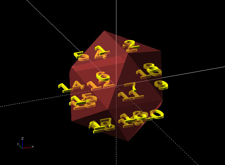

I'm trying to make a customizable d20. I made the icosahedron no problem,
and have the vectors for both the vertices, and the faces. I have made the
numbers of the faces coincident with the faces, but can't figure out how to
rotate them so that they are coplanar with the faces.  Searching
mathematics stack exchange was fruitless, as well as my search of wikipedia
and mathworld. I also can't seem to straight apply spherical
coordinate transformation (but I was always bad at that, even in college)
size=25;
letter_ratio=.3;
golden_ratio=(1+sqrt(5))/2;
g=golden_ratio;
//See:
https://en.wikipedia.org/wiki/Regular_icosahedron#Cartesian_coordinates
rect1=[[0,+1,+g],[0,+1,-g],[0,-1,+g],[0,-1,-g]];
rect2=[[+1,+g,0],[+1,-g,0],[-1,+g,0],[-1,-g,0]];
rect3=[[+g,0,+1],[+g,0,-1],[-g,0,+1],[-g,0,-1]];
points=concat(rect1, rect2, rect3); //echo(points);
faces=[[0,10,2],[0,2,8],[0,8,4],[0,4,6],[0,6,10],
[10,2,7],[2,7,5],[2,5,8],[8,5,9],[8,9,4],[4,9,1],[6,4,1],[6,1,11],[6,11,10],[10,11,7],
[3,5,7],[3,7,11],[3,11,1],[3,1,9],[3,9,5]];
#polyhedron(.5sizepoints,faces);
for(i=[0:19])
translate(.5sizeavg(i)) color("yellow")
//rotate([1*acos(avg(i)[2]/size),0,0])
//rotate([0,0,90-atan2(avg(i)[2],avg(i)[0])])
text(str(i+1),size=size*letter_ratio,valign="center",halign="center");
function avg(x)
//calculates the vector of the center of the face x, based on the average
of the vertices
=points[faces[x][0]]/3
+points[faces[x][1]]/3
+points[faces[x][2]]/3;

The numbers start out with their normal vector pointing in the +z direction.  We need to rotate it so the normal is the avg(x) vector.  One way to do this is to tilt the letters away from the z-axis the right amount for the face by rotating around the y-axis by the z direction angle which is acos(z/norm) where norm is the length of the vector to the center of the face and z is the z-component of that vector.  Then rotate the result around the z-axis by the angle of the projection into the xy-plane from the x-axis.  Here, we have to compensate for the acos only returning results in the first 2 quadrants but looking at the y-component of the vector to the face.  Remembering that mathematical operations start at the inside and work outwards that gives the following for setting the texts.
for(i=[0:19])
rotate([0,0,sign(avg(i)[1])acos(avg(i)[0]/sqrt((avg(i)[0])^2+(avg(i)[1])^2))])
rotate([0,acos(avg(i)[2]/norm(avg(i))),0])
letter_ratio,valign="center",halign="center”);
This looks good except for 1 and 18.  1 looks like it’s tilted to match 2 and 18 looks like it’s tilted like 19.  So what have I forgotten?  These are both “special” because the y-component is zero and the x-component is negative.  The acos gives 0 <= theta <180.  I’ll fix this inelegantly with an if statement rather than thinking harder about rotations.
for(i=[0:19])
if(avg(i)[1]==0 && avg(i)[0]<0){
rotate([0,-acos(avg(i)[2]/norm(avg(i))),0])
else{
Note that the text is 2D so won’t render.  Worse, if I extrude the text and union it with the polyhedron, the mesh isn’t closed and it still won’t render.  Maybe that has to be built of equilateral triangles moved into position the way the text is, but then we have to figure out how each triangle has to be rotated first.
Lenore

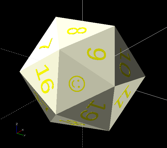

There is a simple solution using BOSL2:
include <BOSL2/polyhedra.scad>
  regular_polyhedron("icosahedron", side=35);
  regular_polyhedron("icosahedron", side=35,draw=false)
    down(.3) linear_extrude(height=1)
      text(str($faceindex+1),halign="center",valign="center");

There were 3 key parts. First like Lenore said, the arccosine has to be in
the y dimension, and has to be normalized by norm(avg(i)). The 2nd part was
that I had the wrong dimensions for the arctangent, which have to be
relative to y and x (not z and x). And the 3rd part is that both have to be
in the same rotation. So the rotation command is :
rotate([0,acos(avg(i)[2]/norm(avg(i))),atan2(avg(i)[1],avg(i)[0])])
JJVB's suggestion was correct, and I could remove the hull() that I had to
put in to make it manifold.

One Issue is, your icosahedron is inside out.
If you remove the  # and switch to combined view [F12], you see a lot
pink faces. These should be yellow.
Change faces to
faces=[
    [10,0,2],[0,8,2],[0,4,8],[0,6,4],[0,10,6],
    [10,2,7],[2,5,7],[2,8,5],[8,9,5],[8,4,9],
    [4,1,9],[6,1,4],[6,11,1],[6,10,11],[10,7,11],
    [3,7,5],[3,11,7],[3,1,11],[3,9,1],[3,5,9]];
and then your icosahedron is valid.

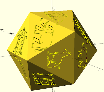

  2. On a Mac, I changed the sides array to:
sides=["𓄿","𓅔","𓅢","𓃌","𓃍","𓃎","𓆉", "𓃰", "𓃠", "𓃟", "𓁶", "𓂖",
"𓂀", "𓁿", "𓁰", "𓁀", "𓁥", "𓁔", "𓁁", "𓀨"];
and text line to:
   text(str(sides[i]), size=size*letter_ratio, font="Noto Sans Egyptian
Hieroglyphs", valign="center",halign="center");
to produce:
[image: Screen Shot 2021-12-30 at 9.02.06 AM.png]
and text line to:
Egyptian Hieroglyphs", valign="center",halign="center");
to produce:

for(i=[0:19])
translate(.5
size*avg(i)) color("yellow")
translate([0,0,-depth_ratiosize+.05])
linear_extrude(depth_ratio
size)
text(str(sides[i]),size=size*letter_ratio,valign="center",halign="center");
function avg(x)
of the vertices
