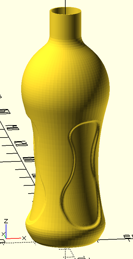

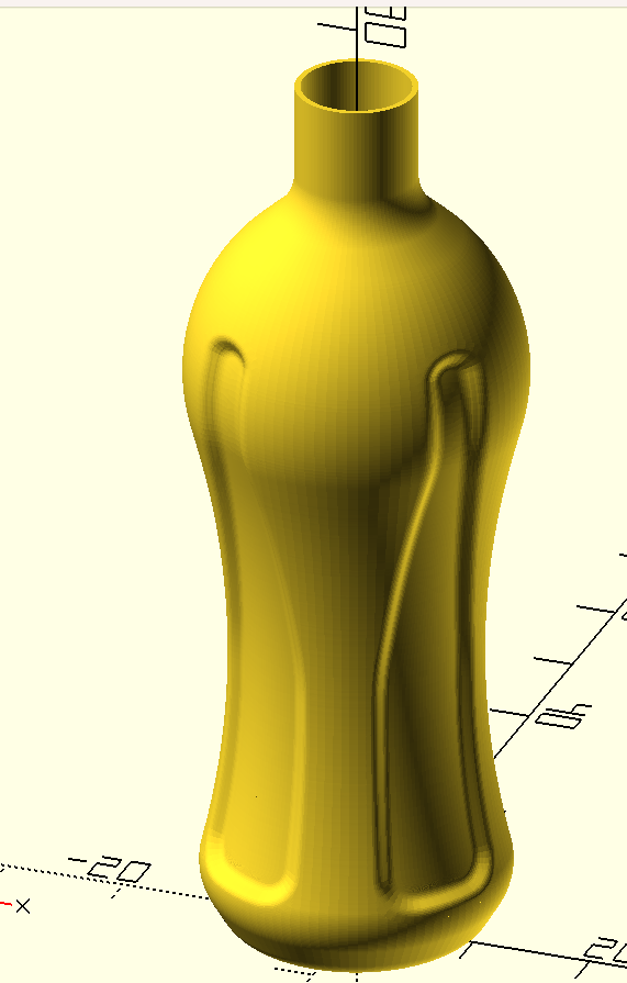

Very tough to design in pure openscad
link to download:
https://github.com/sprabhakar2006/openSCAD/blob/main/bottle%20with%20cut%20design.scad
[image: Screenshot 2023-09-19 at 5.56.51 AM.png]
[image: Screenshot 2023-09-19 at 6.00.32 AM.png]

Hi Adrian,
Thanks for sharing, but this is quite different.
I will explain the process I followed once I get some free time.
I am sure this would be useful to many here

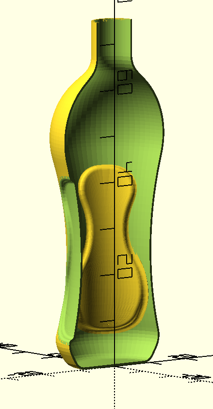

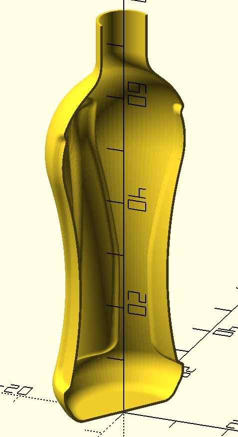

here is another version:
https://github.com/sprabhakar2006/openSCAD/blob/main/bottle%20with%20cut%20design_1.scad
[image: Screenshot 2023-09-20 at 7.26.34 AM.png]
[image: Screenshot 2023-09-20 at 7.25.11 AM.png]

here is the explanation on how to create such design
