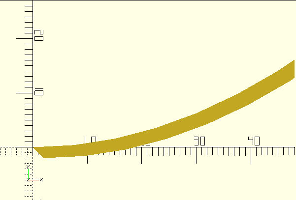

Hello OpenSCAD,
I have some points from a parabola that I want to turn into a reflector.  The points are generated from an external program.  Maybe I should be using something in OpenScad to generate them?  I have not explored that yet.
Anyway, I want to generate a 2nd set of points where the X coordinate is a thickness away from the first list so I can have a polygon that I can extrude.
I am aware that what I wrote doesn't work and I understand why it doesn't work, but I have no idea how to make something that will give a list of points.
Thank you for your help.

Try this:
List2 = [for(a =[len(List)-1:-1:0]) let( b = List[a][0]+Thick) [b,
List[a][1]] ];
You can't modify OpenSCAD variables but list comprehensions allow lists to
be made with for loops. And it would be easy to make a parabolic list in
the same way.

A little simpler:
offset = [Thick, 0];
List2 = [ for (b = List) b+offset ];
Note that when you do this you need to reverse one of the lists to get
the polygon to wind properly.
function reverse(a) = [ for (i = [len(a)-1:-1:0]) a[i] ];
Putting it all together:
L1 = [[  0.00,  0.00],[  7.50,  0.39],[  15.00,  1.56],[  22.50,  3.52],[  30.00,  6.25],[  37.50,  9.77],[  45.00, 14.06],[  52.50, 19.14],[  60.00, 25.00],[  67.50, 31.64]];
L3 = [[  75.00, 39.06],[  82.50, 47.27],[  90.00, 56.25],[  97.50, 66.02],[ 105.00, 76.56],[ 112.50, 87.89],[ 120.00,100.00]];
Thick = 2;
function offset(a, off) = [ for (b = List) b+off ];
List = concat(L1,L3);
List2 = reverse(offset(List, [Thick, 0]));
polygon(concat(List, List2));
On 11/19/2022 10:51 PM, nop head wrote: > Try this: > > List2 = [for(a =[len(List)-1:-1:0]) let( b = List[a][0]+Thick) [b, > List[a][1]] ]; Code golf! A little simpler: offset = [Thick, 0]; List2 = [ for (b = List) b+offset ]; Note that when you do this you need to reverse one of the lists to get the polygon to wind properly. function reverse(a) = [ for (i = [len(a)-1:-1:0]) a[i] ]; --- Putting it all together: L1 = [[ 0.00, 0.00],[ 7.50, 0.39],[ 15.00, 1.56],[ 22.50, 3.52],[ 30.00, 6.25],[ 37.50, 9.77],[ 45.00, 14.06],[ 52.50, 19.14],[ 60.00, 25.00],[ 67.50, 31.64]]; L3 = [[ 75.00, 39.06],[ 82.50, 47.27],[ 90.00, 56.25],[ 97.50, 66.02],[ 105.00, 76.56],[ 112.50, 87.89],[ 120.00,100.00]]; Thick = 2; function reverse(a) = [ for (i = [len(a)-1:-1:0]) a[i] ]; function offset(a, off) = [ for (b = List) b+off ]; List = concat(L1,L3); List2 = reverse(offset(List, [Thick, 0])); polygon(concat(List, List2));
Sun, Nov 20, 2022 7:11 AM
Also note that offsetting in X alone doesn't really do what you want,
because at the start of the curve it's close to Y=0 and the result is
thin; it's only when the curve goes vertical that you get a thickness of 2.
Better might be to offset it by [2,-2]:
 but that isn't exactly right either:
Getting it truly right is, I believe, a bit of an adventure.

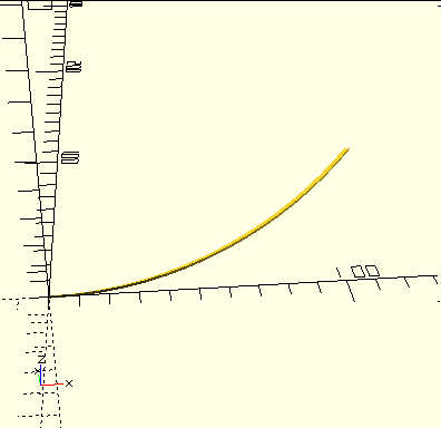

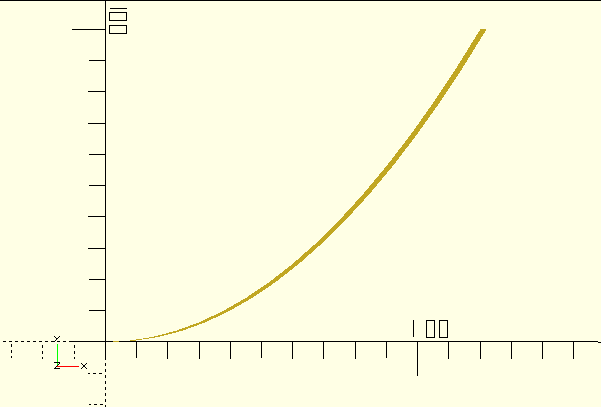

Perhaps make the thickness very small and then use offset() to give it
proper thickness. That way the width variation with gradient would be very
small.

Hi Jordan,
I knew the bottom point would be off and was planning on adding a [0,-Thick] at the bottom to take care of that.
THANK YOU all for the suggestions.  I learned a lot from this adventure.  The reflector is for low grade audio recording so I don't need super accuracy.
Bob

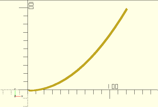

Sun, Nov 20, 2022 9:20 AM
Hi Bob,
Looks good in OPenSCAD but you can't see cross section until you slice it.  It was tough to get one layer at the top when printed upside down.
Will try offset.  Thanks again.
