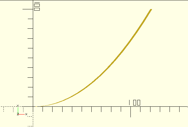

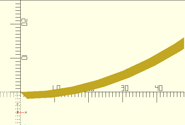

Also note that offsetting in X alone doesn't really do what you want,
because at the start of the curve it's close to Y=0 and the result is thin;
it's only when the curve goes vertical that you get a thickness of 2.
Better might be to offset it by [2,-2]:
but that isn't exactly right either:
Getting it truly right is, I believe, a bit of an adventure.

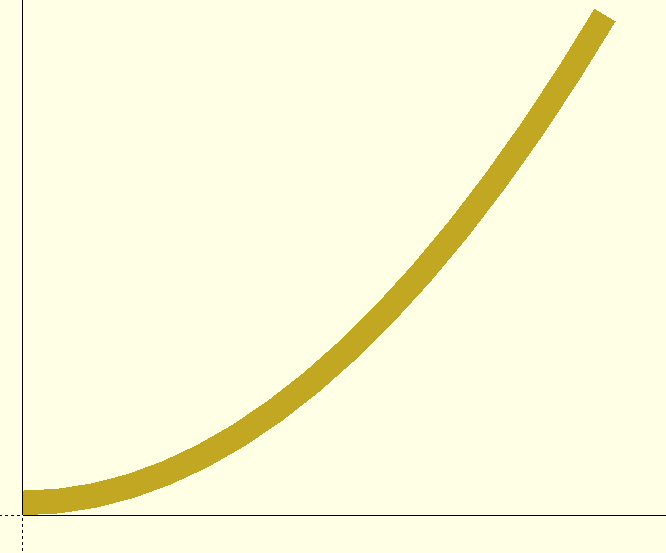

In BOSL2, just use stroke(). It’ll take care of the offset for you:
thick=5;
up(thick/2)
rotate_extrude()
stroke([for (x=[0:7.5:220]) [x,x*x/144]], width=thick);
-Revar

<image.png>

Also note that offsetting in X alone doesn't really do what you want, because at the start of the curve it's close to Y=0 and the result is thin; it's only when the curve goes vertical that you get a thickness of 2.
<8by0b6ENZA81gvzT.png>
<ZMAuUyvslozDulY8.png>
<KpgA2FSz800FPvQ3.png>
