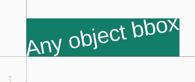

Fri, Mar 27, 2020 5:08 PM
I think there is a difference in the meaning of "wrap". The OP wants the
text wrapped inside a fixed size box. I.e. line breaks inserted where it
meets the edges. Carsten is meaning wrap a box around some text. i.e.
making it big enough to enclose the text.
Thie computation of the bounding box for the former case can be done by
user's space code. See attached file.
There is an alternative bbox_3D in tips&tricks (https://en.m.wikibooks.org/
wiki/OpenSCAD_User_Manual/Tips_and_Tricks). If a margin is needed we can
use offset() operator.
[image: bbox_2D_example.PNG]
