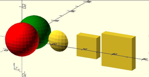

Unfortunately, I don't have any way to see what happens inside the "&"
operator.
In the example you give, the bounding box of the intersection happens to
be equal to the intersection of the bounding boxes.  That is, indeed,
easy.  Other cases can't be done that way.
I'm not a 3D geometry expert, but in non-trivial cases I'm not coming up
with any way to calculate the bounding box of an intersection without
actually calculating the intersection.
If that's what you're doing under the covers, here's a counterexample.
This is long for an example; most of it is presenting the various parts
of the question.
// The two objects that we're going to play with.
module a() {
sphere(10);
module b() {
translate([0,15,0]) sphere(10);
// Show the two objects.
color("red") a();
color("green") b();
// Their intersection.
translate([20,0,0]) intersection() {
a();
b();
// The bounding box of their intersection.
translate([40,0,0]) bbox_3D() intersection() {
a();
b();
// The intersection of their bounding boxes.
translate([60,0,0]) intersection() {
bbox_3D() {
a();
bbox_3D() {
b();
// Derive the bounding box of an arbitrary object.
// Courtesy Ronaldo Persiano.
module bbox_3D()
render()
a = 1e10;
hull() { // XY
translate([ a, a, 0]) children();
translate([ a,-a, 0]) children();
translate([-a, a, 0]) children();
translate([-a,-a, 0]) children();
hull() { // XZ
translate([ a, 0, a]) children();
translate([ a, 0,-a]) children();
translate([-a, 0, a]) children();
translate([-a, 0,-a]) children();
hull() { // YZ
translate([0, a, a]) children();
translate([0,-a, a]) children();
translate([0, a,-a]) children();
translate([0,-a,-a]) children();

You are correct, I agree with your counterexample. I was computing the
intersection between bounding boxes, and your example shows it is not
sufficient in all cases.
Thanks!
