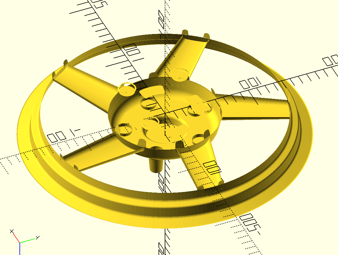

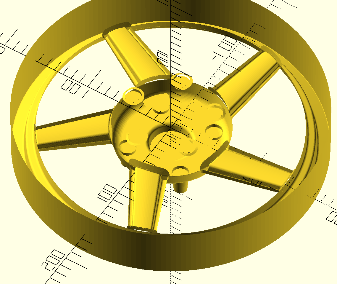

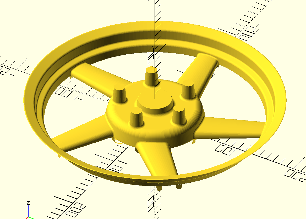

I have a requirement to develop a casting mould for a part e.g.
wheel.
All the surfaces which are visible from top needs to be extracted
to get one half of the mould.
Similarly surfaces which are visible from bottom needs to be
extracted to develop other side of the mould.
Parting lines can be zigzag depending on the part geometry.
Any ideas to do such a thing in openscad will be really helpful
Regards
Sanjeev

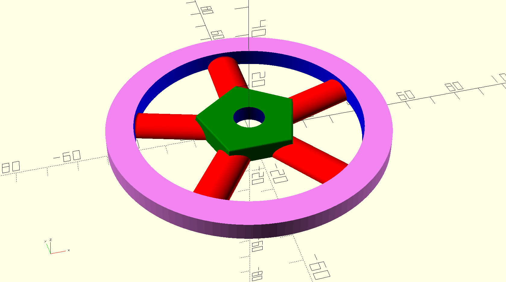

Not sure if this is what you want Sanjeev, it's pretty simplistic code-
I wrote it to create patterns for casting flywheels for small stationary
engines. It has draft so you can get it out of the sand, and you can set
oval or round spokes, any (reasonable) number of spokes, plus either a
circular hub or one with sides equal to the number of spokes. I just use
difference to get the half, and there are two holes in the flat back for
registration pins.

//This cube differences out half the wheel
//to make a mold for casting
translate ([0, 0, -10])
cube ([wheeldiameter+10, wheeldiameter+10, 20],center = true);

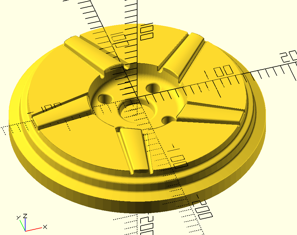

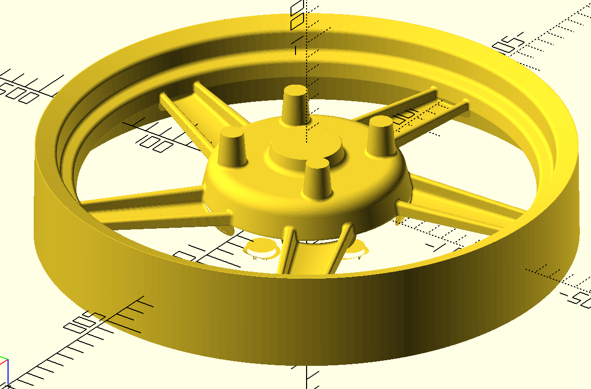

Fri, Feb 24, 2023 10:50 PM
Hi Ken
my model is a little complicated and difference will not work, I have tried
it
[image: wheel.png]
Hi Ken my model is a little complicated and difference will not work, I have tried it [image: wheel.png] > _______________________________________________ > OpenSCAD mailing list > To unsubscribe send an email to discuss-leave@lists.openscad.org >

Hi Ken
tried it

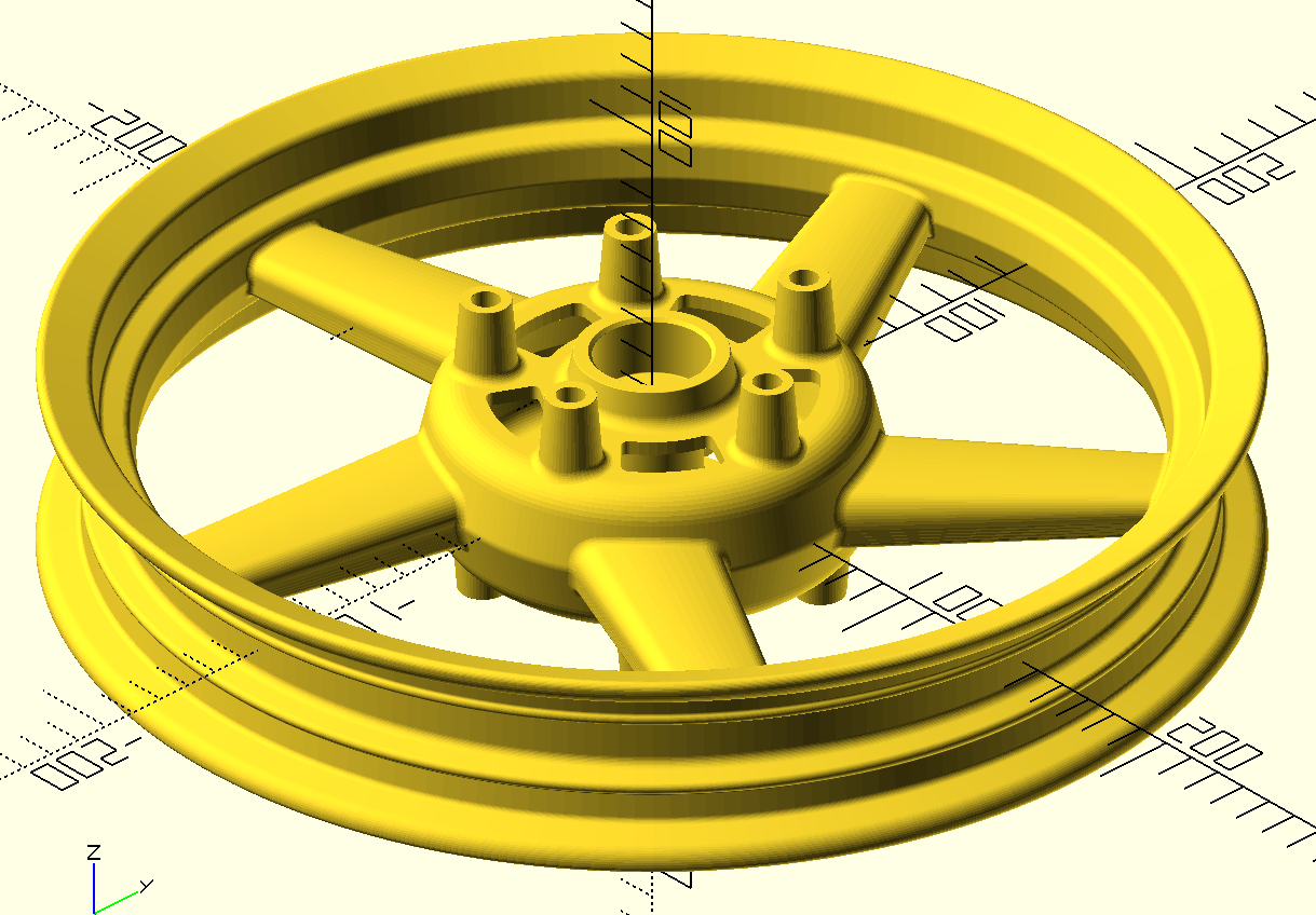

tried it
[image: wheel.png]

Sun, Feb 26, 2023 1:18 AM
results of the top and bottom surface extraction
there is some more work that needs to be done, to remove some unnecessary
things but i think it's quite workable now.
[image: Screenshot 2023-02-26 at 6.26.52 AM.png]
[image: Screenshot 2023-02-26 at 6.28.00 AM.png]
[image: Screenshot 2023-02-26 at 6.44.18 AM.png]
[image: Screenshot 2023-02-26 at 6.45.00 AM.png]

results of the top and bottom surface extraction there is some more work that needs to be done, to remove some unnecessary things but i think it's quite workable now. [image: Screenshot 2023-02-26 at 6.26.52 AM.png] [image: Screenshot 2023-02-26 at 6.28.00 AM.png] [image: Screenshot 2023-02-26 at 6.44.18 AM.png] [image: Screenshot 2023-02-26 at 6.45.00 AM.png] On Sat, 25 Feb 2023 at 12:50, Sanjeev Prabhakar <sprabhakar2006@gmail.com> wrote: > I think I have found a generic solution which doesn't need any difference > or intersection. > > This will also show in case there are any undercuts. > > It was simpler than I anticipated. > > Will share it once I get some time > > Thanks everyone > > On Sat, 25 Feb, 2023, 12:35 pm Ken, <bats059@gmail.com> wrote: > >> Ah yes, I see. >> Looking at it, that would be a rather tricky moulding job, >> at least 4 parts that I can see, and rather tricky to assemble. >> >> Sooner you than me Sanjeev! >> >> On 2023-02-25 09:50, Sanjeev Prabhakar wrote: >> >> Hi Ken >> my model is a little complicated and difference will not work, I have >> tried it >> [image: wheel.png] >> >> >>> _______________________________________________ >>> OpenSCAD mailing list >>> To unsubscribe send an email to discuss-leave@lists.openscad.org >>> >> >> _______________________________________________ >> OpenSCAD mailing list >> To unsubscribe send an email to discuss-leave@lists.openscad.org >> >> >> -- >> Cheers, Kenbats059@gmail.comhttps://vk7krj.com/running.htmlhttps://sstv.vk7krj.com/all_bands.html >> ---------------------------------------- >> A baby can be defined as an ego with a noise at one end and a smell at the other. >> Your job as parents is to teach them to control all three. >> My job as a retiree is to tell you how you are doing it all wrong! >> >> _______________________________________________ >> OpenSCAD mailing list >> To unsubscribe send an email to discuss-leave@lists.openscad.org >> >
Thu, Mar 2, 2023 5:43 PM
bottom mould completely done in openscad.
[image: Screenshot 2023-03-02 at 11.10.21 PM.png]
bottom mould completely done in openscad. [image: Screenshot 2023-03-02 at 11.10.21 PM.png]
GS
Guenther Sohler
Fri, Mar 3, 2023 10:05 AM
it looks very nice!
Whats your workflow like?
apparently you cannot pour molten metal onto the plastic
On Thu, Mar 2, 2023 at 6:45 PM Sanjeev Prabhakar sprabhakar2006@gmail.com
it looks very nice! Whats your workflow like? apparently you cannot pour molten metal onto the plastic On Thu, Mar 2, 2023 at 6:45 PM Sanjeev Prabhakar <sprabhakar2006@gmail.com> wrote: > bottom mould completely done in openscad. > > [image: Screenshot 2023-03-02 at 11.10.21 PM.png] > > _______________________________________________ > OpenSCAD mailing list > To unsubscribe send an email to discuss-leave@lists.openscad.org >
Fri, Mar 3, 2023 12:06 PM
Guenther
I am not planning to do anything with this.
I was just checking if dies can be modelled with this approach.
In the process I found it is very complex right now to do something like
this. But lot of learning from this challenging work.

SS
Steve Schlaifer
Sat, Mar 4, 2023 7:23 PM
You could use this as the start of a lost wax process.
