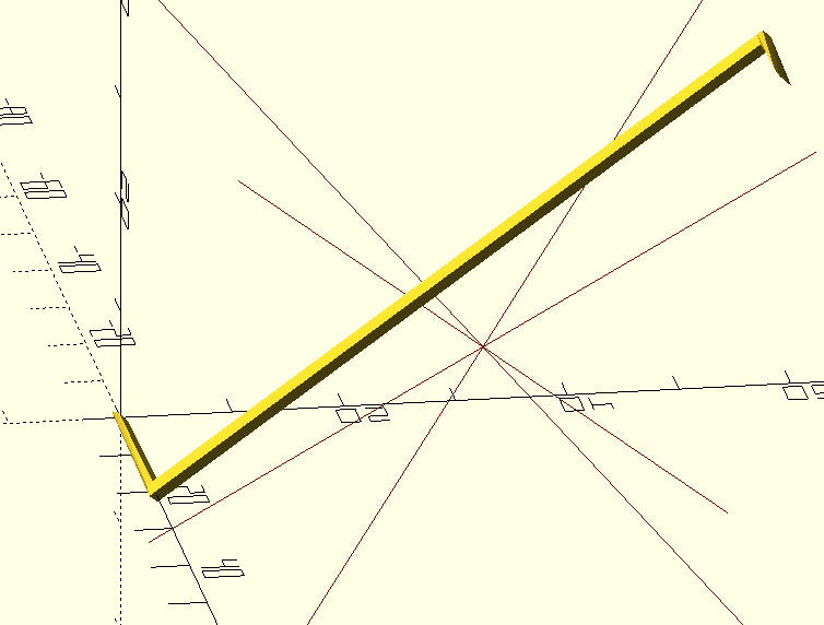

In fact, "jump" does leave a turtle trail, so it does not do what I want:
include <BOSL2/turtle3d.scad>
naPath = turtle3d([
"move", 20,
"jump", [50, 50, 50],
"move", 10
path_sweep(circle(r = 1, $fn = 6), naPath);

Ah, right. I think you need to start a new turtle at the desired spot.
Since turtle returns a path there's no way to skip a segment.

Mon, Jun 23, 2025 11:13 PM
I think it depends on what you're doing. If you're just getting a path
then you can move() the path you get. But if you're getting a transform
list then you would need to move everything in the transform list, which is
somewhat more trouble. If you pass the transform list to sweep() you could
move() the result of sweep. I wonder if turtle3d needs a special option
for this.
naPath = turtle3d([
"move", 20,
"move", 10

I have a list of 3D points I'm trying to hit, so starting at one of the points would be optimal, rather than adding the offsets after the fact.
Not sure if anyone else would find this feature to be useful.
want:
naPath = turtle3d([
"move", 20,
"move", 10

For furtle in 2D there is really no reason not to simply wrap your turtle
command in move(). There's no reason for me to implement a new option that
just calls move for you. Basically you're asking for
`move(pt,turtle(....))` to be augmented with an identically acting
`turtle(....., move=pt)`. You can of course in either turtle, specify a
starting state, though whether that counts as "easy" is debatable.
I took a closer look at turtle3d(), and it turns out that the "state"
parameter can accept a transformation matrix as an argument. So actually
the desired feature already exists---it just wasn't documented. In other
words, you can do turtle3d(....., state=move(pt)) to start the turtle at
pt. I did notice that if I give a transformation matrix with a rotation I
sometimes get the reverse of the expected effect. I'm not sure what is
going on there.
