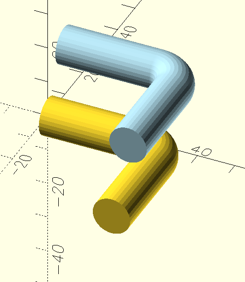

Tue, Jun 24, 2025 9:04 PM
I didn't see that Jon posted an example and am not sure what the point of
confusion is.
include<BOSL2-fork/std.scad>
include<BOSL2-fork/turtle3d.scad>
path = [ "move", 25, "arcright", 7,  "move", 25];
start_pt=move([3,3,20]);
sweep(circle(r=5, $fn=32), turtle3d(path, transforms=true));
color("lightblue")
sweep(circle(r=5, $fn=32), turtle3d(path, state=start_pt,
transforms=true));

Tue, Jun 24, 2025 9:20 PM
As I conceive of it, the "path" is a list of moves, so having another
move that is not within "path" is counter-intuitive. I would have
expected something like "start", start_pt, "move"... within the "path"
specification.
And if there were a parameter to specify the starting point of a path, I
would not call it "state": I would call it "init_pos" or "start".
Just me.

Tue, Jun 24, 2025 10:02 PM
How do you imagine that stroke() or path_sweep() or sweep() can take a path
or transform list and somehow skip a section in the middle?
How would a path produced by turtle or a sequence of
transformations produced by turtle3d() indicate that something was
skipped?
My point is that the thing you are asking for is impossible on the output
side.  Basically the only way to do it would be to have
turtle3d recursively call itself multiple times and return a list of lists
of paths/transforms.  Then you'd have to deal with this complication all
the time for the normal use without skips.  And any time you wanted to use
it e.g. with sweep() you'd still have to run a loop over the list.  So
nothing has been gained.
The reason it's called "state" is because you're setting the turtle's
initial state, which you are permitted to do in a simplified fashion by
just giving a transformation or direction instead of having to give the
full state.  You can give the full state if you want---the starting
transform, initial direction and spin, move distance and default angle.  I
think the theory was that you'd get a full state state like that from a
previous turtle call and then continue from there, though I don't know how
useful that is.
confusion is.
color("lightblue")
transforms=true));

This makes me think about what could be the best way to create a path from a user perspective. something like [0,0]x10y10ay45,sqrt(50)a-x45,sqrt(50) maybe easier for users to understand and write In the above example it means start at origin [0,0] x10 means move 10mm in "x" direction y10 means move 10 mm in "y" direction ay45,sqrt(50) means angle from positive 'y' axis of 45 deg with length of square root 50 and so on Similar arrangement could be thought for 3d path as well On Wed, 25 Jun 2025 at 03:33, Adrian Mariano via Discuss < discuss@lists.openscad.org> wrote: > How do you imagine that stroke() or path_sweep() or sweep() can take a > path or transform list and somehow skip a section in the middle? > > How would a path produced by turtle or a sequence of > transformations produced by turtle3d() indicate that something was > skipped? > > My point is that the thing you are asking for is impossible on the > *output* side. Basically the only way to do it would be to have > turtle3d recursively call itself multiple times and return a list of lists > of paths/transforms. Then you'd have to deal with this complication all > the time for the normal use without skips. And any time you wanted to use > it e.g. with sweep() you'd still have to run a loop over the list. So > nothing has been gained. > > The reason it's called "state" is because you're setting the turtle's > initial state, which you are permitted to do in a simplified fashion by > just giving a transformation or direction instead of having to give the > full state. You can give the full state if you want---the starting > transform, initial direction and spin, move distance and default angle. I > think the theory was that you'd get a full state state like that from a > previous turtle call and then continue from there, though I don't know how > useful that is. > > On Tue, Jun 24, 2025 at 5:20 PM Jon Bondy <jon@jonbondy.com> wrote: > >> As I conceive of it, the "path" is a list of moves, so having another >> move that is not within "path" is counter-intuitive. I would have expected >> something like "start", start_pt, "move"... within the "path" specification. >> >> And if there were a parameter to specify the starting point of a path, I >> would not call it "state": I would call it "init_pos" or "start". >> >> Just me. >> >> Jon >> >> >> On 6/24/2025 5:04 PM, Adrian Mariano via Discuss wrote: >> >> I didn't see that Jon posted an example and am not sure what the point of >> confusion is. >> >> include<BOSL2-fork/std.scad> >> include<BOSL2-fork/turtle3d.scad> >> path = [ "move", 25, "arcright", 7, "move", 25]; >> start_pt=move([3,3,20]); >> sweep(circle(r=5, $fn=32), turtle3d(path, transforms=true)); >> color("lightblue") >> sweep(circle(r=5, $fn=32), turtle3d(path, state=start_pt, >> transforms=true)); >> >> [image: image.png] >> >> >> On Tue, Jun 24, 2025 at 4:00 PM Jon Bondy via Discuss < >> discuss@lists.openscad.org> wrote: >> >>> Thanks, but that is not intuitive at all! >>> >>> Jon >>> >>> On 6/24/2025 3:50 PM, larry via Discuss wrote: >>> > include <BOSL2/std.scad> >>> > include <BOSL2/turtle3d.scad> >>> > >>> > naPath = turtle3d([ >>> > "move", 20, >>> > "jump", [50, 50, 50], >>> > "move", 10, >>> > ], >>> > state=move([5,10,15])); >>> > path_sweep(circle(r = 5, $fn = 180), naPath); >>> >>> -- >>> This email has been checked for viruses by AVG antivirus software. >>> www.avg.com >>> _______________________________________________ >>> OpenSCAD mailing list >>> To unsubscribe send an email to discuss-leave@lists.openscad.org >>> >> >> _______________________________________________ >> OpenSCAD mailing list >> To unsubscribe send an email to discuss-leave@lists.openscad.org >> >> >> >> <http://www.avg.com/email-signature?utm_medium=email&utm_source=link&utm_campaign=sig-email&utm_content=emailclient> >> Virus-free.www.avg.com >> <http://www.avg.com/email-signature?utm_medium=email&utm_source=link&utm_campaign=sig-email&utm_content=emailclient> >> <#m_3904504837394086555_m_-3146537591323994909_DAB4FAD8-2DD7-40BB-A1B8-4E2AA1F9FDF2> >> > _______________________________________________ > OpenSCAD mailing list > To unsubscribe send an email to discuss-leave@lists.openscad.org >
Wed, Jun 25, 2025 3:19 AM
Looking at it now, I think it's at least somewhat intuitive.
From now on I will think of it this way...
Define a path using turtle movement 'commands'.
Then set one or more of starting position, direction, spin, etc.
Then sweep the path with 2D geometry..
