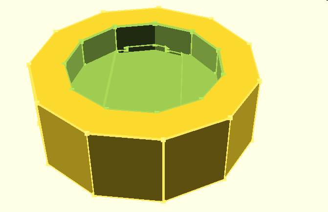

I'm wondering if you keep eps more chunky, say 0.001 you will have a
higher probability of staying away from the grid trip points
I don't have a problem if I use 1/128 as it is much courser than the grid.
I use 1/128 because it is exact in floating point and is a suitable value
to stop Z fighting in OpenCSG when viewed from a typical distance.
Where it goes wrong is when points nearly line up but don't because of
slight floating point inaccuracies. In my example I am rotating a 11 sided
polygon that is rotated 45 degrees one way and then another and stacked on
itself. All the vertices theoretically line up but in practice they are
very slightly off. The grid snaps them together which breaks the topology.
To fix it I make the second polygon smaller by eps so the points remain
distinct and it works but then I have a slightly wonky model. It is too
small to notice when 3D printed but it can be seen with show edges.
It would be better if the vertices where snapped together but it would need
to be done after the rotate but before the union. If it is done after the
union then the broken topology needs fixing up. In this case removing a
ring of degenerate triangles. In other cases it seems to be self
intersections as well and whatever this means  Expr: e_below !=
SHalfedge_handle()" a hole perhaps?

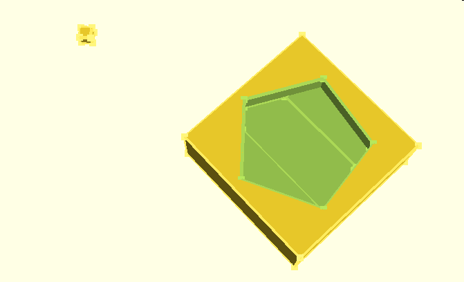

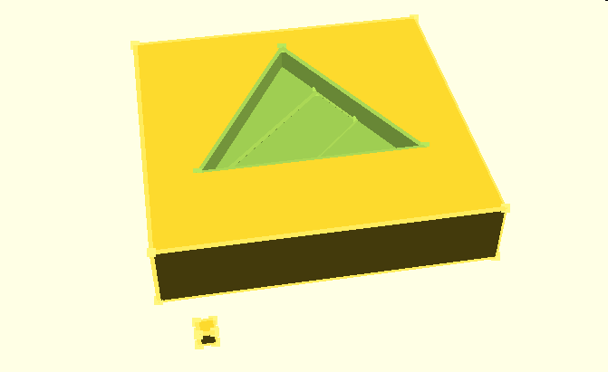

I added some debug to Polyset and simplified my model to be a stacked
pentagon subtracted from a cube to reduce the complexity of the polygons.
It now looks like this:
It looks like during F6 the union is never converted to a Polyset, so there
are no near vertices to collapse. F5 converts the union to a Polyset before
feeding it to CGAL and that is were it goes wrong as there are close
vertices in the same Polyset and they do collapse. Here is the Polyset
before, during and after being quantized.

I added some debug to Polyset and simplified my model to be a stacked pentagon subtracted from a cube to reduce the complexity of the polygons. It now looks like this: [image: image.png] It looks like during F6 the union is never converted to a Polyset, so there are no near vertices to collapse. F5 converts the union to a Polyset before feeding it to CGAL and that is were it goes wrong as there are close vertices in the same Polyset and they do collapse. Here is the Polyset before, during and after being quantized. polyset: PolySet: num polygons: 44 polygon 0: ( -5 -3.63271 2) (-1.29953 -4.83507 2.25) ( -5 -3.63271 2.25) polygon 1: (-1.29953 -4.83507 2.25) ( -5 -3.63271 2) (-1.29953 -4.83507 2) polygon 2: (2.09182 5.62736 2.25) (4.83195 1.8559 2) (2.09182 5.62736 1.75) polygon 3: (5.06738 1.53185 2.25) (4.83195 1.8559 2) (2.09182 5.62736 2.25) polygon 4: (4.83195 1.8559 2) (5.06738 1.53185 2.25) (5.06738 1.53185 2) polygon 5: (2.09182 5.62736 1.75) (4.83195 1.8559 2) (4.83195 1.8559 1.75) polygon 6: ( -5 -3.63271 2) ( -5 -1.46447 2.25) ( -5 -1.46447 2) polygon 7: ( -5 -1.46447 2.25) ( -5 -3.63271 2) ( -5 -3.63271 2.25) polygon 8: ( -5 -1.46447 2.25) (5.06738 1.53185 2.25) (2.09182 5.62736 2.25) polygon 9: (5.06738 1.53185 2.25) ( -5 -1.46447 2.25) (-1.29953 -4.83507 2.25) polygon 10: (-1.29953 -4.83507 2.25) ( -5 -1.46447 2.25) ( -5 -3.63271 2.25) polygon 11: ( -5 -1.46447 2) (2.09182 5.62736 2.25) (2.09182 5.62736 2) polygon 12: (2.09182 5.62736 2.25) ( -5 -1.46447 2) ( -5 -1.46447 2.25) polygon 13: (2.09182 5.62736 1.75) (2.09182 5.62736 1.75) (2.09182 5.62736 2) polygon 14: (2.09182 5.62736 2) (2.09182 5.62736 2.25) (2.09182 5.62736 1.75) polygon 15: (4.83195 1.8559 1.75) (2.09182 5.62736 1.75) (2.09182 5.62736 1.75) polygon 16: (-1.29953 -4.83507 2) (5.06738 1.53185 2.25) (-1.29953 -4.83507 2.25) polygon 17: (5.06738 1.53185 2.25) (-1.29953 -4.83507 2) (5.06738 1.53185 2) polygon 18: ( -5 -3.63271 -0.0078125) ( 1.90983 -5.87785 2) ( -5 -3.63271 2) polygon 19: ( 1.90983 -5.87785 2) ( -5 -3.63271 -0.0078125) ( 1.90983 -5.87785 -0.0078125) polygon 20: ( 1.90983 -5.87785 2) ( 6.18034 0 -0.0078125) (6.18034 0 2) polygon 21: ( 6.18034 0 -0.0078125) ( 1.90983 -5.87785 2) ( 1.90983 -5.87785 -0.0078125) polygon 22: ( 1.90983 5.87785 -0.0078125) ( -5 3.63271 2) (1.90983 5.87785 2) polygon 23: ( -5 3.63271 2) ( 1.90983 5.87785 -0.0078125) ( -5 3.63271 -0.0078125) polygon 24: ( -5 -3.63271 -0.0078125) ( -5 3.63271 2) ( -5 3.63271 -0.0078125) polygon 25: ( -5 3.63271 2) ( -5 -3.63271 -0.0078125) ( -5 -3.63271 2) polygon 26: ( -5 3.63271 2) (2.09182 5.62736 2) (1.90983 5.87785 2) polygon 27: ( -5 -3.63271 2) ( -5 -1.46447 2) ( -5 3.63271 2) polygon 28: (2.09182 5.62736 2) ( -5 3.63271 2) ( -5 -1.46447 2) polygon 29: (6.18034 0 2) (4.83195 1.8559 2) (5.06738 1.53185 2) polygon 30: (5.06738 1.53185 2) ( 1.90983 -5.87785 2) (6.18034 0 2) polygon 31: (-1.29953 -4.83507 2) ( 1.90983 -5.87785 2) (5.06738 1.53185 2) polygon 32: ( -5 -3.63271 2) (-1.29953 -4.83507 2) ( -5 -3.63271 2) polygon 33: (-1.29953 -4.83507 2) ( -5 -3.63271 2) ( 1.90983 -5.87785 2) polygon 34: ( -5 -1.46447 2) ( -5 -3.63271 2) ( -5 -3.63271 2) polygon 35: ( 1.90983 -5.87785 -0.0078125) ( 1.90983 5.87785 -0.0078125) ( 6.18034 0 -0.0078125) polygon 36: ( -5 -3.63271 -0.0078125) ( 1.90983 5.87785 -0.0078125) ( 1.90983 -5.87785 -0.0078125) polygon 37: ( 1.90983 5.87785 -0.0078125) ( -5 -3.63271 -0.0078125) ( -5 3.63271 -0.0078125) polygon 38: (4.83195 1.8559 2) (6.18034 0 2) (4.83195 1.8559 1.75) polygon 39: (2.09182 5.62736 1.75) (1.90983 5.87785 2) (2.09182 5.62736 2) polygon 40: (1.90983 5.87785 2) (2.09182 5.62736 1.75) ( 1.90983 5.87785 -0.0078125) polygon 41: (4.83195 1.8559 1.75) ( 1.90983 5.87785 -0.0078125) (2.09182 5.62736 1.75) polygon 42: ( 6.18034 0 -0.0078125) (4.83195 1.8559 1.75) (6.18034 0 2) polygon 43: (4.83195 1.8559 1.75) ( 6.18034 0 -0.0078125) ( 1.90983 5.87785 -0.0078125) PolySet end Collapsed (2.091824,5.627358,1.750000) by (2.38419e-007,0,0) polyset: Removing collapsed vertex 0 out of 3 from polygon 13 due to quantizing polyset: Removing collapsed polygon 13 due to quantizing Collapsed (2.091824,5.627358,1.750000) by (2.38419e-007,0,0) polyset: Removing collapsed vertex 1 out of 3 from polygon 15 due to quantizing polyset: Removing collapsed polygon 15 due to quantizing Collapsed (-5.000000,-3.632712,2.000000) by (4.76837e-007,0,0) Collapsed (-5.000000,-3.632712,2.000000) by (4.76837e-007,0,0) Collapsed (-5.000000,-3.632712,2.000000) by (4.76837e-007,0,0) Collapsed (-5.000000,-3.632712,2.000000) by (4.76837e-007,0,0) polyset: Removing collapsed vertex 2 out of 3 from polygon 32 due to quantizing polyset: Removing collapsed polygon 32 due to quantizing Collapsed (-5.000000,-3.632712,2.000000) by (4.76837e-007,0,0) Collapsed (-5.000000,-3.632712,2.000000) by (4.76837e-007,0,0) polyset: Removing collapsed vertex 1 out of 3 from polygon 34 due to quantizing polyset: Removing collapsed polygon 34 due to quantizing Collapsed (2.091824,5.627358,1.750000) by (2.38419e-007,0,0) Collapsed (2.091824,5.627358,1.750000) by (2.38419e-007,0,0) Collapsed (2.091824,5.627358,1.750000) by (2.38419e-007,0,0) polyset: PolySet: num polygons: 40 polygon 0: ( -5 -3.63271 2) (-1.29953 -4.83507 2.25) ( -5 -3.63271 2.25) polygon 1: (-1.29953 -4.83507 2.25) ( -5 -3.63271 2) (-1.29953 -4.83507 2) polygon 2: (2.09182 5.62736 2.25) (4.83195 1.8559 2) (2.09182 5.62736 1.75) polygon 3: (5.06738 1.53185 2.25) (4.83195 1.8559 2) (2.09182 5.62736 2.25) polygon 4: (4.83195 1.8559 2) (5.06738 1.53185 2.25) (5.06738 1.53185 2) polygon 5: (2.09182 5.62736 1.75) (4.83195 1.8559 2) (4.83195 1.8559 1.75) polygon 6: ( -5 -3.63271 2) ( -5 -1.46447 2.25) ( -5 -1.46447 2) polygon 7: ( -5 -1.46447 2.25) ( -5 -3.63271 2) ( -5 -3.63271 2.25) polygon 8: ( -5 -1.46447 2.25) (5.06738 1.53185 2.25) (2.09182 5.62736 2.25) polygon 9: (5.06738 1.53185 2.25) ( -5 -1.46447 2.25) (-1.29953 -4.83507 2.25) polygon 10: (-1.29953 -4.83507 2.25) ( -5 -1.46447 2.25) ( -5 -3.63271 2.25) polygon 11: ( -5 -1.46447 2) (2.09182 5.62736 2.25) (2.09182 5.62736 2) polygon 12: (2.09182 5.62736 2.25) ( -5 -1.46447 2) ( -5 -1.46447 2.25) polygon 13: (2.09182 5.62736 2) (2.09182 5.62736 2.25) (2.09182 5.62736 1.75) polygon 14: (-1.29953 -4.83507 2) (5.06738 1.53185 2.25) (-1.29953 -4.83507 2.25) polygon 15: (5.06738 1.53185 2.25) (-1.29953 -4.83507 2) (5.06738 1.53185 2) polygon 16: ( -5 -3.63271 -0.0078125) ( 1.90983 -5.87785 2) ( -5 -3.63271 2) polygon 17: ( 1.90983 -5.87785 2) ( -5 -3.63271 -0.0078125) ( 1.90983 -5.87785 -0.0078125) polygon 18: ( 1.90983 -5.87785 2) ( 6.18034 0 -0.0078125) (6.18034 0 2) polygon 19: ( 6.18034 0 -0.0078125) ( 1.90983 -5.87785 2) ( 1.90983 -5.87785 -0.0078125) polygon 20: ( 1.90983 5.87785 -0.0078125) ( -5 3.63271 2) (1.90983 5.87785 2) polygon 21: ( -5 3.63271 2) ( 1.90983 5.87785 -0.0078125) ( -5 3.63271 -0.0078125) polygon 22: ( -5 -3.63271 -0.0078125) ( -5 3.63271 2) ( -5 3.63271 -0.0078125) polygon 23: ( -5 3.63271 2) ( -5 -3.63271 -0.0078125) ( -5 -3.63271 2) polygon 24: ( -5 3.63271 2) (2.09182 5.62736 2) (1.90983 5.87785 2) polygon 25: ( -5 -3.63271 2) ( -5 -1.46447 2) ( -5 3.63271 2) polygon 26: (2.09182 5.62736 2) ( -5 3.63271 2) ( -5 -1.46447 2) polygon 27: (6.18034 0 2) (4.83195 1.8559 2) (5.06738 1.53185 2) polygon 28: (5.06738 1.53185 2) ( 1.90983 -5.87785 2) (6.18034 0 2) polygon 29: (-1.29953 -4.83507 2) ( 1.90983 -5.87785 2) (5.06738 1.53185 2) polygon 30: (-1.29953 -4.83507 2) ( -5 -3.63271 2) ( 1.90983 -5.87785 2) polygon 31: ( 1.90983 -5.87785 -0.0078125) ( 1.90983 5.87785 -0.0078125) ( 6.18034 0 -0.0078125) polygon 32: ( -5 -3.63271 -0.0078125) ( 1.90983 5.87785 -0.0078125) ( 1.90983 -5.87785 -0.0078125) polygon 33: ( 1.90983 5.87785 -0.0078125) ( -5 -3.63271 -0.0078125) ( -5 3.63271 -0.0078125) polygon 34: (4.83195 1.8559 2) (6.18034 0 2) (4.83195 1.8559 1.75) polygon 35: (2.09182 5.62736 1.75) (1.90983 5.87785 2) (2.09182 5.62736 2) polygon 36: (1.90983 5.87785 2) (2.09182 5.62736 1.75) ( 1.90983 5.87785 -0.0078125) polygon 37: (4.83195 1.8559 1.75) ( 1.90983 5.87785 -0.0078125) (2.09182 5.62736 1.75) polygon 38: ( 6.18034 0 -0.0078125) (4.83195 1.8559 1.75) (6.18034 0 2) polygon 39: (4.83195 1.8559 1.75) ( 6.18034 0 -0.0078125) ( 1.90983 5.87785 -0.0078125) PolySet end ERROR: CGAL error in CGAL_Nef_polyhedron3(): CGAL ERROR: assertion violation! Expr: pe_prev->is_border() || !internal::Plane_constructor<Plane>::get_plane(pe_prev->facet(),pe_prev->facet()->plane()).is_degenerate() File: C:/msys64/mingw64/include/CGAL/Nef_3/polyhedron_3_to_nef_3.h Line: 251 On Sun, 6 Jan 2019 at 10:20, nop head <nop.head@gmail.com> wrote: > The sqrt is pointless as it only needs to know the nearest, so could > compare the squared value. Also the 27 distances are constants, either 0, > 1, sqrt(2) or sqrt(3). The 2D version uses the Manhattan distance, which I > think is just as good for +/-1 but abs() might take longer than integer > multiply. > > Wouldn't it be roughly the same to make the grid spacing three times > bigger? > > I had actually removed the neighbour search when I posted the offsets > above. With that code back in more vertices collapse. > > Collapsed (2.164763,4.740169,1.750000) by (2.38419e-007,0,0) > > Collapsed (-3.412535,-3.938275,1.750000) by (-1.19209e-006,2.38419e-007,0) > > Collapsed (-3.412535,-3.938275,1.750000) by (-1.19209e-006,2.38419e-007,0) > > Collapsed (4.383843,2.817325,1.750000) by (0,7.15256e-007,0) > > Collapsed (4.383843,2.817325,1.750000) by (0,7.15256e-007,0) > > Collapsed (4.383843,2.817325,1.750000) by (0,7.15256e-007,0) > > Collapsed (2.164763,4.740169,1.750000) by (2.38419e-007,0,0) > > Collapsed (4.383843,2.817325,1.750000) by (0,7.15256e-007,0) > > Collapsed (2.164763,4.740169,1.750000) by (2.38419e-007,0,0) > > Collapsed (2.164763,4.740169,1.750000) by (2.38419e-007,0,0) > > Collapsed (2.164762,4.740170,2.000000) by (4.76837e-007,-4.76837e-007,0) > > Collapsed (2.164763,4.740169,1.750000) by (2.38419e-007,0,0) > > Collapsed (2.164762,4.740170,2.000000) by (4.76837e-007,-4.76837e-007,0) > > Collapsed (2.164763,4.740169,1.750000) by (2.38419e-007,0,0) > > Collapsed (-5.000000,-1.468132,2.000000) by (4.76837e-007,-4.76837e-007,0) > > Collapsed (4.383843,2.817325,1.750000) by (0,7.15256e-007,0) > > Collapsed (2.164762,4.740170,2.000000) by (4.76837e-007,-4.76837e-007,0) > > Collapsed (-5.000000,-1.468132,2.000000) by (4.76837e-007,-4.76837e-007,0) > > Collapsed (-3.412535,-3.938275,1.750000) by (-1.19209e-006,2.38419e-007,0) > > Collapsed (-5.000000,-1.468132,2.000000) by (4.76837e-007,-4.76837e-007,0) > > Collapsed (-3.412535,-3.938275,1.750000) by (-1.19209e-006,2.38419e-007,0) > > Collapsed (2.164762,4.740170,2.000000) by (4.76837e-007,-4.76837e-007,0) > > Collapsed (2.164762,4.740170,2.000000) by (4.76837e-007,-4.76837e-007,0) > > Collapsed (-5.000000,-1.468132,2.000000) by (4.76837e-007,-4.76837e-007,0) > > Collapsed (-5.000000,-1.468132,2.000000) by (4.76837e-007,-4.76837e-007,0) > > Collapsed (-5.000000,-1.468132,2.000000) by (4.76837e-007,-4.76837e-007,0) > > > But the results are the same. Curiously if the number of sides is even F5 > works but F6 fails unless the cache is flushed. When it is odd the CGAL > error happens in F5. > > > It seems that Polyset is only that, a set of polygons, which are lists of > vertices, no edge information. So I think collapsing vertices should be OK > in that format as the edges are implied. That would be as long as all the > faces have exactly the right vertex values, so that each copy of the vertex > in different polygons ends up snapped to the same value. After snapping it > removes duplicate triangles and degenerate triangles here: > https://github.com/openscad/openscad/blob/master/src/polyset.cc#L220. > > So there seems to definitely be a bug when it collapses vertices but I no > longer think it is fundamentally wrong to do it while in PolySet format. It > would be for a mesh with edges. > > > > > > > On Sun, 6 Jan 2019 at 03:28, MichaelAtOz <oz.at.michael@gmail.com> wrote: > >> > It appears that the grid-ness is intended to keep Rationals 'compact' to >> speed CGAL processing. >> >> No, that was just a refinement, changing from the arbitrary 0.000001, for >> efficiency. >> >> >> > There is also code in grid.h that searches 27 neighbouring grid points >> and >> > picks the nearest one that is populated. I.e. deliberately merging >> > vertices that would otherwise be one grid position apart. Why? >> >> I don't think it is that simple, I haven't fully grasped what it is up >> to. >> >> 'nearest one' - It is taking the Euclidean norm, of the grid points. >> I've seen this somewhere recently, I think reading on topology repair. >> I'm wondering if the implementation is wrong. >> Should it not look for the closest point on the 3x3 grid based on >> non-quantised values, ie float vector. >> As is d = sqrt((key-k).squaredNorm()) - key & k have both been quantised. >> Otherwise the +/-1 grid space Euclidean distance seems sort of pointless >> (no >> pun intended). >> >> So where are all the Topologists? What is it mean to do to refine the >> topology into a grid? >> >> >> >> >> >> ----- >> Admin - email* me if you need anything, or if I've done something >> stupid... >> >> * click on my MichaelAtOz label, there is a link to email me. >> >> Unless specifically shown otherwise above, my contribution is in the >> Public Domain; to the extent possible under law, I have waived all >> copyright and related or neighbouring rights to this work. Obviously >> inclusion of works of previous authors is not included in the above. >> >> The TPP is no simple “trade agreement.” Fight it! >> http://www.ourfairdeal.org/ time is running out! >> -- >> Sent from: http://forum.openscad.org/ >> >> _______________________________________________ >> OpenSCAD mailing list >> Discuss@lists.openscad.org >> http://lists.openscad.org/mailman/listinfo/discuss_lists.openscad.org >> >
Sun, Jan 6, 2019 5:24 PM
I can get the error with 3 vertices which reduces the number of polygons to
24 and look like this:
Now with this no vertices get merged but it still fails with:

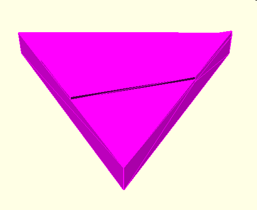

I can get the error with 3 vertices which reduces the number of polygons to 24 and look like this: [image: image.png] Now with this no vertices get merged but it still fails with: ERROR: CGAL error in CGAL_Nef_polyhedron3(): CGAL ERROR: assertion violation! Expr: pe_prev->is_border() || !internal::Plane_constructor<Plane>::get_plane(pe_prev->facet(),pe_prev->facet()->plane()).is_degenerate() File: C:/msys64/mingw64/include/CGAL/Nef_3/polyhedron_3_to_nef_3.h Line: 251 I notice in the above data there are triangles that are degenerate when printed as floats. They don't snap to the same indexes though, so perhaps that is the problem. Not enough points get collapsed. In an attempt to investigate this I made the grid 32 times larger. The number of polygons went up to 32 before quantisation and then reduced to 28 due to some merging but still give the error. And there are still degenerate looking triangles that don't get snapped. How can a courser grid lead to more polygons? Is CGAL's idea of degenerate not absolute? I.e. does a very thin triangle count as de-generate? On Sun, 6 Jan 2019 at 12:43, nop head <nop.head@gmail.com> wrote: > I added some debug to Polyset and simplified my model to be a stacked > pentagon subtracted from a cube to reduce the complexity of the polygons. > It now looks like this: > > [image: image.png] > > It looks like during F6 the union is never converted to a Polyset, so > there are no near vertices to collapse. F5 converts the union to a Polyset > before feeding it to CGAL and that is were it goes wrong as there are close > vertices in the same Polyset and they do collapse. Here is the Polyset > before, during and after being quantized. > > polyset: PolySet: > num polygons: 44 > polygon 0: ( -5 -3.63271 2) (-1.29953 -4.83507 2.25) ( -5 -3.63271 2.25) > polygon 1: (-1.29953 -4.83507 2.25) ( -5 -3.63271 2) (-1.29953 -4.83507 2) > polygon 2: (2.09182 5.62736 2.25) (4.83195 1.8559 2) (2.09182 5.62736 1.75) > polygon 3: (5.06738 1.53185 2.25) (4.83195 1.8559 2) (2.09182 5.62736 2.25) > polygon 4: (4.83195 1.8559 2) (5.06738 1.53185 2.25) (5.06738 1.53185 2) > polygon 5: (2.09182 5.62736 1.75) (4.83195 1.8559 2) (4.83195 1.8559 1.75) > polygon 6: ( -5 -3.63271 2) ( -5 -1.46447 2.25) ( -5 -1.46447 2) > polygon 7: ( -5 -1.46447 2.25) ( -5 -3.63271 2) ( -5 -3.63271 2.25) > polygon 8: ( -5 -1.46447 2.25) (5.06738 1.53185 2.25) (2.09182 5.62736 > 2.25) > polygon 9: (5.06738 1.53185 2.25) ( -5 -1.46447 2.25) (-1.29953 -4.83507 > 2.25) > polygon 10: (-1.29953 -4.83507 2.25) ( -5 -1.46447 2.25) ( -5 -3.63271 > 2.25) > polygon 11: ( -5 -1.46447 2) (2.09182 5.62736 2.25) (2.09182 5.62736 2) > polygon 12: (2.09182 5.62736 2.25) ( -5 -1.46447 2) ( -5 -1.46447 2.25) > polygon 13: (2.09182 5.62736 1.75) (2.09182 5.62736 1.75) (2.09182 5.62736 > 2) > polygon 14: (2.09182 5.62736 2) (2.09182 5.62736 2.25) (2.09182 5.62736 > 1.75) > polygon 15: (4.83195 1.8559 1.75) (2.09182 5.62736 1.75) (2.09182 5.62736 > 1.75) > polygon 16: (-1.29953 -4.83507 2) (5.06738 1.53185 2.25) (-1.29953 > -4.83507 2.25) > polygon 17: (5.06738 1.53185 2.25) (-1.29953 -4.83507 2) (5.06738 1.53185 > 2) > polygon 18: ( -5 -3.63271 -0.0078125) ( 1.90983 -5.87785 2) ( -5 -3.63271 > 2) > polygon 19: ( 1.90983 -5.87785 2) ( -5 -3.63271 -0.0078125) ( 1.90983 > -5.87785 -0.0078125) > polygon 20: ( 1.90983 -5.87785 2) ( 6.18034 0 -0.0078125) (6.18034 0 2) > polygon 21: ( 6.18034 0 -0.0078125) ( 1.90983 -5.87785 2) ( 1.90983 > -5.87785 -0.0078125) > polygon 22: ( 1.90983 5.87785 -0.0078125) ( -5 3.63271 2) (1.90983 5.87785 > 2) > polygon 23: ( -5 3.63271 2) ( 1.90983 5.87785 -0.0078125) ( -5 3.63271 > -0.0078125) > polygon 24: ( -5 -3.63271 -0.0078125) ( -5 3.63271 2) ( -5 3.63271 > -0.0078125) > polygon 25: ( -5 3.63271 2) ( -5 -3.63271 -0.0078125) ( -5 -3.63271 2) > polygon 26: ( -5 3.63271 2) (2.09182 5.62736 2) (1.90983 5.87785 2) > polygon 27: ( -5 -3.63271 2) ( -5 -1.46447 2) ( -5 3.63271 2) > polygon 28: (2.09182 5.62736 2) ( -5 3.63271 2) ( -5 -1.46447 2) > polygon 29: (6.18034 0 2) (4.83195 1.8559 2) (5.06738 1.53185 2) > polygon 30: (5.06738 1.53185 2) ( 1.90983 -5.87785 2) (6.18034 0 2) > polygon 31: (-1.29953 -4.83507 2) ( 1.90983 -5.87785 2) (5.06738 1.53185 2) > polygon 32: ( -5 -3.63271 2) (-1.29953 -4.83507 2) ( -5 -3.63271 2) > polygon 33: (-1.29953 -4.83507 2) ( -5 -3.63271 2) ( 1.90983 -5.87785 2) > polygon 34: ( -5 -1.46447 2) ( -5 -3.63271 2) ( -5 -3.63271 2) > polygon 35: ( 1.90983 -5.87785 -0.0078125) ( 1.90983 5.87785 -0.0078125) ( > 6.18034 0 -0.0078125) > polygon 36: ( -5 -3.63271 -0.0078125) ( 1.90983 5.87785 -0.0078125) ( > 1.90983 -5.87785 -0.0078125) > polygon 37: ( 1.90983 5.87785 -0.0078125) ( -5 -3.63271 -0.0078125) ( -5 > 3.63271 -0.0078125) > polygon 38: (4.83195 1.8559 2) (6.18034 0 2) (4.83195 1.8559 1.75) > polygon 39: (2.09182 5.62736 1.75) (1.90983 5.87785 2) (2.09182 5.62736 2) > polygon 40: (1.90983 5.87785 2) (2.09182 5.62736 1.75) ( 1.90983 5.87785 > -0.0078125) > polygon 41: (4.83195 1.8559 1.75) ( 1.90983 5.87785 -0.0078125) (2.09182 > 5.62736 1.75) > polygon 42: ( 6.18034 0 -0.0078125) (4.83195 1.8559 1.75) (6.18034 0 2) > polygon 43: (4.83195 1.8559 1.75) ( 6.18034 0 -0.0078125) ( 1.90983 > 5.87785 -0.0078125) > PolySet end > > Collapsed (2.091824,5.627358,1.750000) by (2.38419e-007,0,0) > polyset: Removing collapsed vertex 0 out of 3 from polygon 13 due to > quantizing > polyset: Removing collapsed polygon 13 due to quantizing > Collapsed (2.091824,5.627358,1.750000) by (2.38419e-007,0,0) > polyset: Removing collapsed vertex 1 out of 3 from polygon 15 due to > quantizing > polyset: Removing collapsed polygon 15 due to quantizing > Collapsed (-5.000000,-3.632712,2.000000) by (4.76837e-007,0,0) > Collapsed (-5.000000,-3.632712,2.000000) by (4.76837e-007,0,0) > Collapsed (-5.000000,-3.632712,2.000000) by (4.76837e-007,0,0) > Collapsed (-5.000000,-3.632712,2.000000) by (4.76837e-007,0,0) > polyset: Removing collapsed vertex 2 out of 3 from polygon 32 due to > quantizing > polyset: Removing collapsed polygon 32 due to quantizing > Collapsed (-5.000000,-3.632712,2.000000) by (4.76837e-007,0,0) > Collapsed (-5.000000,-3.632712,2.000000) by (4.76837e-007,0,0) > polyset: Removing collapsed vertex 1 out of 3 from polygon 34 due to > quantizing > polyset: Removing collapsed polygon 34 due to quantizing > Collapsed (2.091824,5.627358,1.750000) by (2.38419e-007,0,0) > Collapsed (2.091824,5.627358,1.750000) by (2.38419e-007,0,0) > Collapsed (2.091824,5.627358,1.750000) by (2.38419e-007,0,0) > > polyset: PolySet: > num polygons: 40 > polygon 0: ( -5 -3.63271 2) (-1.29953 -4.83507 2.25) ( -5 -3.63271 2.25) > polygon 1: (-1.29953 -4.83507 2.25) ( -5 -3.63271 2) (-1.29953 -4.83507 2) > polygon 2: (2.09182 5.62736 2.25) (4.83195 1.8559 2) (2.09182 5.62736 1.75) > polygon 3: (5.06738 1.53185 2.25) (4.83195 1.8559 2) (2.09182 5.62736 2.25) > polygon 4: (4.83195 1.8559 2) (5.06738 1.53185 2.25) (5.06738 1.53185 2) > polygon 5: (2.09182 5.62736 1.75) (4.83195 1.8559 2) (4.83195 1.8559 1.75) > polygon 6: ( -5 -3.63271 2) ( -5 -1.46447 2.25) ( -5 -1.46447 2) > polygon 7: ( -5 -1.46447 2.25) ( -5 -3.63271 2) ( -5 -3.63271 2.25) > polygon 8: ( -5 -1.46447 2.25) (5.06738 1.53185 2.25) (2.09182 5.62736 > 2.25) > polygon 9: (5.06738 1.53185 2.25) ( -5 -1.46447 2.25) (-1.29953 -4.83507 > 2.25) > polygon 10: (-1.29953 -4.83507 2.25) ( -5 -1.46447 2.25) ( -5 -3.63271 > 2.25) > polygon 11: ( -5 -1.46447 2) (2.09182 5.62736 2.25) (2.09182 5.62736 2) > polygon 12: (2.09182 5.62736 2.25) ( -5 -1.46447 2) ( -5 -1.46447 2.25) > polygon 13: (2.09182 5.62736 2) (2.09182 5.62736 2.25) (2.09182 5.62736 > 1.75) > polygon 14: (-1.29953 -4.83507 2) (5.06738 1.53185 2.25) (-1.29953 > -4.83507 2.25) > polygon 15: (5.06738 1.53185 2.25) (-1.29953 -4.83507 2) (5.06738 1.53185 > 2) > polygon 16: ( -5 -3.63271 -0.0078125) ( 1.90983 -5.87785 2) ( -5 -3.63271 > 2) > polygon 17: ( 1.90983 -5.87785 2) ( -5 -3.63271 -0.0078125) ( 1.90983 > -5.87785 -0.0078125) > polygon 18: ( 1.90983 -5.87785 2) ( 6.18034 0 -0.0078125) (6.18034 0 2) > polygon 19: ( 6.18034 0 -0.0078125) ( 1.90983 -5.87785 2) ( 1.90983 > -5.87785 -0.0078125) > polygon 20: ( 1.90983 5.87785 -0.0078125) ( -5 3.63271 2) (1.90983 5.87785 > 2) > polygon 21: ( -5 3.63271 2) ( 1.90983 5.87785 -0.0078125) ( -5 3.63271 > -0.0078125) > polygon 22: ( -5 -3.63271 -0.0078125) ( -5 3.63271 2) ( -5 3.63271 > -0.0078125) > polygon 23: ( -5 3.63271 2) ( -5 -3.63271 -0.0078125) ( -5 -3.63271 2) > polygon 24: ( -5 3.63271 2) (2.09182 5.62736 2) (1.90983 5.87785 2) > polygon 25: ( -5 -3.63271 2) ( -5 -1.46447 2) ( -5 3.63271 2) > polygon 26: (2.09182 5.62736 2) ( -5 3.63271 2) ( -5 -1.46447 2) > polygon 27: (6.18034 0 2) (4.83195 1.8559 2) (5.06738 1.53185 2) > polygon 28: (5.06738 1.53185 2) ( 1.90983 -5.87785 2) (6.18034 0 2) > polygon 29: (-1.29953 -4.83507 2) ( 1.90983 -5.87785 2) (5.06738 1.53185 2) > polygon 30: (-1.29953 -4.83507 2) ( -5 -3.63271 2) ( 1.90983 -5.87785 2) > polygon 31: ( 1.90983 -5.87785 -0.0078125) ( 1.90983 5.87785 -0.0078125) ( > 6.18034 0 -0.0078125) > polygon 32: ( -5 -3.63271 -0.0078125) ( 1.90983 5.87785 -0.0078125) ( > 1.90983 -5.87785 -0.0078125) > polygon 33: ( 1.90983 5.87785 -0.0078125) ( -5 -3.63271 -0.0078125) ( -5 > 3.63271 -0.0078125) > polygon 34: (4.83195 1.8559 2) (6.18034 0 2) (4.83195 1.8559 1.75) > polygon 35: (2.09182 5.62736 1.75) (1.90983 5.87785 2) (2.09182 5.62736 2) > polygon 36: (1.90983 5.87785 2) (2.09182 5.62736 1.75) ( 1.90983 5.87785 > -0.0078125) > polygon 37: (4.83195 1.8559 1.75) ( 1.90983 5.87785 -0.0078125) (2.09182 > 5.62736 1.75) > polygon 38: ( 6.18034 0 -0.0078125) (4.83195 1.8559 1.75) (6.18034 0 2) > polygon 39: (4.83195 1.8559 1.75) ( 6.18034 0 -0.0078125) ( 1.90983 > 5.87785 -0.0078125) > PolySet end > ERROR: CGAL error in CGAL_Nef_polyhedron3(): CGAL ERROR: assertion > violation! Expr: pe_prev->is_border() || > !internal::Plane_constructor<Plane>::get_plane(pe_prev->facet(),pe_prev->facet()->plane()).is_degenerate() > File: C:/msys64/mingw64/include/CGAL/Nef_3/polyhedron_3_to_nef_3.h Line: 251 > > > > > On Sun, 6 Jan 2019 at 10:20, nop head <nop.head@gmail.com> wrote: > >> The sqrt is pointless as it only needs to know the nearest, so could >> compare the squared value. Also the 27 distances are constants, either 0, >> 1, sqrt(2) or sqrt(3). The 2D version uses the Manhattan distance, which I >> think is just as good for +/-1 but abs() might take longer than integer >> multiply. >> >> Wouldn't it be roughly the same to make the grid spacing three times >> bigger? >> >> I had actually removed the neighbour search when I posted the offsets >> above. With that code back in more vertices collapse. >> >> Collapsed (2.164763,4.740169,1.750000) by (2.38419e-007,0,0) >> >> Collapsed (-3.412535,-3.938275,1.750000) by (-1.19209e-006,2.38419e-007,0) >> >> Collapsed (-3.412535,-3.938275,1.750000) by (-1.19209e-006,2.38419e-007,0) >> >> Collapsed (4.383843,2.817325,1.750000) by (0,7.15256e-007,0) >> >> Collapsed (4.383843,2.817325,1.750000) by (0,7.15256e-007,0) >> >> Collapsed (4.383843,2.817325,1.750000) by (0,7.15256e-007,0) >> >> Collapsed (2.164763,4.740169,1.750000) by (2.38419e-007,0,0) >> >> Collapsed (4.383843,2.817325,1.750000) by (0,7.15256e-007,0) >> >> Collapsed (2.164763,4.740169,1.750000) by (2.38419e-007,0,0) >> >> Collapsed (2.164763,4.740169,1.750000) by (2.38419e-007,0,0) >> >> Collapsed (2.164762,4.740170,2.000000) by (4.76837e-007,-4.76837e-007,0) >> >> Collapsed (2.164763,4.740169,1.750000) by (2.38419e-007,0,0) >> >> Collapsed (2.164762,4.740170,2.000000) by (4.76837e-007,-4.76837e-007,0) >> >> Collapsed (2.164763,4.740169,1.750000) by (2.38419e-007,0,0) >> >> Collapsed (-5.000000,-1.468132,2.000000) by (4.76837e-007,-4.76837e-007,0) >> >> Collapsed (4.383843,2.817325,1.750000) by (0,7.15256e-007,0) >> >> Collapsed (2.164762,4.740170,2.000000) by (4.76837e-007,-4.76837e-007,0) >> >> Collapsed (-5.000000,-1.468132,2.000000) by (4.76837e-007,-4.76837e-007,0) >> >> Collapsed (-3.412535,-3.938275,1.750000) by (-1.19209e-006,2.38419e-007,0) >> >> Collapsed (-5.000000,-1.468132,2.000000) by (4.76837e-007,-4.76837e-007,0) >> >> Collapsed (-3.412535,-3.938275,1.750000) by (-1.19209e-006,2.38419e-007,0) >> >> Collapsed (2.164762,4.740170,2.000000) by (4.76837e-007,-4.76837e-007,0) >> >> Collapsed (2.164762,4.740170,2.000000) by (4.76837e-007,-4.76837e-007,0) >> >> Collapsed (-5.000000,-1.468132,2.000000) by (4.76837e-007,-4.76837e-007,0) >> >> Collapsed (-5.000000,-1.468132,2.000000) by (4.76837e-007,-4.76837e-007,0) >> >> Collapsed (-5.000000,-1.468132,2.000000) by (4.76837e-007,-4.76837e-007,0) >> >> >> But the results are the same. Curiously if the number of sides is even F5 >> works but F6 fails unless the cache is flushed. When it is odd the CGAL >> error happens in F5. >> >> >> It seems that Polyset is only that, a set of polygons, which are lists of >> vertices, no edge information. So I think collapsing vertices should be OK >> in that format as the edges are implied. That would be as long as all the >> faces have exactly the right vertex values, so that each copy of the vertex >> in different polygons ends up snapped to the same value. After snapping it >> removes duplicate triangles and degenerate triangles here: >> https://github.com/openscad/openscad/blob/master/src/polyset.cc#L220. >> >> So there seems to definitely be a bug when it collapses vertices but I no >> longer think it is fundamentally wrong to do it while in PolySet format. It >> would be for a mesh with edges. >> >> >> >> >> >> >> On Sun, 6 Jan 2019 at 03:28, MichaelAtOz <oz.at.michael@gmail.com> wrote: >> >>> > It appears that the grid-ness is intended to keep Rationals 'compact' >>> to >>> speed CGAL processing. >>> >>> No, that was just a refinement, changing from the arbitrary 0.000001, for >>> efficiency. >>> >>> >>> > There is also code in grid.h that searches 27 neighbouring grid points >>> and >>> > picks the nearest one that is populated. I.e. deliberately merging >>> > vertices that would otherwise be one grid position apart. Why? >>> >>> I don't think it is that simple, I haven't fully grasped what it is up >>> to. >>> >>> 'nearest one' - It is taking the Euclidean norm, of the grid points. >>> I've seen this somewhere recently, I think reading on topology repair. >>> I'm wondering if the implementation is wrong. >>> Should it not look for the closest point on the 3x3 grid based on >>> non-quantised values, ie float vector. >>> As is d = sqrt((key-k).squaredNorm()) - key & k have both been quantised. >>> Otherwise the +/-1 grid space Euclidean distance seems sort of pointless >>> (no >>> pun intended). >>> >>> So where are all the Topologists? What is it mean to do to refine the >>> topology into a grid? >>> >>> >>> >>> >>> >>> ----- >>> Admin - email* me if you need anything, or if I've done something >>> stupid... >>> >>> * click on my MichaelAtOz label, there is a link to email me. >>> >>> Unless specifically shown otherwise above, my contribution is in the >>> Public Domain; to the extent possible under law, I have waived all >>> copyright and related or neighbouring rights to this work. Obviously >>> inclusion of works of previous authors is not included in the above. >>> >>> The TPP is no simple “trade agreement.” Fight it! >>> http://www.ourfairdeal.org/ time is running out! >>> -- >>> Sent from: http://forum.openscad.org/ >>> >>> _______________________________________________ >>> OpenSCAD mailing list >>> Discuss@lists.openscad.org >>> http://lists.openscad.org/mailman/listinfo/discuss_lists.openscad.org >>> >>
Sun, Jan 6, 2019 6:32 PM
Actually no, there aren't any degenerate or nearly degenerate triangles
after Polyset::quantize(). I was missing a minus sign.
The 28 polygon Polyset that is the last to be quantized is actually the
inner render(). It is a negative volume that looks like this:
I wonder why the top level render doesn't get quantized. Perhaps CGAL fails
polyset: PolySet:
num polygons: 44
1.75)
2.25)
2.25)
2.25)
2.25)
5.62736 2)
1.75)
1.75)
-4.83507 2.25)
2)
2)
5.87785 2)
-0.0078125)
-0.0078125)
2)
3.63271 -0.0078125)
-0.0078125)
5.62736 1.75)
5.87785 -0.0078125)
PolySet end
quantizing
quantizing
quantizing
quantizing
polyset: PolySet:
num polygons: 40
1.75)
2.25)
2.25)
2.25)
2.25)
1.75)
-4.83507 2.25)
2)
2)
5.87785 2)
-0.0078125)
-0.0078125)
2)
3.63271 -0.0078125)
-0.0078125)
5.62736 1.75)
5.87785 -0.0078125)
PolySet end
fails before.
F5 works but F6 fails unless the cache is flushed. When it is odd the CGAL
fails before.
