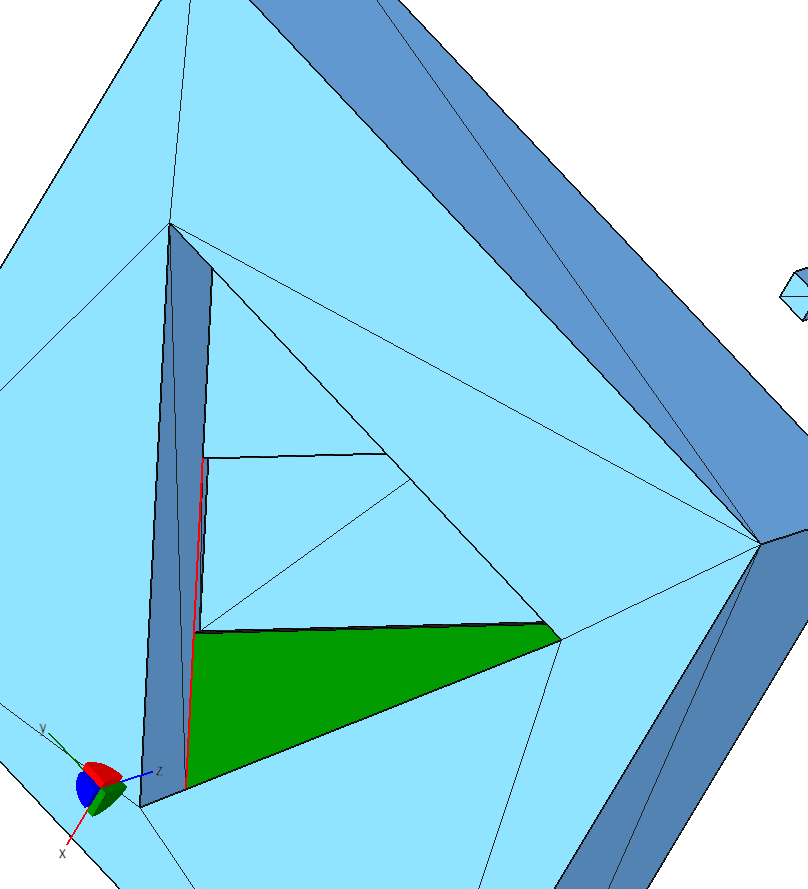

Looking at my example I think the rotated polygon's vertices do get snapped
back together, the problem is the intersection with the cube. That produces
intersections with a sloping plane, so those can never line exactly on the
plane when expressed as doubles. When the intersection is done in CGAL the
results already contain degenerate and nearly degenerate triangles simply
by converting them to Polyset doubles. The grid quantization changes one
from a sliver to fully degenerate, one fully degenerate into a sliver and
leaves two fully degenerate the same. There is a 50% chance each of these
will also have the wrong winding order because in the rational format they
probably were all slivers correctly orientated. That is lost by truncating
them to doubles.
So, as we have known since the beginning, you cannot reduce the resolution
of the vertices in any way without following it with a mesh repair.
OpenSCAD is fundamentally broken in this respect and always has been at the
very least on STL export. Now there are many places it can go wrong as
switches between rationals, doubles and fixed point. Gridding can't fix
points that have to meet a diagonal plane. That will always generate
slivers where the originally flat plane gets tessellated. You can see this
here where there is an extra edge.

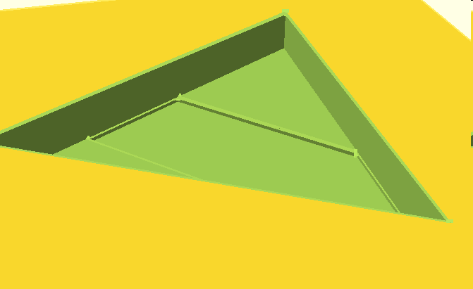

For reference I tried it without the grid and it still fails. I now know
this is because it is already broken at the rational to double truncation.
Yes I think STL files only support single precision floats.
A fixed grid will not work with floats at all scales because floats have
decreasing resolution as you move away from the origin. I had to translate
my test from the origin to get it to fail. It might be possible to pick a
grid that works for the normal 3D print scale though. I think it needs to
be chosen carefully to merge common trig rounding errors.
If you have a simple quad then grid snapping will help it stay planar but
where you have a more complex face, like a rectangle not parallel to an
axis with a rectangular slot then grid snapping actually makes it less
planar as the points defining the slot get snapped from their ideal
position which is not a rational number and the ideal position changes
slightly if the corners are snapped. This is what happens in this example.
It keeps the triangular pocket planar but the intersecting cube causes
problems.
When F6 is run from an empty cache the resulting exported STL looks OK but
NetFabb says it is self intersecting and refuses to fix it unless I pay.
The complicated second operand to the difference never seems to be
converted to a Polyset, so it never gets broken. CGAL is happy but the
final result gets broken converting to float for the export.
I tried to find where render() was implemented but couldn't find where it
did the actual geometry. It seems during F5 is must run CGAL and convert
the result to a Polyset and cache it. During F6 it seems to be a NOP. Is
this the case?

It isn't terribly efficient because it has no edge structures, so it is
O(MN) when M is the number of degenerate triangles and N the number of
faces. However, it is better than failing with an error.
The PR is https://github.com/openscad/openscad/pull/2694
problems.
this the case?
