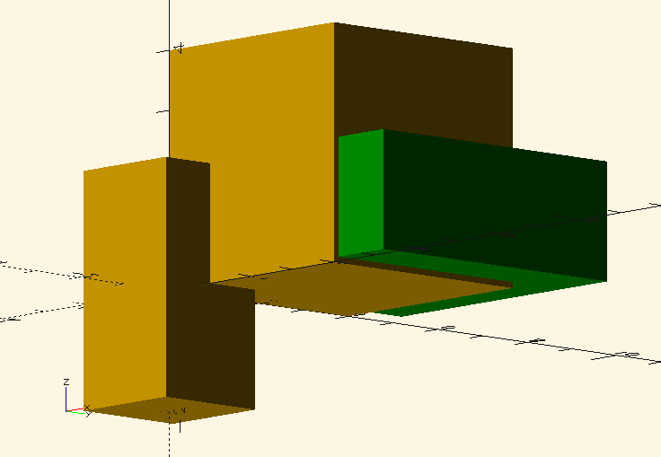

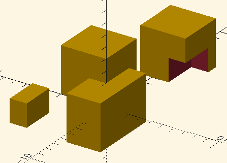

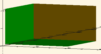

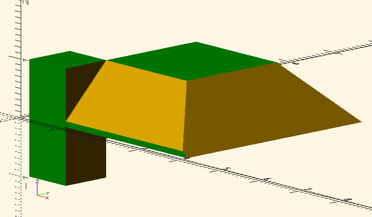

Tue, Oct 7, 2025 4:31 PM
so here i am doing the boolean operations on a linear extrusion and a cube with this code cubesize=[6,1,1]; union() { linear_extrude(4) square(4); cube(cubesize, center=true); } translate([-6,3,0]) intersection() { linear_extrude(4) square(4); cube(cubesize, center=true); } translate([6,-3,0]) difference() { linear_extrude(4) square(4); cube(cubesize, center=true); } my question is .. is this mixing 2D and 3D shapes in boolean operations? or not. according to my place on the learning curve once i extrude from the 2D shape it is not involved in the boolean anymore i try this code cubesize=[6,1,1]; intersection(){ translate([.1,.1,.1]) color("green") %cube([5,5,2]); union() { linear_extrude(4) square(4); cube(cubesize, center=true); } } and i see this and when i remove the % on the cube the intersection does its thing .. i do think it odd that some of the sides of the resulting shape are still yellow and through all of this there are no warnings in the console i change the code a bit .. the intersecting cube is moved down in Z to be sure that it is overlapping with the square cubesize=[6,1,1]; intersection(){ translate([.1,.1,-1]) color("green") cube([5,5,2]); union() { roof() square(4); cube(cubesize, center=true); }} and we see this so .. EITHER we should be seeing warnings .. so there is a bug in there somewhere OR the use of an extrusion or a roof to create 3D geometry means this code is not mixing 2D with 3D shapes some of you will be tired of me pursuing this .. but for me .. maybe it really is my understanding that is flawed so how is it that the 2D shape underlying the linear extrusion, or the roof, is still being considered as part of the boolean operation .. and why are the warnings about mixing 2D with 3D not being emitted? thanks for your kind attention Jeff Hayes
Tue, Oct 7, 2025 5:48 PM
An extrusion of a 2d thing is no longer 2d. It is 3d.
On Tue, Oct 7, 2025 at 12:32 Jeffrey Hayes via Discuss <
with this code
cubesize=[6,1,1];
linear_extrude(4)
square(4);
translate([-6,3,0])
linear_extrude(4)
square(4);
translate([6,-3,0])
linear_extrude(4)
square(4);
or not.
i try this code
cubesize=[6,1,1];
intersection(){
color("green")
%cube([5,5,2]);
linear_extrude(4)
square(4);
and i see this
cubesize=[6,1,1];
intersection(){
color("green")
cube([5,5,2]);
roof()
square(4);
and we see this
so ..
really is *my *understanding that is flawed
Jeff Hayes
