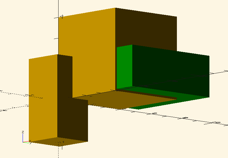

i try this code
cubesize=[6,1,1];
intersection(){
    translate([.1,.1,.1])
        color("green")
            %cube([5,5,2]);
        linear_extrude(4)
            square(4);
        cube(cubesize, center=true);
You have done two things there that are ... odd.
First, you marked the first cube with a %.  That's officially the
"background modifier
https://en.wikibooks.org/wiki/OpenSCAD_User_Manual/Modifier_Characters#Background_Modifier",
but I call it a ghost; it is displayed (by default as a translucent
gray) but does not participate in rendering.  I wasn't absolutely sure
what that would mean for previewing because of the black magic that goes
into previewing, but it seems like it does not play a part in boolean
operations in previewing either.
... but the fact that that branch of the tree, the first child of the
intersection,  is empty does appear to trigger an ... interesting ...
behavior, which is that if you have an intersection or difference, where
one of the children is nothing, it is as if that child was not present.
That's debatably wrong; there's a good argument that intersecting with
nothing yields nothing, but it is what it is.  So that intersection ends
up doing basically nothing.

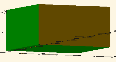

The second odd thing is that you recolored a %-marked object.  I
couldn't have told you offhand what that would do, but it appears to
have more or less straightforwardly changed the color of that cube from
translucent gray to solid green.
The linear_extrude yields an obvious 4x4x4 cube in the +XYZ octant,
unioned with a 6x1x1 cube(oid) centered on the origin; that's the yellow
parts.
and i see this
Yes, I think that's fully explained above.
and when i remove the % on the cube the intersection does its thing
You made it real, so it participated in the boolean operation.

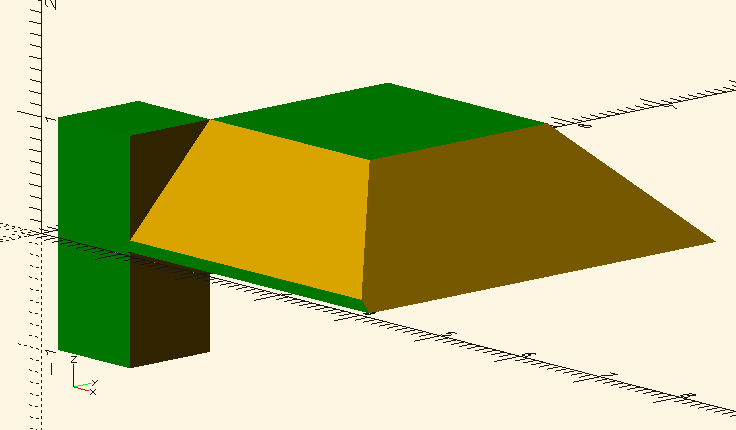

i change the code a bit .. the intersecting cube is moved down in Z to
be sure that it is overlapping with the square
cubesize=[6,1,1];
intersection(){
    translate([.1,.1,-1])
    color("green")
        cube([5,5,2]);
  roof()
    square(4);
and we see this
so ..
EITHER we should be seeing warnings .. so there is a bug in there
somewhere
OR the use of an extrusion or a roof to create 3D geometry means this
code is not mixing 2D with 3D shapes
You just said it:  the use of an extrusion or a roof to create 3D
geometry means that this code is not mixing 2D with 3D shapes.
There is no boolean operation in this model that is handed both a 2D
shape and a 3D shape.
so how is it that the 2D shape underlying the linear extrusion, or the
roof, is still being considered as part of the boolean operation
It isn't.  Why do you think it is?  Because of the green line along the
bottom of the pyramid?  that's where you intersected away the edge of
the pyramid.
 .. and why are the warnings about mixing 2D with 3D not being emitted?
Because there are no places where you mixed 2D with 3D.
Let's re-indent and mark up that model...
cubesize=[6,1,1];
intersection() {                                  <
    translate([.1,.1,-1])   <                     <
        color("green")      < 3D                  <
            cube([5,5,2]);  <                     <
    union() {                               <     < 3D
        roof()                        < 3D  <     <
            square(4);      < 2D      <     < 3D  <
        cube(cubesize, center=true);  < 3D  <     <
Or, in prose:
1.  You created a 5x2x2 cube. (3D)
2.  You colored it green. (3D)
3.  You translated it a little +XY and -Z (3d)
4.  You created a 4x4 square. (2D)
5.  You roofed it, forming a pyramid.  (3D)
6.  You created a 6x1x1 cube. (3D)
7.  You unioned  the pyramid from 5 with the cube from 6.  (3D + 3D --> 3D)
8.  You intersected the pyramid-cube from 7 with the cube from 3.  (3D
intersect 3D --> 3D)
You have two boolean operations there, 7 and 8.  In neither of them did
you mix 2D and 3D objects.
