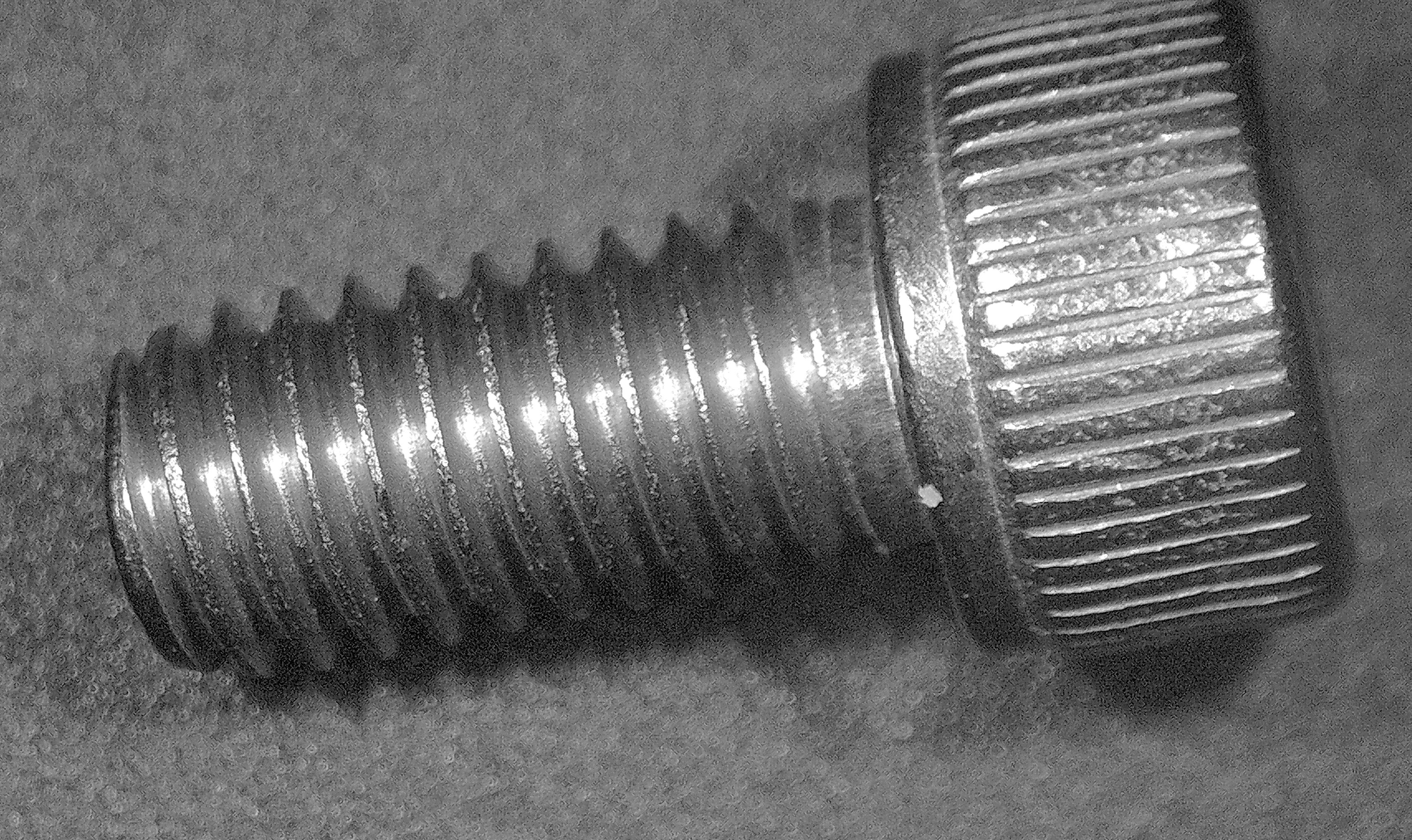

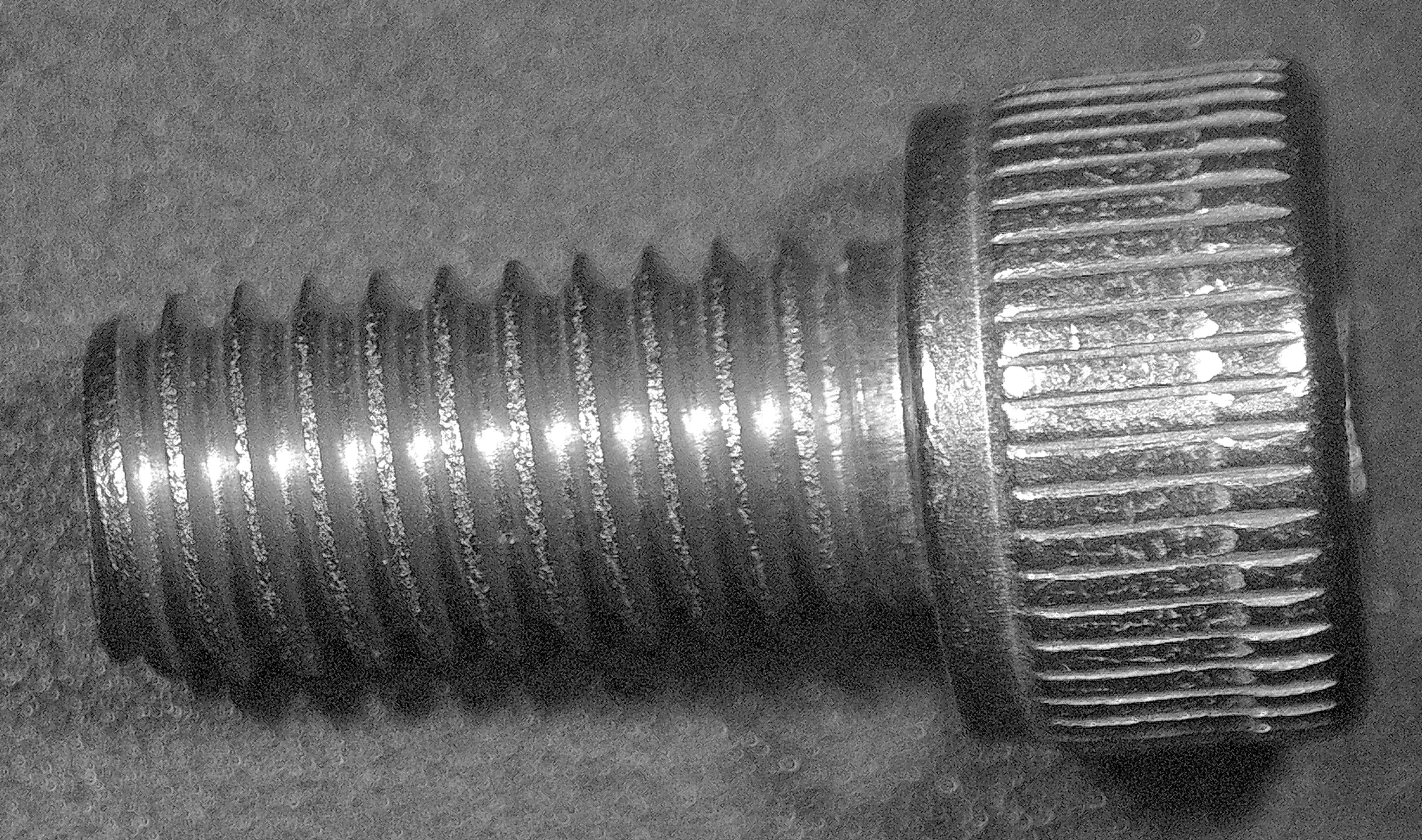

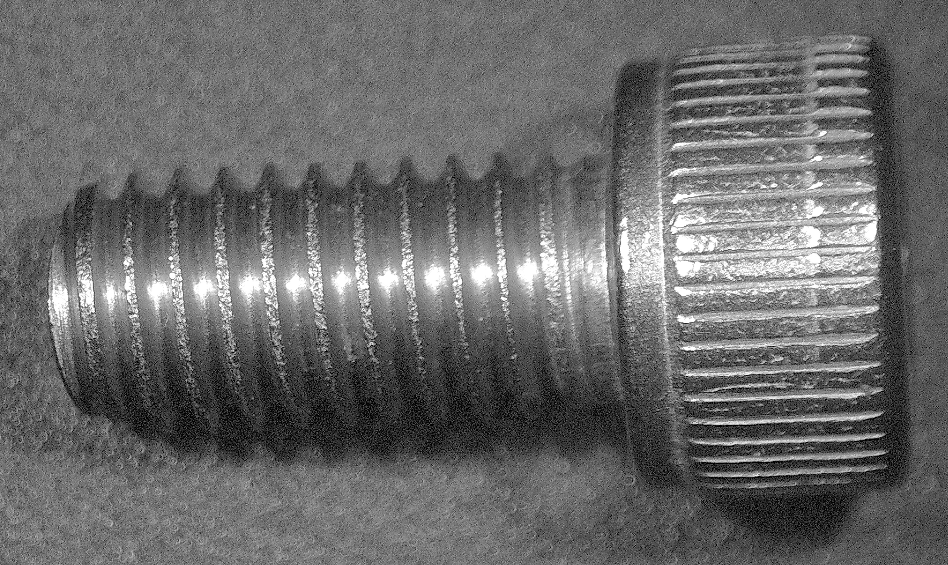

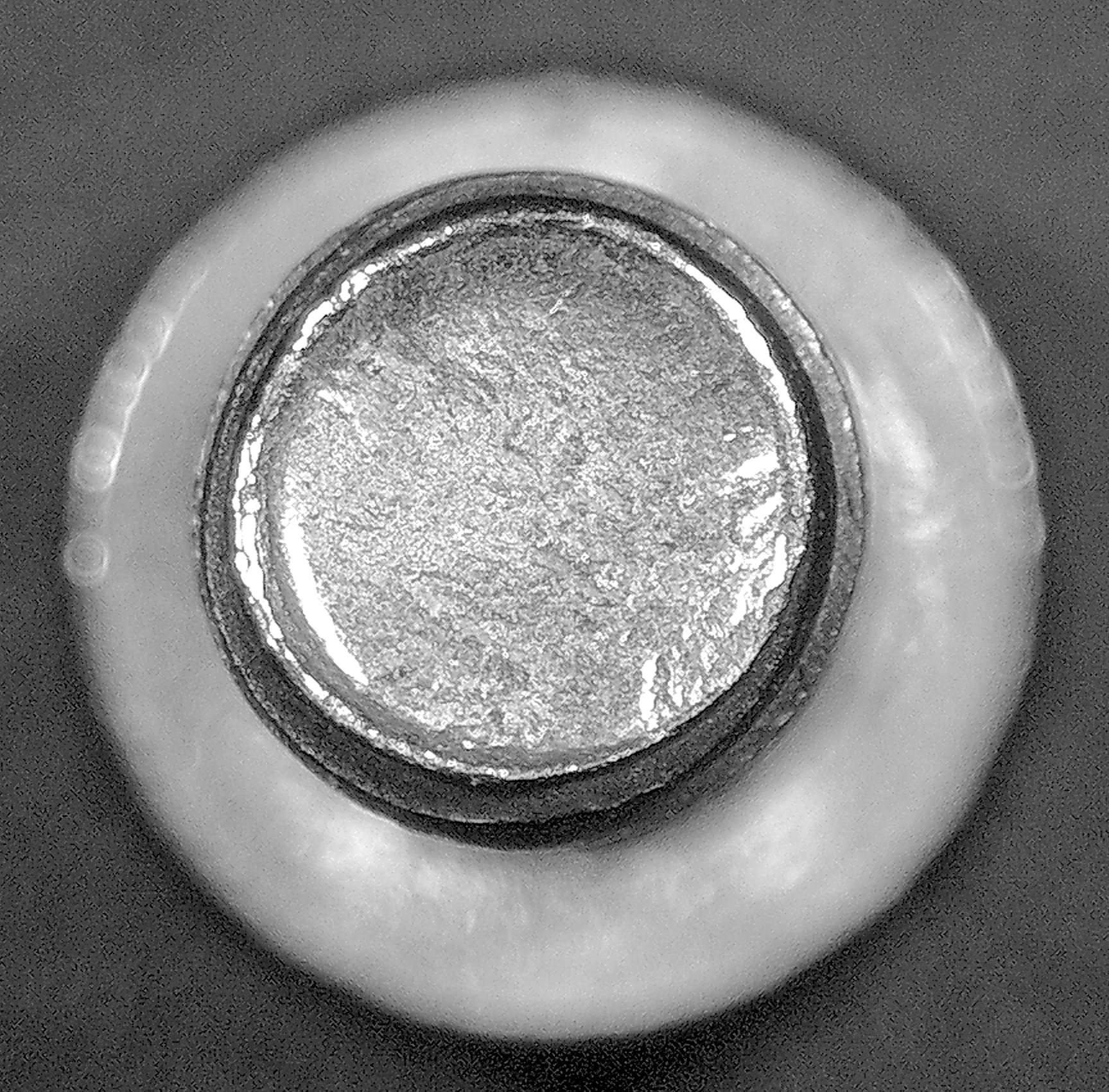

I pulled out my digital microscope and a beefy M5 screw to see if I can get a clearer view:

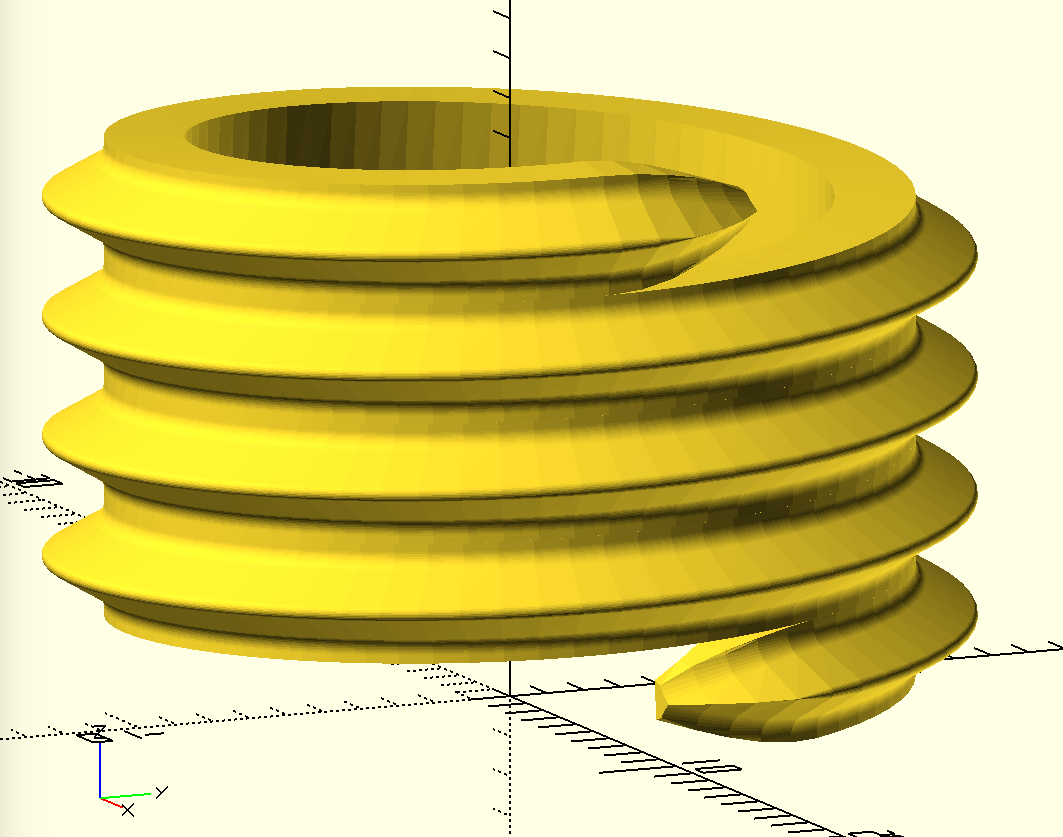

For nuts and female threads I taper the last half turn outwards until it
goes beyond the major diameter. That is what nuts I buy appear to do and
has worked fine for printed threads.

I don't think there is anything to be gained with an abrupt end, so a
tapered end and the ability to have the minor diameter cylinder extend past
the end of the thread seems fine to me. I fix the taper at 1/2 turn but if
it was specifiable 0 would be classic higbee, and a short one would be like
the bottle thread you showed.

I think you may be mistaken,  that in fact a very short thread termination
is important for reducing cross threading, and that a 180 degree taper is
actually bad.  if there is a large amount of partial height or narrower
thread then that is just the thing that can start a crossthread.

Well if that is true you can simply set the taper length to zero, or close
to zero for printed threads but to represent screws I can buy I use 180
degrees and never had a problem with cross threading large 3D printed
threads.

Yes I quoted the patent in my earlier message.  He focuses on the
threads being of full width, and doesn't say much about how you terminate,
but he does imply that the termination is abrupt, not some kind of long
taper.
But the question isn't how to specifically do Higbee but how to do the
best possible threads given no classic manufacturing constraints.

Well if that is true you can simply set the taper length to zero, or close to zero for printed threads but to represent screws I can buy I use 180 degrees and never had a problem with cross threading large 3D printed threads. On Tue, 21 Feb 2023 at 21:12, Adrian Mariano <avm4@cornell.edu> wrote: > I think you may be mistaken, that in fact a very short thread termination > is important for reducing cross threading, and that a 180 degree taper is > actually bad. if there is a large amount of partial height or narrower > thread then that is just the thing that can start a crossthread. > > On Tue, Feb 21, 2023, 07:54 nop head <nop.head@gmail.com> wrote: > >> I don't think there is anything to be gained with an abrupt end, so a >> tapered end and the ability to have the minor diameter cylinder extend past >> the end of the thread seems fine to me. I fix the taper at 1/2 turn but if >> it was specifiable 0 would be classic higbee, and a short one would be like >> the bottle thread you showed. >> >> On Tue, 21 Feb 2023 at 12:46, Adrian Mariano <avm4@cornell.edu> wrote: >> >>> Yes I quoted the patent in my earlier message. He focuses on the >>> threads being of full width, and doesn't say much about how you terminate, >>> but he does imply that the termination is abrupt, not some kind of long >>> taper. >>> >>> But the question isn't how to specifically do Higbee but how to do the >>> best possible threads given no classic manufacturing constraints. >>> >>> On Tue, Feb 21, 2023 at 5:43 AM Raymond West <raywest@raywest.com> >>> wrote: >>> >>>> The patent drawings for Higbee thread are available on line. >>>> https://patents.google.com/patent/US447775A Note that he is not >>>> bothered >>>> about the termination profile of the thread. Over the years, >>>> manufacturing/whatever has changed, and other forma are similar, and >>>> may >>>> or may not be named the same. The name is not now used, at least on >>>> this >>>> side of the pond, similar to Hoover (vacuum cleaner), Biro (ballpoint >>>> pen) etc. As i mentioned, get the guy to send you a drawing of what he >>>> thinks a Higbee is. (Even Chatgbt doesn't know what it is, therefore it >>>> does not exist... 😁) >>>> >>>> (This is the thread that keeps on giving) >>>> _______________________________________________ >>>> OpenSCAD mailing list >>>> To unsubscribe send an email to discuss-leave@lists.openscad.org >>>> >>> _______________________________________________ >>> OpenSCAD mailing list >>> To unsubscribe send an email to discuss-leave@lists.openscad.org >>> >> _______________________________________________ >> OpenSCAD mailing list >> To unsubscribe send an email to discuss-leave@lists.openscad.org >> > _______________________________________________ > OpenSCAD mailing list > To unsubscribe send an email to discuss-leave@lists.openscad.org >
Tue, Feb 21, 2023 11:18 PM
Yes, no taper at all is what I originally did, in fact.  But perhaps a
small taper helps with engaging the threads, so things don't have to be
perfectly aligned to get started?
threads.
termination is important for reducing cross threading, and that a 180
degree taper is actually bad.  if there is a large amount of partial height
or narrower thread then that is just the thing that can start a
crossthread.
