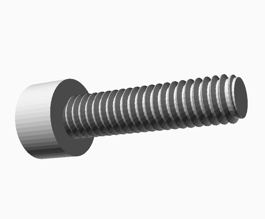

Most of the machine screws depicted in McMaster Carr CAD files seem to
be like a threaded rod, chopped off arbitrarily then chamfered at 45
degrees. In designing optimal 3D-printed plastic threads, mass-produced
screws may be too simplistic to use for inspiration. And a general CAD
library may need to support two or three designs to cover the majority
of modeling applications.

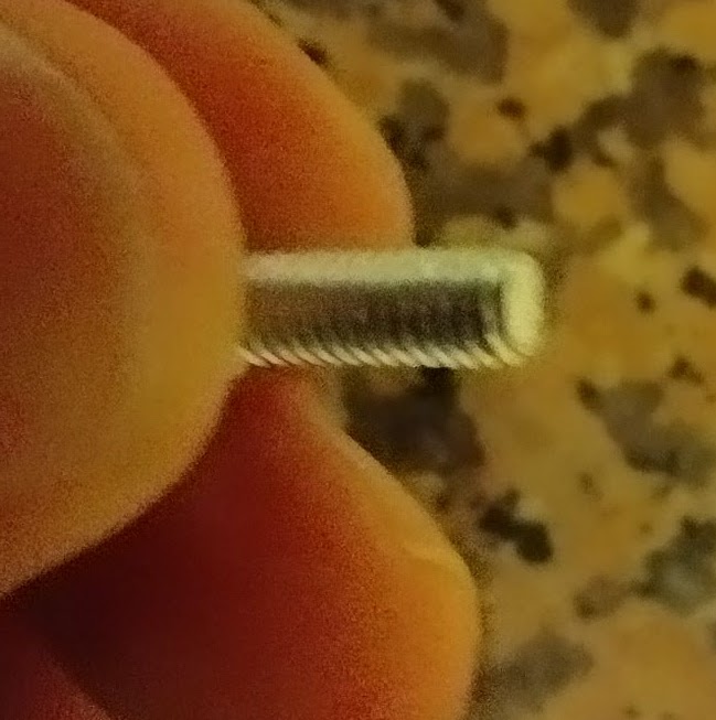

The pic is a alas too rubbish for me to tell what' going on, but it
looks like it might be like my screws, which have a beveled end, not
the feature you're describing.  Note that it's a small bevel, like the
size of one thread, so it has the effect of cutting off part of the
thread and could produce the illusion of an intentional taper like
you're describing.  I inspected my screws under 10x magnification to
figure out what was going on.

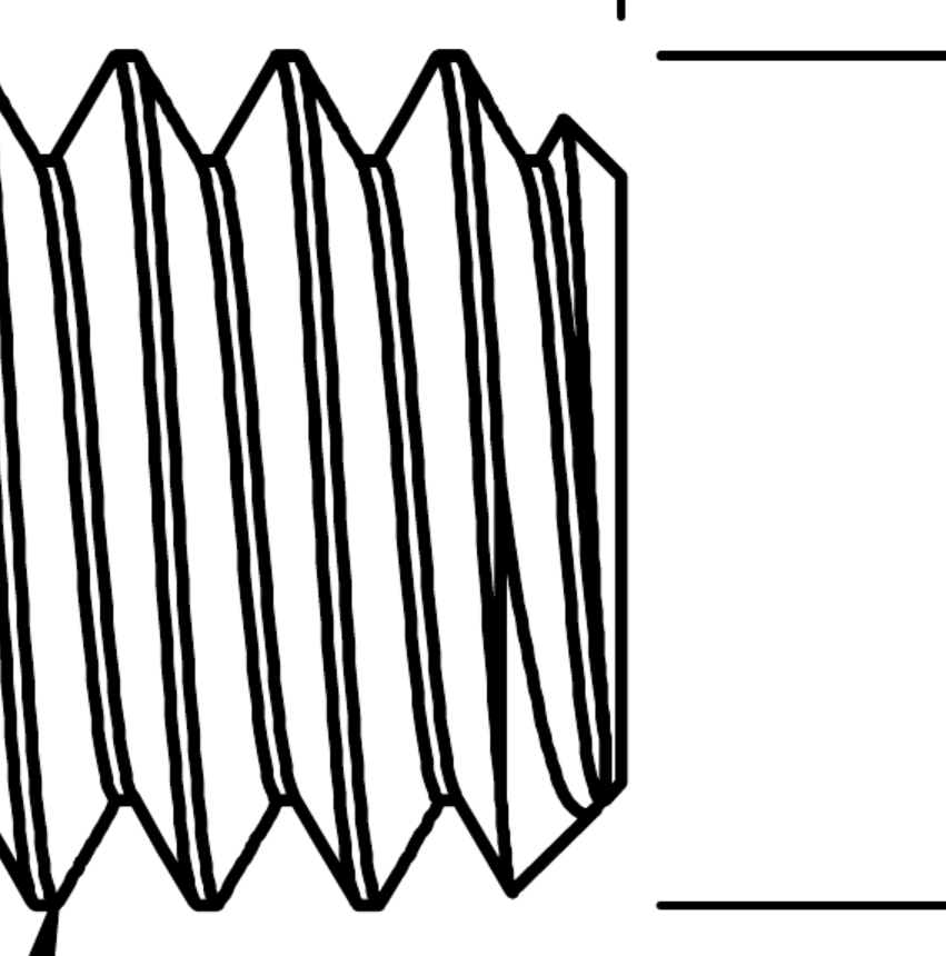

 That is what it looks like to me. Excuse the rubbish photo, I only
 have a phone with me.
 This is my attempt to model what I see.

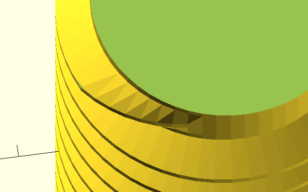

                     So lineiar decrease in diameter of the
                     thread?   Something like this?   I have two
                     views for clarity:
                     Why would you want to extend the taper for a
                     full half-turn.  My correspondent was a little
                     self-inconsistent, but suggested a *much*
                     shorter length, and it seems like a shorter
                     length is better.  In fact, I wonder if really
                     very short is best.  Doesn't the section where
                     the diameter of the thread is reduced enable
                     you to hop over it to crossthread?  It seems
                     like the abrupt end of the threads is the key
                     to success here:  you can't hop into the next
                     thread because you have a full thread in the
                     way.   That's why I wonder if tapering is even
                     a good idea as compared to a more abrupt
                     stop.  On the other hand, maybe the bottle
                     makers know what they're doing? Their standard
                     doesn't specify this, but in their drawings it
                     looks like about a quarter of a right angle,
                     so ~20 degrees.   My correspondent seemed to
                     think it should depend on the pitch size of
                     the threads, and nothing to do with angle,
                     though.

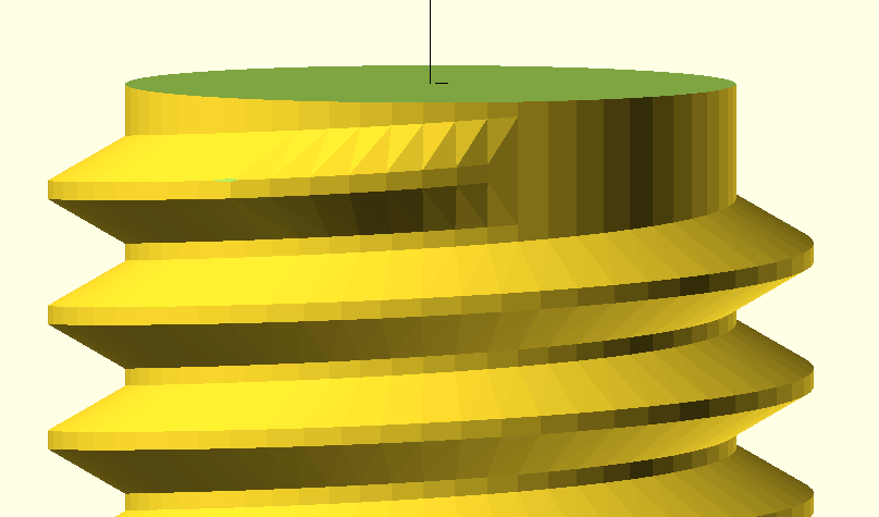

                         Tapered by making the thread diameter
                         decrease until it is below the minor
                         diameter and disappears. I do it linearly
                         over half a turn but your bottle
                         example was much less.
                         Higbee removes the crests instead because
                         the thread is already formed at the
                         nominal diameter. It can either ramp down
                         gradually or be completely removed with a
                         rotary milling tool leaving a short ramp
                         due to the tool radius. See
                         https://www.youtube.com/watch?v=MUojDLAaBiE

I pulled out my digital microscope and a beefy M5 screw to see if I can get a clearer view:
I've just seen those images of a rolled thread. You can tell it is a
rolled thread, the crest of thread is rough, the valleys of thread is
smooth. The rolling has pushed the threads beyond the end, leaving the
end recessed (cupped) , and no sharp edges. At the end, there is no
resistance to the rolling pressures, so crests are not fully formed,
instead they get pushed over the end..
This link explains the faults in your 5mm example, (stock too small, and
possibly wrongly or no bevelled end )- typical of the stuff sold by 'big
box stores '(no manufacturer name). Not a problem for many applications.
https://www.iqsdirectory.com/articles/screw-machine-product/thread-rolling.html

I saw in Raymond's post the link to the rolled thread forming process,
which indicates that the end chamfer is an essential part of that process.
So that means all mass produced screws are going to have chamfered ends.

Most of the machine screws depicted in McMaster Carr CAD files seem to be
like a threaded rod, chopped off arbitrarily then chamfered at 45 degrees.
In designing optimal 3D-printed plastic threads, mass-produced screws may
be too simplistic to use for inspiration. And a general CAD library may
need to support two or three designs to cover the majority of modeling
applications.
-Curt

The pic is a alas too rubbish for me to tell what' going on, but it looks
like it might be like my screws, which have a beveled end, not the feature
you're describing.  Note that it's a small bevel, like the size of one
thread, so it has the effect of cutting off part of the thread and could
produce the illusion of an intentional taper like you're describing.  I
inspected my screws under 10x magnification to figure out what was going
on.

[image: IMG_20230220_230829904.jpg]
That is what it looks like to me. Excuse the rubbish photo, I only have a
phone with me.

So lineiar decrease in diameter of the thread?  Something like
this?  I have two views for clarity:
Why would you want to extend the taper for a full half-turn.  My
correspondent was a little self-inconsistent, but suggested a much
shorter length, and it seems like a shorter length is better.  In fact, I
wonder if really very short is best.  Doesn't the section where the
diameter of the thread is reduced enable you to hop over it to
crossthread?  It seems like the abrupt end of the threads is the key to
success here:  you can't hop into the next thread because you have a full
thread in the way.  That's why I wonder if tapering is even a good idea as
compared to a more abrupt stop.  On the other hand, maybe the bottle makers
know what they're doing?  Their standard doesn't specify this, but in
their drawings it looks like about a quarter of a right angle, so ~20
degrees.  My correspondent seemed to think it should depend on the pitch
size of the threads, and nothing to do with angle, though.
On Mon, Feb 20, 2023 at 5:00 PM nop head nop.head@gmail.com wrote:
Tapered by making the thread diameter decrease until it is below
the minor diameter and disappears. I do it linearly over half a turn but
your bottle example was much less.
Higbee removes the crests instead because the thread is already
formed at the nominal diameter. It can either ramp down gradually or be
completely removed with a rotary milling tool leaving a short ramp due to
the tool radius. See https://www.youtube.com/watch?v=MUojDLAaBiE
 seem to be like a threaded rod, chopped off arbitrarily then
 chamfered at 45 degrees. In designing optimal 3D-printed plastic
 threads, mass-produced screws may be too simplistic to use for
 inspiration. And a general CAD library may need to support two or
 three designs to cover the majority of modeling applications.
 -Curt

                     I do it over half a turn because that is what
                     my machine screws look like they do and that
                     is what I am trying to realistically draw.
                         views for clarity:
                         for a full half-turn.  My correspondent
                         suggested a *much* shorter length, and it
                         In fact, I wonder if really very short is
                         is the key to success here: you can't hop
                         full thread in the way.   That's why I
                         other hand, maybe the bottle makers know
                         a right angle, so ~20 degrees.   My
                         depend on the pitch size of the threads,
                             linearly over half a turn but your
a phone with me.
On Mon, 20 Feb 2023 at 23:06, Adrian Mariano avm4@cornell.edu wrote:
I've never seen a higbee end either.  But I've also never seen a
machine screw with a tapered thread like you are describing.  You have
screws where there is a full thread that gradually disappears by decreasing
radius into the shaft, and it's not because of a small bevel on the end?
Mine all have the shaft beveled.
a phone with me.
On Mon, Feb 20, 2023 at 6:02 PM nop head nop.head@gmail.com wrote:
Yes. The only things I have bevelled are leadscrews and studding cut
to length that I bevel myself on a grinder. I have never seen a higbee end.
On Mon, 20 Feb 2023 at 22:37, Adrian Mariano avm4@cornell.edu wrote:
You have machine screws where the threads taper at the ends?  Like I
said...mine don't do that.  The end is just beveled.

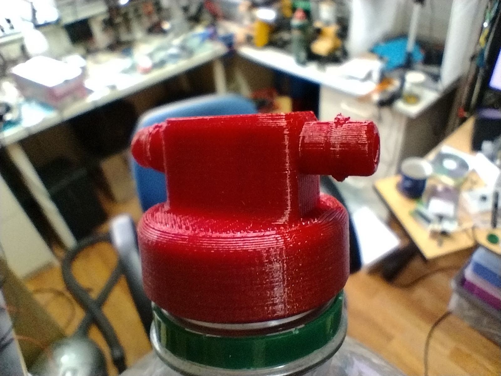

I just made up my own thread profile for 3D printed parts that has 45
degree slopes and a wide crest that are easier to print than 30 degree
pointy ones. It doesn't conform to any standards but it works for me. And
tapered lead-ins, which also work for me. Not quite the same as higbee
because mine start narrow when only the peak is above the minor diameter
and get wider as they get higher. Higbee starts wide and narrows as it gets
higher. Not sure if that works better, or is just more practical to make
when not 3D printing. Because it starts as a wide ramp I could imagine it
jamming on the crest when mis-aligned with the female thread whereas mine
would more likely engage.
When I wanted to print a bottle cap I couldn't find any proper data to feed
into my thread generator but I found a part on Thingiverse that fitted
perfectly when sliced with Cura. A rare thing.
[image: IMG_20220705_091939414.jpg]
