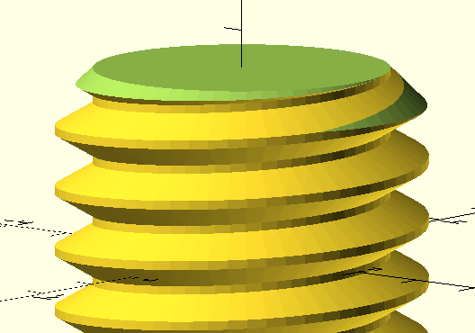

But still the question of optimal thread ends remains.  Look at a jar or
plastic bottle and you will see smooth tapering thread ends, not ends
that run off the end like the picture above.  For example, SP400 threads:
So this seems like a better model for how 3d printed threads should look
than die pressed threads in metal.  We are not constrained---we can make
the thread end in 3d printed models.  And it sounds like that's better
design, so that's what should be done.

         I am not an expert but I think normal machine screws that
         you can buy the thread at the end tapers in diameter, so it
         sort of follows a chamfer. My thread library supports that
         and a simple chamfered end, which is what you get when you
         cut a threaded rod and then chamfer the end.
         Higbee seems to be cutting off the crests of the leading
         treads, making them flat topped. It seems to be a second
         pass on a CNC lathe that uses a flat ended grooving tool to
         remove the sharp crests left by the threading tool when it
         meets the chamfer.

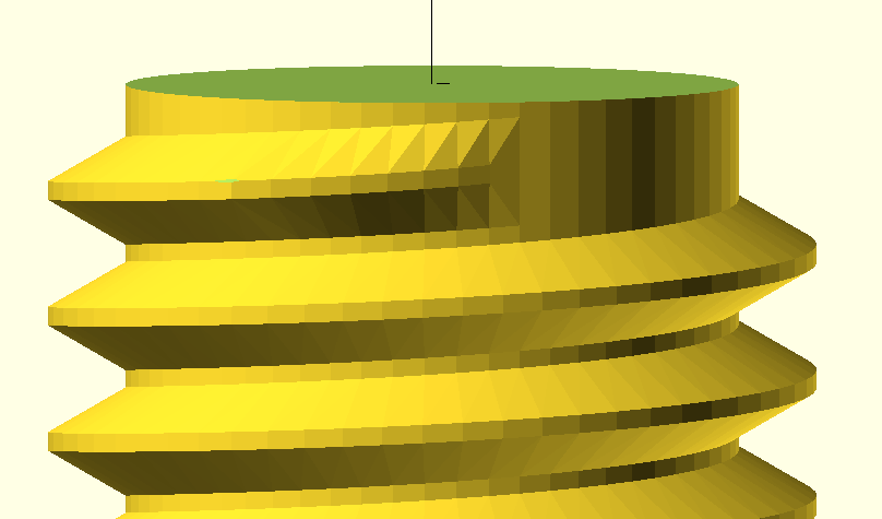

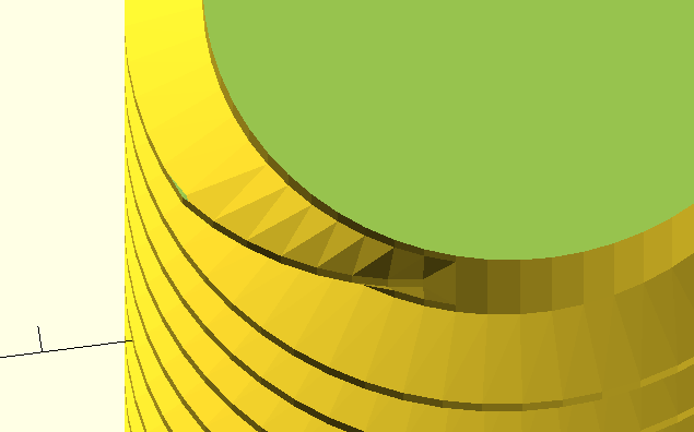

         On Sun, 19 Feb 2023 at 22:11, Adrian Mariano
         <avm4@cornell.edu <mailto:avm4@cornell.edu>> wrote:
             Is there anybody out there who is an expert in threading
             with a deep understanding of how thread ends should be
             formed?   I'm trying to figure out how the higbee ends
             in BOSL2 should work, and I got some feedback from an
             erratic individual who writes once a month that I was
             doing it all wrong.  And I think that he was at least
             partly correct, but without better communication, I'm
             having trouble nailing down how to fix the
implementation.
             So I'm left with a variety of questions about this topic
             and haven't had much luck researching this on line.
             1.  What is the ideal way to terminate threads, given
             that in 3d modeling we aren't constrained by machining
             limitations.   How abruptly should the thread end?
             Should it taper in width?   In short, what exactly
             should BOSL2 do when producing threads?
             2. What kind of thread ends should a threading library
             support more broadly?  Is one type of end enough?  It
             seems like thread ends for plastic bottles taper in a
             different way than the patented higbee.
             3.  What type of thread endings does the term "higbee"
             apply to?  The original patent refers to "blunt ends"
             and the modern nomenclature seems to be to move away
             from "higbee" to "blunt start", but my erratic
             correspondent insisted that any thread end where the
             thread wasn't clipped off by the end of the bold was a
             "higbee" and that the term "higbee" was best.
             4.  How exactly does the higbee thread prevent cross
             threading.  How does cross threading happen?  I guess
             this relates back to #1.  When I was thinking about it I
             got a feeling it had to do with a lack of a fractionally
             wide thread, which can more easily engage at a funny
             angle.  That would suggest that a thread that tapers in
             width would be bad, since it could suffer the same
             problem.  Am I right about that?

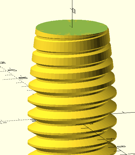

The only comment I can make is not expert, I'm not a pro machinist, just
a retired broadcast engineer. But I have used it many times, I have 4
cnc'ed machines I rebuilt from manual stuff and converted to cnc.
The ability to control the entry and withdraw profiles that LinuxCNC's
G76 canned threading can do, normally used where threading the middle of
a rod to make a bolt or nut, where the single tooth cutter is ramped
from its baseline to the depth of the thread being cut on this pass,
internal thread or external being auto selected by the base line being
inside or or outside of the thread G76 has a length for that, normally
used to give a fraction of a turn profile for the ends of the thread.
Normally used for the entry, aka the right hand end of the thread, the
other end, visualize that as at the underside of a bolts head, is either
subject to a precut groove to give the tool room to withdraw at an
achievable speed. Or you can just let the withdraw ramp out to a bolt
shank diameter withdraw as long as the tool doesn't actually touch the
underside of the head.
But this old Iowa farm kid thinks outside of the box now and then, and
needing a compression method of attaching the drive from the motor,
where an un-machined end of a ball screw is inserted to a slotted sleeve
that is intended to be compressed to grip the screw as effectively as a
weld w/o the distortions you get from the welding heat. The slots, cut
to the depth of the socket drilled, are done with EDM because its very
precise and leaves no burrs to interfere with the fit. So I found I
could make a tapered thread, length of taper cut being one turn less
than the length of the thread, doing the thread ahead of the EDM
slotting, and I made nuts out of stock 3/8" nuts to fit it, both at 50
tpi. On a 7x12 cnc'ed lathe.
It got me the grip I needed, precisely on center with no runout And
never a hint of wanting to cross-thread because the working space was
way to small to get any fingers in to guide it. That was a decade + back
up the log and has not been touched since. So I'll make the claim that a
long enough straight taper cannot be cross threaded. Its self
correcting. I'd assume that characteristic would survive down to a taper
done as a single turn. 1/4 turn ramps I'm less certain of.
This is control you don't get using taps and dies. And its a single data
point from multiple such uses experience. YMMV.

Tapered by making the thread diameter decrease until it is below the minor
diameter and disappears. I do it linearly over half a turn but your bottle
example was much less.
Higbee removes the crests instead because the thread is already formed at
the nominal diameter. It can either ramp down gradually or be completely
removed with a rotary milling tool leaving a short ramp due to the tool
radius. See https://www.youtube.com/watch?v=MUojDLAaBiE

So we can make things better by adding a bevel, which softens the edge,
reducing, but not eliminating that sharp edge.  This is an improvement, but
clearly not optimal.

Here then is the SP400 thread form as we have it in BOSL2.
This is specifically intended to comply with the SP400 standard, which
specifies a runout taper of a vaguely identified length.  This is a
standard for plastic bottle threads.
https://www.isbt.com/threadspecs-downloads.asp
I inspected some screws I have on hand.  The regular screws look like my
second picture: threads with a small bevel at the end.  My wall plate and
other electrical screws do not have the pattern described by Raymond, which
would in essence be a higbee or blunt start end.  Instead they have a much
longer bevel, something like this:
I think this is a cheap way of creating the alignment system Raymond
described.  I suspect that actually doing what Raymond said is too
expensive, because it involves post-processing each screw.  I also think
this is the reason that Jordan's flagpole doesn't work that way: it would
increase the cost of the screws by 10x or more.

Raymond, your focus is on classic fabrication approaches. But I don't care about classic fabrication approaches particularly. The question is what is actually best. When you *really* care, what do you do? First of all, for clarity here are some screw forms. The basic threaded rod has nasty sharp edges: [image: image.png] So we can make things better by adding a bevel, which softens the edge, reducing, but not eliminating that sharp edge. This is an improvement, but clearly not optimal. [image: image.png] The Higbee patent is here: https://patents.google.com/patent/US447775A [image: image.png] And there's a direct implementation. Now the question of what, exactly, qualifies as a Higbee end is not so clear. It seems like one critical part of the patent is that the full thread form is present, so it doesn't reach the end of the shaft. But the exact end? Not sure that this matters. So is a long taper still a higbee? I don't know. It appears that the term "Higbee" has fallen out of favor and if you look in your machinist handbook it will be called "blunt start thread". *Blunt Start Thread*: “Blunt start” designates the removal of the incomplete thread at the starting end of the thread. This is a feature of threaded parts that are repeatedly assembled by hand, such as hose couplings and thread plug gages, to prevent cutting of hands and crossing of threads. It was formerly known as a Higbee cut. https://www.thomasnet.com/articles/machinery-tools-supplies/screw-thread-systems-types-terminology-and-dimensions/ The higbee cut was performed by filing off the incomplete thread at the end that was left by the thread forming process, whatever it was. Clearly nobody is going to make the thread taper in width if they are filing the thread down, so tapering in width isn't even a possibility here. The patent says it's supposed to be "full width". In fact, it seems like full width is maybe important because isn't cross threading enabled by thin, fractional threads? That suggests that maybe tapering in width is undesirable. Here then is the SP400 thread form as we have it in BOSL2. [image: image.png] This is specifically intended to comply with the SP400 standard, which specifies a runout taper of a vaguely identified length. This is a standard for plastic bottle threads. https://www.isbt.com/threadspecs-downloads.asp I inspected some screws I have on hand. The regular screws look like my second picture: threads with a small bevel at the end. My wall plate and other electrical screws do not have the pattern described by Raymond, which would in essence be a higbee or blunt start end. Instead they have a much longer bevel, something like this: [image: image.png] I think this is a cheap way of creating the alignment system Raymond described. I suspect that actually doing what Raymond said is too expensive, because it involves post-processing each screw. I also think this is the reason that Jordan's flagpole doesn't work that way: it would increase the cost of the screws by 10x or more. So Raymond said, "whatever you do it'll be wrong some of the time". I think I disagree. The only way that's true is when you're trying to model to match some specific specification, like you WANT to show a bad screw the way screws are actually made. I think that in fact there should be an optimal screw form that will not be wrong, and that's what I should produce by default. The only way I can see this not being true is if somehow the ideal screw form varies radically with material. My correspondent seemed to think that the term higbee was "well known" and that it made sense to use it as the parameters in the library. I'm not sure sure, though threadlib does also use the term higbee for its tapering thread ends. Searching for information on higbee doesn't turn up tons of material. On Mon, Feb 20, 2023 at 11:50 AM Raymond West <raywest@raywest.com> wrote: > > On 19/02/2023 22:09, Adrian Mariano wrote: > > Is there anybody out there who is an expert in threading with a deep > > understanding of how thread ends should be formed? > > It depends somewhat on the the way the bolt or stud is manufactured, and > its final application. For example, the screws that hold a switch plate > to the wall box, will have a short length at core diameter, so that it > can 'find' the tapped hole in said box, and allow the bolt to be > straight, thus avoiding cross threading. > > If threading a bar in a lathe, it is usual to bevel the end, and remove > sharp edges with a file, say, or if a quantity of them, by tumbling. > > For common, mass produced thread-rolled bolts, the rolling process does > not normally leave sharp edges at the bolt end (and the end is recessed, > unless shaped for a specific application, e.g, shaft locking socket > screws.) > > Bottles and caps, also have to be easily removed from the mould. there > is usually a 'skirt' on the cap, and a short plain end of the top, to > allow it to be more easily aligned. > > Large diameter, fine pitches are easy to cross thread, if you do not > know the technique, (for example the threads those holding a wheel hub > to the vehicle axle (and some hubs on some vehicles, often have lh > threads, to add to the novices fun...) > > I've never heard of Bigbee, I think it is merely the manufacturer of > bolts/machinery, like GKN. Not mentioned in my 1990 Machinery handbook, > so get the guy to send you a decent drawing. > > Whatever single solution you use, it will be wrong for many applications. > > _______________________________________________ > OpenSCAD mailing list > To unsubscribe send an email to discuss-leave@lists.openscad.org >
Mon, Feb 20, 2023 10:27 PM
So lineiar decrease in diameter of the thread?  Something like this?  I
have two views for clarity:
Why would you want to extend the taper for a full half-turn.  My
correspondent was a little self-inconsistent, but suggested a much
shorter length, and it seems like a shorter length is better.  In fact, I
wonder if really very short is best.  Doesn't the section where the
diameter of the thread is reduced enable you to hop over it to
crossthread?  It seems like the abrupt end of the threads is the key to
success here:  you can't hop into the next thread because you have a full
thread in the way.  That's why I wonder if tapering is even a good idea as
compared to a more abrupt stop.  On the other hand, maybe the bottle makers
know what they're doing?  Their standard doesn't specify this, but in
their drawings it looks like about a quarter of a right angle, so ~20
degrees.  My correspondent seemed to think it should depend on the pitch
size of the threads, and nothing to do with angle, though.
minor diameter and disappears. I do it linearly over half a turn but your
bottle example was much less.

On Mon, 20 Feb 2023 at 21:49, Adrian Mariano avm4@cornell.edu wrote:
So "simply tapered" is not well-defined.  Tapered how, and over what
length?  In both directions or just one?  And why is that clearly
optimal.
