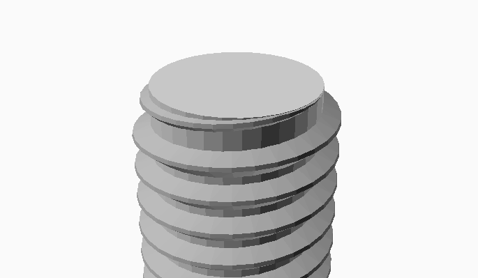

I looked for info on how screws are made and it sounds like the normal way
is indeed to press them between a pair of flat dies.  This process could
not make a higbee end.
https://www.wuerth-industrie.com/web/media/en/pictures/wuerthindustrie/technikportal/dinokapitel/Kapitel_04_DINO_techn_Teil.pdf
https://www.accu.co.uk/p/105-how-is-a-machine-screw-made
Second link has a video of a factory.  I guess the chamfer on the end is
included in the die?

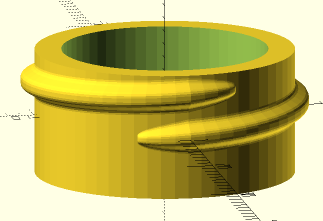

But still the question of optimal thread ends remains.  Look at a jar or
plastic bottle and you will see smooth tapering thread ends, not ends that
run off the end like the picture above.  For example, SP400 threads:
So this seems like a better model for how 3d printed threads should look
than die pressed threads in metal.  We are not constrained---we can make
the thread end in 3d printed models.  And it sounds like that's better
design, so that's what should be done.

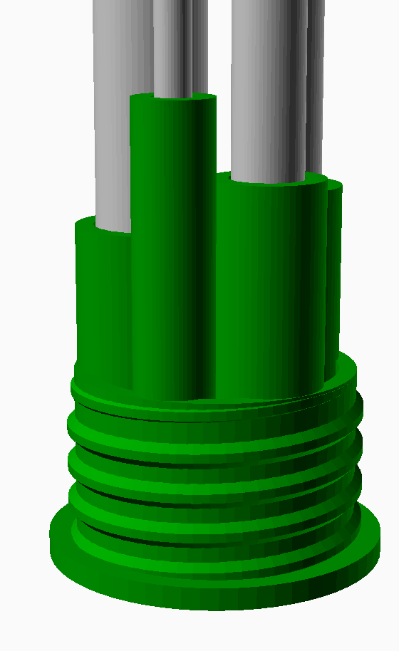

That bottle thread is just tapered off much faster and then doesn't go
right to the end of the tube. I think my library does it over half a turn.
Here is a drill case I printed and it never cross threads.
It is different with fine thread in metal though as it is much easier to
cross thread if say you put a steel screw into brass.
