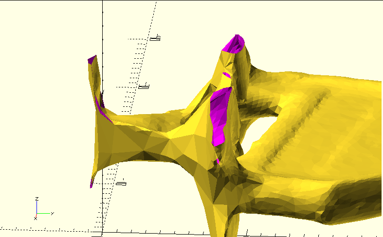

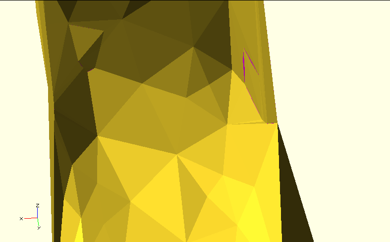

Fri, Jul 12, 2024 4:05 PM
I'm not an expert at diagnosing STLs, but this one isn't hard to find
problems with, using View/Thrown Together.
The un-fixed version has great gaping holes in the top and bottom, and
smaller problems elsewhere.  (Purple is bad.)
The "fixed" version is much better, but still has some - and all it
takes is one.  Here's a wide shot to establish context, and then a
zoom-in on the central pillar.  Note the tiny purple slices on the right.
