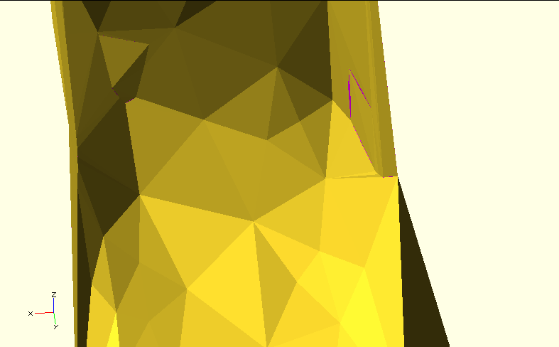

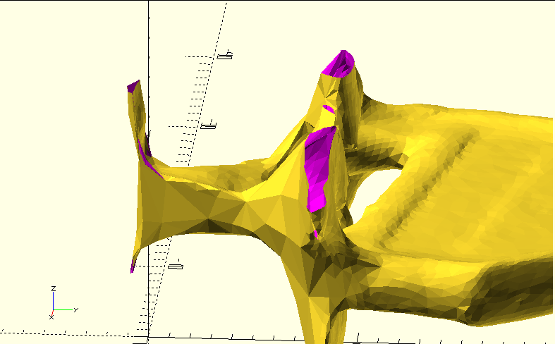

On Fri, 12 Jul 2024 at 17:05, Jordan Brown openscad@jordan.maileater.net
I'm not an expert at diagnosing STLs, but this one isn't hard to find
problems with, using View/Thrown Together.
The un-fixed version has great gaping holes in the top and bottom, and
smaller problems elsewhere.  (Purple is bad.)
The "fixed" version is much better, but still has some - and all it
takes is one.  Here's a wide shot to establish context, and then a zoom-in
on the central pillar.  Note the tiny purple slices on the right.

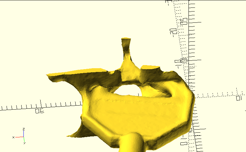

Thanks,
What I did is used Meshmixer, which cut off the messy part of the model (in
terms of shape that I don't want to print and any holes that are present).
I then re-added the part of the handle that you hold with your fingers in
OpenSCAD and it all rendered well.
Thank you,
Richard.
