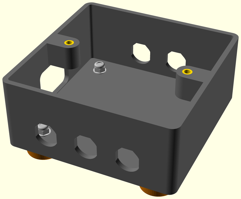

Another aspect to this is frameworks. My own library is set up for
automation with Python scripts. It makes BOMS, stl files, dxf files,
assembly diagrams and build documentation like the Mendel90 build manual,
which was largely manual but is now automated  for every new project I make
using Markdown fragments in the OpenSCAD comments.. For that to work it has
lots of conventions and a very particular coding style. For example any
module that makes and stl must be called something_stl() and call a module
stl("something"). Then it appears on the BOM, gets generated automatically
and rendered for the build instructions.
For example this code:
//! * Attach the four feet using 10mm M3 dome screws, washers above and
below and nyloc nuts
module feet_assembly()
assembly("feet") {
base_assembly();
foot_positions()
    foot_assembly(base_thickness, foot);

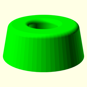

Generates this:
Feet AssemblyVitamins
QtyDescription
8 Washer M3 x 7mm x 0.5mm
4 Screw M3 dome x 10mm
4 Nut M3 nyloc3D Printed parts
4 x foot.stl
[image: foot.png]

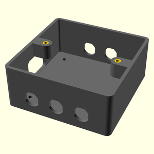

Sub-assemblies
1 x base_assembly
[image: base_assembled_tn.png]
Assembly instructions
[image: feet_assembly.png]
  • Attach the four feet using 10mm M3 dome screws, washers above and
[image: feet_assembled.png]
