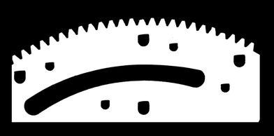

I'm struggling with getting the gears to work out correctly. I've
provided a test jig, below; the scan of the part is overlaid with the
[red] gear design that I am playing with.
I keep fiddling with the number of teeth and the mm_per_tooth, but when
I get the tooth spacing right, the radius of the generated gear does not
match the radius of the part.  Any insights would be appreciated.
The library comes from here: https://www.thingiverse.com/thing:5505
The PNG file comes from here: http://www.jonbondy.com/scan0001.png

The part I'm trying to duplicate looks like this:
http://www.jonbondy.com/scan0001.jpg
I ended up scanning it so that I could try to take off the dimensions
more accurately (the original scan is much higher resolution).
Now I want to lay the scan under my part, in OpenSCAD, so that I can
manipulate the design until it conforms to the scan.
Best I can do is surface() the scan file as a PNG.
I wonder how often it would be useful to put an image file down just as
a template
You can generate models directly from images, see attached generated
OpenSCAD script generated from a manipulated version of your file. I can
also generate a similar AngelCAD script from the same image, the
resulting STL is essentially the same.
To make it really useful you need to use the higher resolution image.
The high contrast background is very important, black on white is the
right way to go (or white on black). You also have to pay close
attention to shadows, try to eliminate them as much as possible. A
flatbed scanner can be a good tool. It is also important to have a
margin around the model on all sides.
I took your image and sized it up, manipulated gamma to improve the
contrast, added a margin, made a negative and reduced the color depth to
2 colors only. The result is shown in the attached small thumbnail.
From the larger version of that image, the .scad file was created. If
you have high resolution scan conforming to the above requirements
(never mind the image processing), the complete gear can probably be made.

I scanned the object at high resolution on my scanner, but the light
source was to one side, so there are shadows.  I'm not sure how to
eliminate them other than to photograph the object using a circular
light source.
And the reason I am making a 3D printed copy is that some of the teeth
were ruined, so even if I could take a perfect scan, the resulting
OpenSCAD object would just be equally flawed.
I would prefer to actually model it, so I can modify it.

My cheap flatbed scanner does a decent job since the light source it
very close. But the object has to be reasonably flat on one side and you
have to do a bit of image processing anyway so it isn't simply a
one-button-push process, but if you know what you are doing it can
sometimes be done successfully.
I agree you would want to model it, for the reasons you give. But a
model generated from a scan can still be useful as a reference, you can
for example subtract your model from the scan-model to see if the teeth
and holes line up properly without having to print and discover they
don't :-)

From what I can tell your main problem is the lack of a systematic approach.
I think fiddling with the parameters and hoping to get it right is a recipe
for frustration.  I used the following method:  I located the center base of
the two edge teeth, and the center base of a middle tooth.  I used those 3
points to draw an arc (using the arc function from BOSL2) and I added a line
to the BOSL2 code to display the center, radius and arc angle.  Then I put a
point at the tooth tip and computed the tooth height and adjusted the radius
by half that amount to get the appropriate circle that defines the gear (the
circle at the midline of the teeth).  Then I computed the number of teeth
based on the angle of the arc, and finally the mm_per_tooth value based on
the circumference and the number of teeth.  I think it looks reasonably
decent for a first effort.  I compare it here to the model Carsten posted,
scaled to be 120mm wide, since that seemed to be your scale.  The scad file
is attached.

In the end, I managed to come up with gear parameters that matched the
part, more or less.  Basically, I set the tooth width to match the part
and increased the number of teeth to control the radius.  A little bit
of tweaking got it pretty close.  I'm printing a test part now.
is attached.

I'm almost there.  Everything lines up, except that the gear teeth are
about 50% too short.  Any ideas?  Again, I'm using this gear library:
part and increased the number of teeth to control the radius. A little
bit of tweaking got it pretty close.  I'm printing a test part now.

The code I posted used that very same library and made teeth that appear
exactly the right length.  Did you try that?  If it doesn't work, it seems
like it must mean the template is wrong.
You don't indicate what parameters you're actually using so it's pretty hard
to guess what's wrong with your model.
