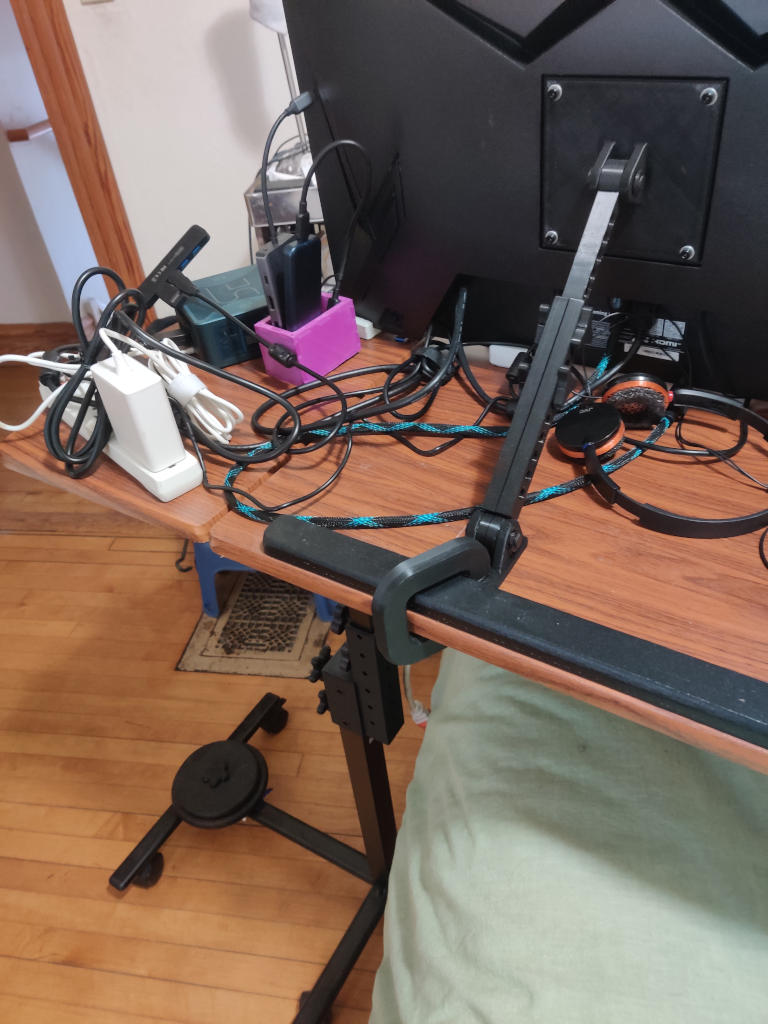

But I have come to the personal conclusion that I should stop printing
bolts.
I've got fairly assortment boxes of threaded inserts in a variety of
lengths and diameters from M2 to M5 and assortments of small bolts, set
screws and screws with a variety of heads and diameters mostly M5 and
smaller.  But as sizes increase my parts on hand are increasingly limited
due to the cost of acquiring stock and the cost in space and time of
keeping stock stored, sorted and readily accessible.  In my smaller sizes I
also have gaps in my collection where I used all of the items of a
particular type and size in an assortment and have yet to bother replacing
them.  Printing may be more fuss than searching for and using a part I
might have on hand but it can be easier than using parts which aren't
exactly what one wants and faster than shopping to get the right part.  I
also like being able to make custom parts such as the thumbwheel bolts and
nuts seen here on the 3d printed adjustable monitor arm, the printed
adjustable desk height riser,  the very short fat bolt used to secure the
counter weights on the base and the one hidden from view securing the
underside of the C clamp at the base of the monitor arm:
[image: bed_desk_1024.jpg]

I often trap a hex head bolt in a 3D printed thumbwheel.
printing bolts.
set screws and screws with a variety of heads and diameters mostly M5
and smaller.  But as sizes increase my parts on hand are increasingly
limited due to the cost of acquiring stock and the cost in space and
time of keeping stock stored, sorted and readily accessible.  In my
smaller sizes I also have gaps in my collection where I used all of
the items of a particular type and size in an assortment and have yet
to bother replacing them.  Printing may be more fuss than searching
for and using a part I might have on hand but it can be easier than
using parts which aren't exactly what one wants and faster than
shopping to get the right part.  I also like being able to make custom
parts such as the thumbwheel bolts and nuts seen here on the 3d
printed adjustable monitor arm, the printed  adjustable desk height
riser,  the very short fat bolt used to secure the counter weights on
the base and the one hidden from view securing the underside of the C
