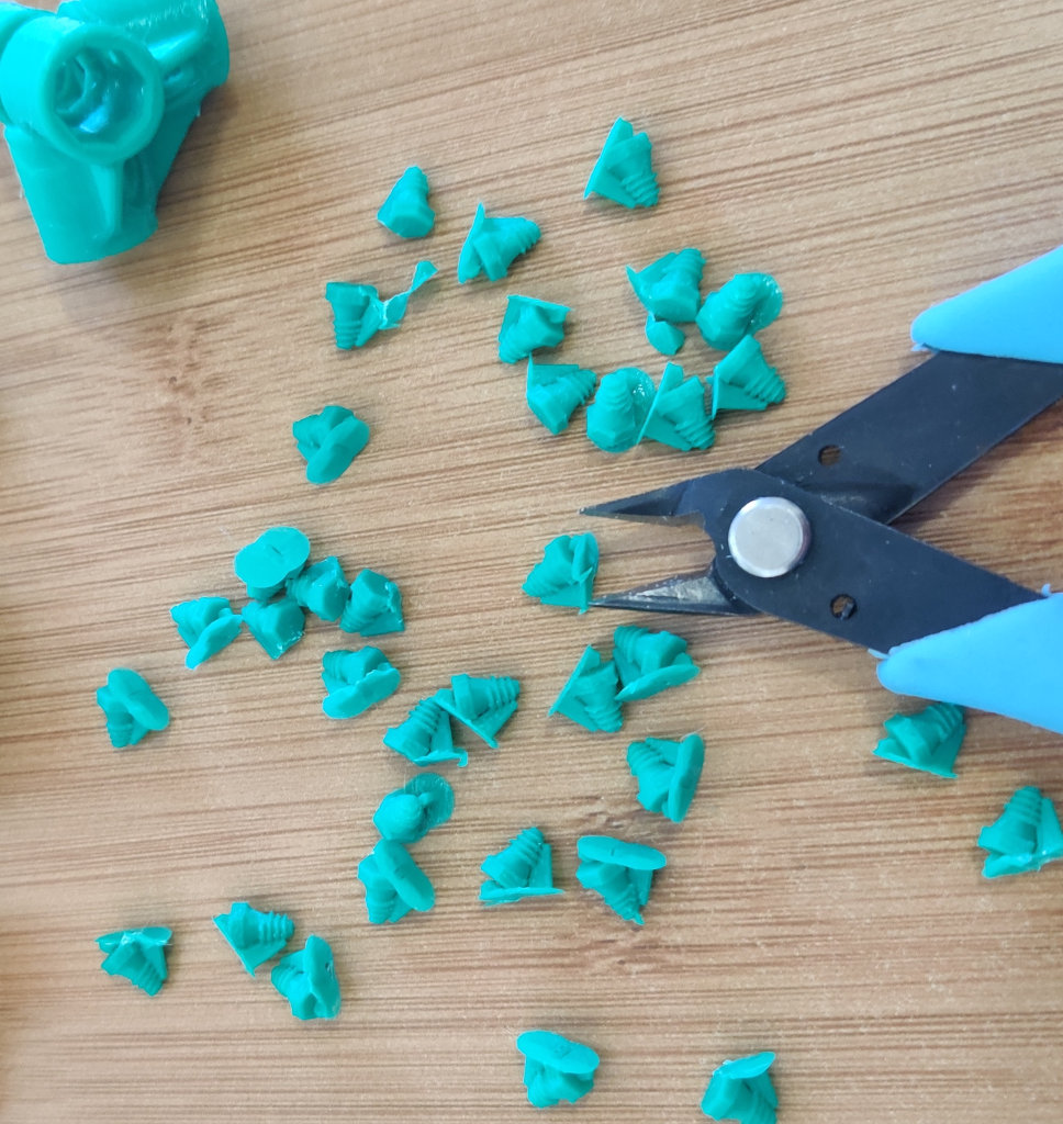

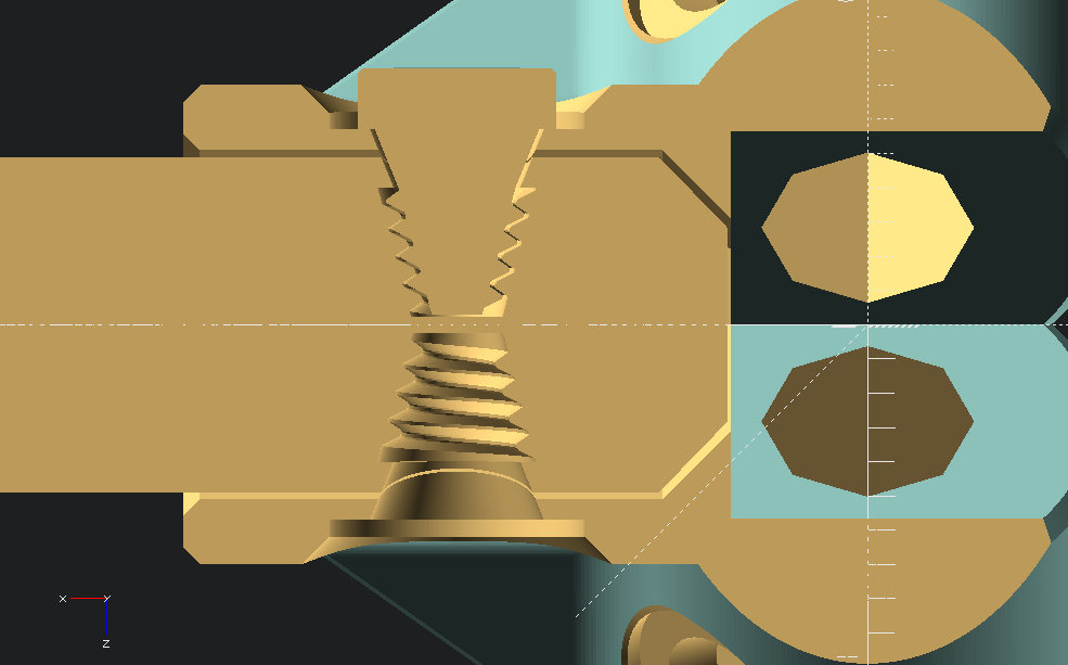

[image: MiniScrews.jpg][image: DryBox.jpg][image: assembly.jpg]
