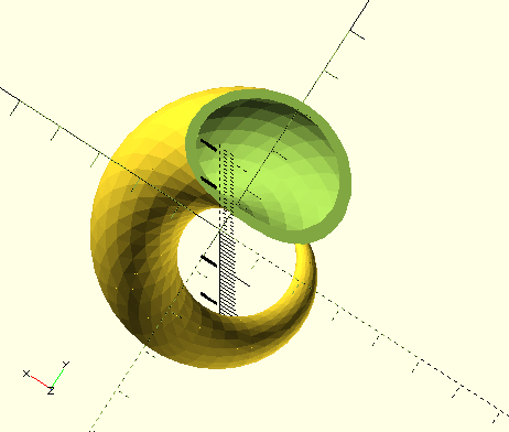

Here is a way to make a horn by moving a circle along the winded horn path.
This uses chain hull.
It has a comparable resolution, but has less than 20000 elements.
Thus it takes 8 sec. for a F5 on my netbook (1ghz). But a F6 is,as of yet,
unresponsive.

Here is a way to make a horn by moving a circle along the winded horn path. This uses chain hull. It has a comparable resolution, but has less than 20000 elements. Thus it takes 8 sec. for a F5 on my netbook (1ghz). But a F6 is,as of yet, unresponsive. ​ // extrudepathhullv0_1 // GPLv2 // (c) 2013 TakeItAndRun // // v0_1: // //******************************************************* // // basic definitions // //******************************************************* // circle (and sphere) have $fn facets $fn=20; //******************************************************* // // definition of path // //******************************************************* // number of steps along path tstep=40; // start and end point tmin=-.1; tmax=1; base=0; // path to extrude along //function x(t)=[ // t, // t*abs(sin(t)), // t*cos(t) //]; //function x(t)=[ // (1+3*t)*sin(360*t), // (1+3*t)*cos(360*t), // 10*t //]; function x(t)=[ 18*sin(360*t), 18*cos(360*t), base + 360*t/3 ]; // scale s_min=0.00001; function s0(t)=1*(tmax-t)/tmax; //function s0(t)=1-t/(tmax-tmin); function s(t)=(abs(s0(t))<=s_min)?s_min:s0(t); // twist //function twist(t)=1*360*t/(tmax-tmin); function twist(t)=0; // small number to avoid colinear faces e=0.02; //******************************************************* // // routines // //******************************************************* module extrude_path_hull(tmin=tmin,tmax=tmax,tstep=tstep){ dt=(tmax-tmin)/tstep; for(t=[tmin:dt:tmax]){ // echo("t:",t,t+dt); // echo("x:",x(t),x(t+dt)); // echo("s0:",s0(t),s0(t+dt)); // echo("s:",s(t),s(t+dt)); // color([t/(tmax-tmin),1-t/(tmax-tmin),0 ]) hull(){ // (I dont call place(t) here as it still produces a 'child' error in version 2013.03.09. Later version will enable recursion here) translate(x(t)) rotate([0,0,a1(t)]) rotate([0,90-a2(t),0]) rotate([0,0,twist(t)]) scale(s(t)) child(); translate(x(t+dt)) rotate([0,0,a1(t+dt)]) rotate([0,90-a2(t+dt),0]) rotate([0,0,twist(t+dt)]) scale(s(t+dt)) child(); } } // place the extruded shape at the position x(t) and // rotate it so that is normal to thepath module place(t){ translate(x(t)) rotate([0,0,a1(t)]) rotate([0,90-a2(t),0]) rotate([0,0,twist(t)]) scale(s(t)) child(); } // distance between points x(t) and x(t+dt) projected onto the xy-plane function dxy(t)=sqrt( pow(x(t+dt)[0]-x(t)[0],2)+ pow(x(t+dt)[1]-x(t)[1],2) ); // angle between x-axis and projection of dx(t) onto the xy-plane function a1(t)=atan2(x(t+dt)[1]-x(t)[1],x(t+dt)[0]-x(t)[0]); // angle between xy plane and dx(t) vector function a2(t)=atan2(x(t+dt)[2]-x(t)[2],dxy(t)); } module shape(){ // the shape is linear_extruded by small value e, as hull() can only // work with objects that are not in the same (xy-) plane, if these objects are 3d-objects // (it can work with to 2d shapes, but they are by definition in the same (xy-) plane) // Because of this the extruded object is actually extending at both ends by e/2 over the end of the path linear_extrude(height=e,center=true) hull(){ translate(1*[1,0])circle(r=1); translate(-1*[1,0])circle(r=1); } } module shape2outer(){ cylinder(r=14,h=e); } module shape2inner(){ cylinder(r=12,h=e); } //******************************************************* // // main program // //******************************************************* difference(){ extrude_path_hull()shape2outer(); extrude_path_hull()shape2inner(); // cut off anything below the base translate([-50, -50, -100]) cube([100, 100, 100]); }

F6 takes 12 min.

Peter:
Wow!  Under 1 second for F5 on my machine, and resulting in an object
that is easily viewable.  Kudos.
I gather that this is a framework that you use often to create shapes
like this?  I saw remnants of other functions that had been commented out.
Your code is copyrighted: may I use it to create shapes?
Thanks again. This group is the greatest!
module place(t){
translate(x(t))
rotate([0,0,a1(t)])
scale(s(t))
child();
module shape(){
same (xy-) plane)
hull(){
cylinder(r=14,h=e);
cylinder(r=12,h=e);
// main program
Checked by AVG - www.avg.com http://www.avg.com
Version: 2015.0.6037 / Virus Database: 4365/10128 - Release Date: 06/30/15

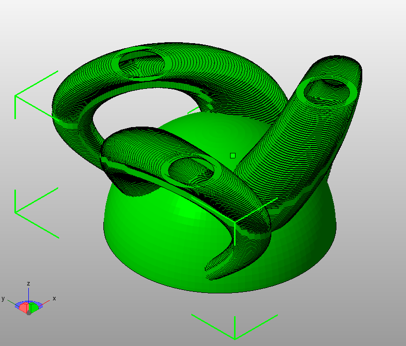

Michael:
I got cute, and had the horns go up and then down.  This is the result.
Any hints about how to orient the cylinders so that they are normal to
the path?

Michael: I got cute, and had the horns go up and then down. This is the result. Any hints about how to orient the cylinders so that they are normal to the path? Jon On 6/30/2015 6:20 AM, MichaelAtOz wrote: > This is a bit more manageable > > > // based on horns design by Jon Bondy > // http://forum.openscad.org/Two-annoyances-td12935.html > // > // Modified my MichaelAtOz on the OpenSCAD forum http://forum.openscad.org/ > // My modifications are in the public domain. > // Fewer faces, a little more responsine in F5 preview > > rch = 0.1; > > base = 0; // height where base ends and sculpture starts > maxA = 360; > step=2; > thick=2; > sphereFn=24; > > // this could be refined by minkoswki-ing alternat layers. > // Processing intense tho. > > module OuterHorn() { > for (a = [0:step:maxA]) { > translate([18*sin(a), 18*cos(a), base + a/3]) > if (a<maxA) > cylinder(r=thick+(maxA-a)/30 > , h=step+0.1, $fn = sphereFn, center=true); > else > // this is a hack and needs improvement, works for now > intersection() { > translate([0,0,thick*0.9]) > cube([thick*2,thick*2,thick*2],center=true); > scale([1,1,0.6]) > sphere(r=thick, $fn = sphereFn, center=true); > } > }; > } > > module InnerHorn() { > for (a = [0:step:maxA]) { > translate([18*sin(a), 18*cos(a), base + a/3]) > cylinder(r=(maxA-a)/30, h=step+0.1, $fn = sphereFn, center=true); > }; > } > > module Horn() { > difference() { > OuterHorn(); > translate([0,0,-0.1]) > InnerHorn(); > } > } > > Horn(); > > > About 4 min for F6 on my old system. > > > > ----- > Unless specifically shown otherwise above, my contribution is in the Public Domain; To the extent possible under law, I have waived all copyright and related or neighbouring rights to this work. This work is published globally via the internet. :) Inclusion of works of previous authors is not included in the above. > > The TPP is no simple “trade agreement.” Fight it! http://www.ourfairdeal.org/ > -- > View this message in context: http://forum.openscad.org/Two-annoyances-tp12935p12948.html > Sent from the OpenSCAD mailing list archive at Nabble.com. > > _______________________________________________ > OpenSCAD mailing list > Discuss@lists.openscad.org > http://lists.openscad.org/mailman/listinfo/discuss_lists.openscad.org > > > ----- > No virus found in this message. > Checked by AVG - www.avg.com > Version: 2015.0.6037 / Virus Database: 4365/10128 - Release Date: 06/30/15

jon_bondy wrote > After I press F5, the Console says that it has completed the computation > in under a second, but it takes about 5 seconds for the rendering to > take place. This is mildly annoying, but what is really annoying is > that for the next minute or so, the cursor alters between normal and > hourglass every 5 or 10 seconds. It is as if it thinks I asked for an > adjustment in the rendered view, but I have not. Given how long the > rendering takes, this is very time consuming. Yeh, I had noted that too, very annoying. I suspect the refresh is under Qt control. You need to keep you mouse cursor out of the display window. That is the display driver latency when a high poly count AFAIK. > I got cute, and had the horns go up and then down. This is the result. > Any hints about how to orient the cylinders so that they are normal to > the path? No sorry, I would have to redo my high school maths, that makes my brain hurt... ----- Unless specifically shown otherwise above, my contribution is in the Public Domain; To the extent possible under law, I have waived all copyright and related or neighbouring rights to this work. This work is published globally via the internet. :) Inclusion of works of previous authors is not included in the above. The TPP is no simple “trade agreement.” Fight it! http://www.ourfairdeal.org/ -- View this message in context: http://forum.openscad.org/Two-annoyances-tp12935p12974.html Sent from the OpenSCAD mailing list archive at Nabble.com.
PF
Peter Falke
Thu, Jul 2, 2015 10:18 AM
With my program the shapes are always placed normal to the path.
Just give me the math you used for the path.
2015-07-02 5:00 GMT+02:00 MichaelAtOz oz.at.michael@gmail.com:

With my program the shapes are always placed normal to the path. Just give me the math you used for the path. 2015-07-02 5:00 GMT+02:00 MichaelAtOz <oz.at.michael@gmail.com>: > jon_bondy wrote > > After I press F5, the Console says that it has completed the computation > > in under a second, but it takes about 5 seconds for the rendering to > > take place. This is mildly annoying, but what is really annoying is > > that for the next minute or so, the cursor alters between normal and > > hourglass every 5 or 10 seconds. It is as if it thinks I asked for an > > adjustment in the rendered view, but I have not. Given how long the > > rendering takes, this is very time consuming. > > Yeh, I had noted that too, very annoying. I suspect the refresh is under Qt > control. > You need to keep you mouse cursor out of the display window. > That is the display driver latency when a high poly count AFAIK. > > > > I got cute, and had the horns go up and then down. This is the result. > > Any hints about how to orient the cylinders so that they are normal to > > the path? > > No sorry, I would have to redo my high school maths, that makes my brain > hurt... > > > > ----- > Unless specifically shown otherwise above, my contribution is in the > Public Domain; To the extent possible under law, I have waived all > copyright and related or neighbouring rights to this work. This work is > published globally via the internet. :) Inclusion of works of previous > authors is not included in the above. > > The TPP is no simple “trade agreement.” Fight it! > http://www.ourfairdeal.org/ > -- > View this message in context: > http://forum.openscad.org/Two-annoyances-tp12935p12974.html > Sent from the OpenSCAD mailing list archive at Nabble.com. > > _______________________________________________ > OpenSCAD mailing list > Discuss@lists.openscad.org > http://lists.openscad.org/mailman/listinfo/discuss_lists.openscad.org > -- stempeldergeschichte@googlemail.com <karsten@rohrbach.de> P.S. Falls meine E-Mail kürzer ausfällt als Dir angenehm ist: Ich probiere gerade aus kurze Antworten statt gar keine Antworten zu schreiben. Wenn Du gerne mehr lesen möchtest, dann lass es mich bitte wissen. P.S. In case my e-mail is shorter than you enjoy: I am currently trying short replies instead of no replies at all. Please let me know, if you like to read more. Enjoy!
Thu, Jul 2, 2015 1:24 PM
Peter:
As much as I appreciate your approach, it turned out that I needed the
approach that subtracted an InnerHorn from the InnerHorn, in order to
clean up some other geometry (punching a hole through the base/stand).
I suppose I can try to meld your normals and Michael's cylinders...
