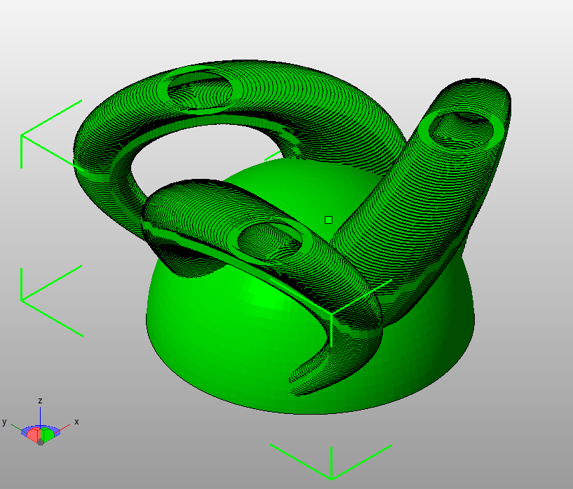

After I press F5, the Console says that it has completed the computation
in under a second, but it takes about 5 seconds for the
 rendering to
take place.  This is mildly annoying, but what is really
 annoying is
that for the next minute or so, the cursor alters between
 normal and
hourglass every 5 or 10 seconds.  It is as if it thinks I asked
 for an
adjustment in the rendered view, but I have not. Given how long the
rendering takes, this is very time consuming.
 Yeh, I had noted that too, very annoying. I suspect the refresh
 is under Qt
 control.
 You need to keep you mouse cursor out of the display window.
 That is the display driver latency when a high poly count AFAIK.
I got cute, and had the horns go up and then down. This is the
 result.

I have been keeping my cursor out of the display window, but even so,
the thing redraws perhaps 5 times before anything useful appears.  So I
sit there for 2-3 minutes waiting for the display to appear.  If I click
on the icon to display the full object, that takes another 2-3 minutes
of repeated displays.
Something is really wrong.  I mean, other than the fact that my
particular model has a lot of triangles.

Why do you want so many triangles, anyway?
What is the resolution you need in the end?
I dont have your code, but it looks to me, that you just union a lot of
cylinders together. That always be slow.
If you would use a chain hull algorithm, you can use much less cylinders
and still get a smooth surface.
You just cant brute force everything in OpenScad.
You also may have a lock at the sweep algorithm, that is super fast for
these things.
https://github.com/openscad/list-comprehension-demos
Share your code and we can give you some pointers.

I think that one reason I avoid Sweep is because there is no
documentation that I can find, and the code has no comments at all. It
may be obvious to some of you, but not to me.  It is pure majick.
For example, in sweep-path, a function f() is defined, which appears to
define a path through 3D space.  Fine.  Why does the shape rotate as it
is swept out?  What is controlling that?
I guess that the shape() is 2D (because it only has pairs of
coordinates) but it is not in any format that I know about (no
triangles, no faces).  How does it work?
Does it really have to be so obscure?

there is no documentation
It is a user space function, not part of OpenSCAD. Hopefully the author may
be listening...
It may be obvious to some of you
No, generally over my head, I have to look at it carefully.
in sweep-path, a function f() is defined, which appears to define a path
through 3D space.
Why does the shape rotate as it is swept out?
Got me. I suspect tangent_path() is involved.
I guess that the shape() is 2D (because it only has pairs of coordinates)
but it is not in any format that I know about (no triangles, no faces).

Yes it is a 2D shape. Note line 36 shape3d = to_3d(shape); in sweep.scad -
I have not looked at to_3D yet.
But note polygon just takes a list of points, path is optional if the points
are in order.
I suppose it could use some comments, but it is user content. So enjoy what
you have ??
through 3D space.
How does it work?
are in order.
you have ??

I think that one reason I avoid Sweep is because there is no documentation that I can find, and the code has no comments at all.  It may be obvious to some of you, but not to me.  It is pure majick.
sweep() is merely an experiment/demo to help figure out how a built-in sweep function should look like. It was hacked together mostly by Oskar Linde, and packaged into the demo repository by me.
It’s made public so that people can play with it and people who are interested in digging deep can do so.
-Marius
