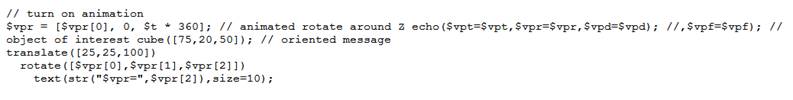

Tue, Oct 20, 2020 10:33 PM
Caddiy wrote
So it's got some built-in errors, right?
Not sure what you mean?
Every so often emails from the forum lose line breaks, I don't know where it
happens.
e.g. This is what I got:
// turn on animation
$vpr = [$vpr[0], 0, $t * 360]; // animated rotate around Z
echo($vpt=$vpt,$vpr=$vpr,$vpd=$vpd); //,$vpf=$vpf); // object of interest
cube([75,20,50]); // oriented message
translate([25,25,100])
rotate([$vpr[0],$vpr[1],$vpr[2]])
text(str("$vpr=",$vpr[2]),size=10);
Caddiy wrote > So it's got some built-in errors, right? Not sure what you mean? Every so often emails from the forum lose line breaks, I don't know where it happens. e.g. This is what I got: > // turn on animation > $vpr = [$vpr[0], 0, $t * 360]; // animated rotate around Z > echo($vpt=$vpt,$vpr=$vpr,$vpd=$vpd); //,$vpf=$vpf); // object of interest > cube([75,20,50]); // oriented message > translate([25,25,100]) > rotate([$vpr[0],$vpr[1],$vpr[2]]) > text(str("$vpr=",$vpr[2]),size=10); ----- OpenSCAD Admin - email* me if you need anything, or if I've done something stupid... * on the Forum, click on my MichaelAtOz label, there is a link to email me. Unless specifically shown otherwise above, my contribution is in the Public Domain; to the extent possible under law, I have waived all copyright and related or neighbouring rights to this work. Obviously inclusion of works of previous authors is not included in the above. -- Sent from: http://forum.openscad.org/
