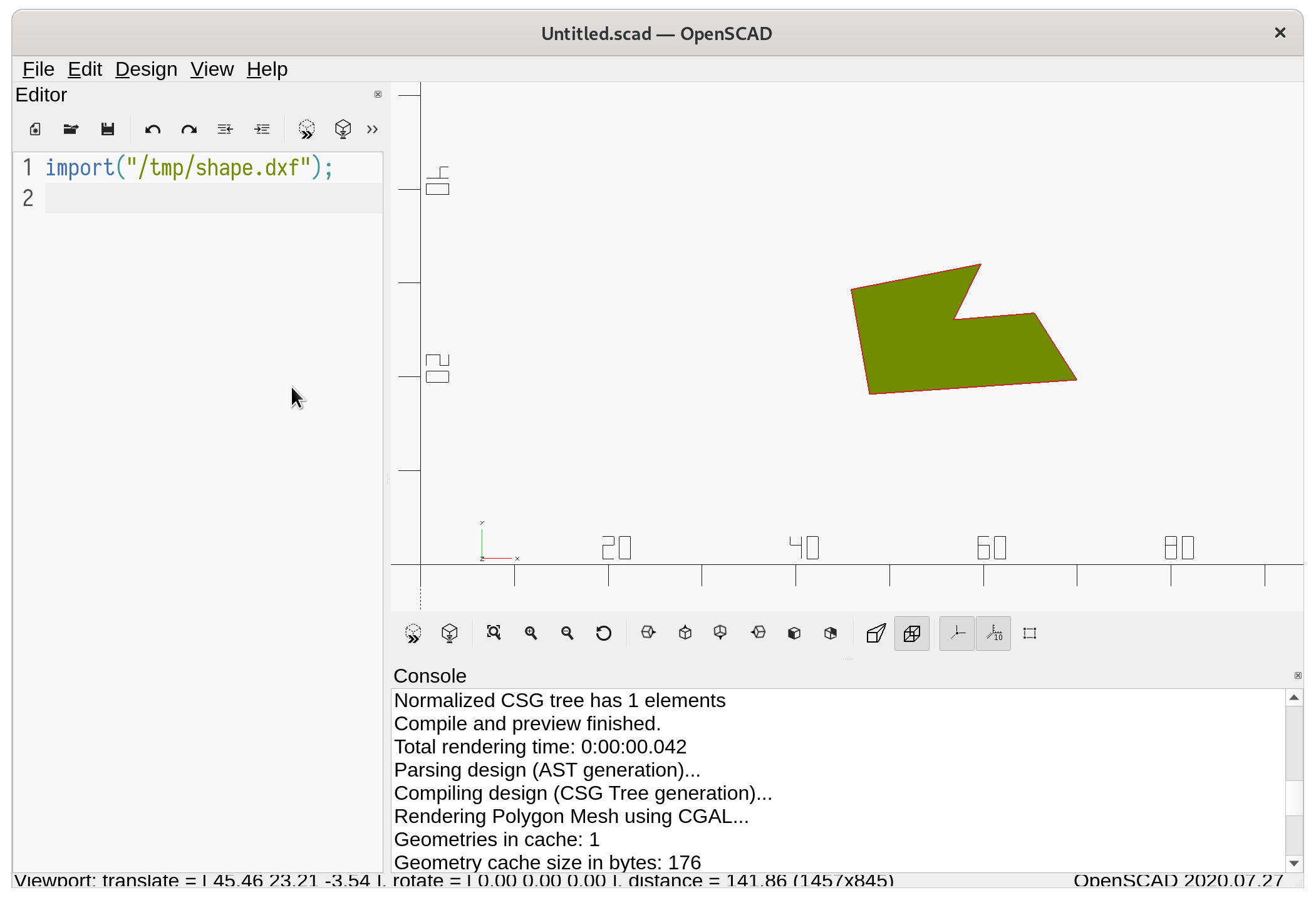

So. for shape.dxf - openscad reports
WARNING: Unsupported DXF Entity 'SEQEND' (1) in
"c:/users/ray/desktop/shape.dxf".
WARNING: Unsupported DXF Entity 'POLYLINE' (1) in
WARNING: Unsupported DXF Entity 'VERTEX' (7) in
but the shape could not be much simpler. Within  designcad, I've no idea
how to not have polylines, vertexes, etc. , but I have not looked into
the dxf format in any detail.

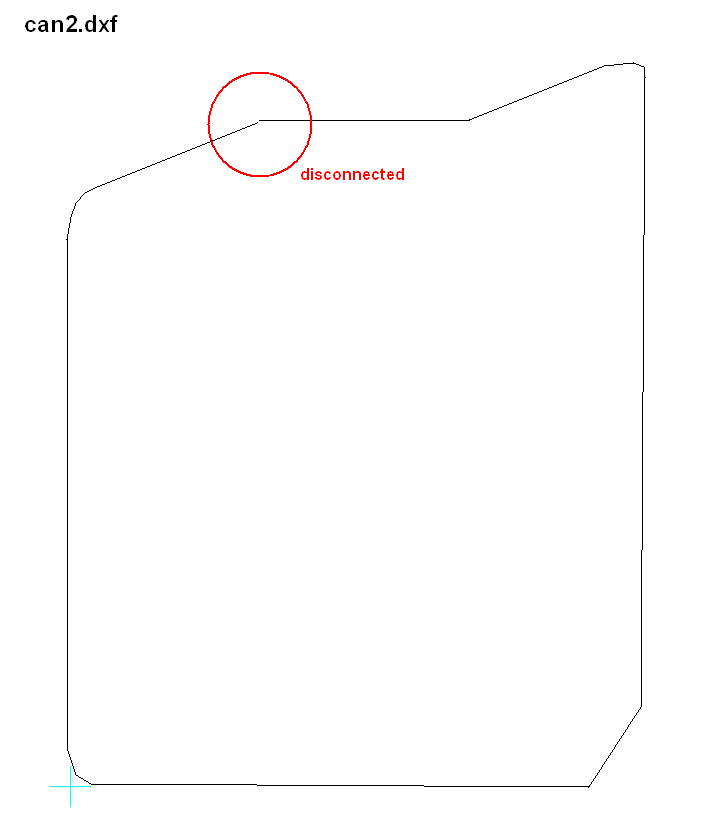

can2.dxf, that loads fine into openscad. That was also drawn in
designcad (by manually tracing a background jpeg image),  but I loaded
it into, and resaved via my cnc software.
I think OpenSCAD silently 'repairs' that file, because the profile in
your DXF file is disconnected, it does not describe a closed loop.
Without modification, it fails ion dxfread:

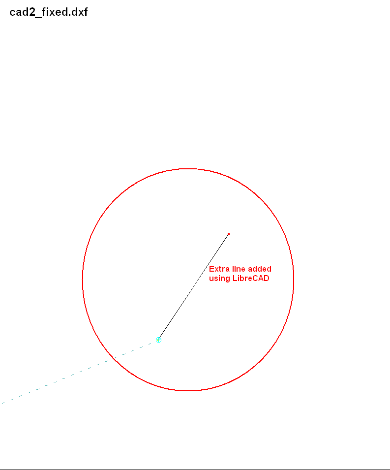

Looking at the DXF file in LibreCAD, it s clear that the profile is not
In can2_c.png, you can see the line I added using LibreCAD to close the
profile. If you want a reliable transfer of such model data you must
make sure the profiles are topologically connected, the problems you are
seing with DXF is not always due to the file format itself, but rather
the data in the file.
I saved the result after eding in LibreCAD to can2_fixed.dxf and tried
again, this time it worked:

The shape
files, which I would expect to import, do not.
This is because (unlike cand2.dxf) it contains the POLYLINE datatype
which is not supported in OpenSCAD.

openSCADs dxf importer imports the shape (1.) without any error message.
For (2.) both, the POLYLINES, as well as the VIEWPORT, are unsupported
by openSCADs dxf importer.
If the POLYLINE is converted to simple LINEs it's imported with only
a warning about unsupported VIEWPORT.
Conclusion: The openSCAD dxf importer works as expected - although a
permissible offset between two points is not specified explicitly.

I opened the dxf files in QCAD and found the following: 1. can2.DXF contains a non closed shape made with LINEs. There exist an offset of 0.1 between two points. 2. shape.dxf contains a closed shape made with one POLYLINE in a VIEWPORT. openSCADs dxf importer imports the shape (1.) without any error message. For (2.) both, the POLYLINES, as well as the VIEWPORT, are unsupported by openSCADs dxf importer. If the POLYLINE is converted to simple LINEs it's imported with only a warning about unsupported VIEWPORT. Conclusion: The openSCAD dxf importer works as expected - although a permissible offset between two points is not specified explicitly. Am Mon, 27 Jul 2020 12:27:28 +0100 schrieb Ray West <raywest@raywest.com>: > Hi, > > Thanks for all of your informative responses. I am sort of > overwhelmed. Hopefully I've attached a few files, if attachments work > OK on the mailing list. As I may have mentioned, I deleted the files > that were not usable, so I've recreated a couple of test files, and > included one that did work. All of the files were originally drawn > using design cad (I'm aware that it may not save in standard dxf > format either, but R12 seems to be most successful.) > > So. for shape.dxf - openscad reports > > > WARNING: Unsupported DXF Entity 'SEQEND' (1) in > > > "c:/users/ray/desktop/shape.dxf". WARNING: Unsupported DXF Entity > > 'POLYLINE' (1) in > "c:/users/ray/desktop/shape.dxf". WARNING: > > Unsupported DXF Entity 'VERTEX' (7) in > > > "c:/users/ray/desktop/shape.dxf". > > but the shape could not be much simpler. Within  designcad, I've no > idea how to not have polylines, vertexes, etc. , but I have not > looked into the dxf format in any detail. > > can2.dxf, that loads fine into openscad. That was also drawn in > designcad (by manually tracing a background jpeg image),  but I load > ed it into, and resaved via my cnc software. > > I've added a couple of stl files, too. > > shape.stl was the same drawing file that was saved as shape.dxf, but > saved as stl. It will not reload into designcad, nor display in > meshlab. > > shape2.stl is the same drawing, but within design cad it is selected > and made into a plane. That loads into meshlab fine, but not into > openscad. But, If i manipulate it in designcad to make it a solid, > instead of a plane, then it can be used by openscad. > > I have numerous more complex  dxf files, that I've not tried to impo > rt into openscad - I've no requirement to do so. I'm pretty certain > they would not import, but if anyone wants them as test data, then > let me know . > > Best wishes. > > Ray > -- Mit freundlichen Grüßen Best Regards Peter Ragosch

Looks like the POLYLINE import does work with the new import
code (https://github.com/openscad/openscad/pull/3006).
Looks like the POLYLINE import does work with the new import code (https://github.com/openscad/openscad/pull/3006). ciao, Torsten.

Interesting that your shape.dxf will read into AutoCAD and your can2.dxf will
not.
The can2 produces the error "Omitted group 12 line 84"
