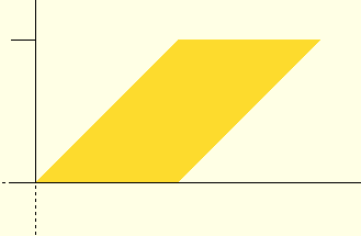

Some people can directly think in terms of matrix transformations.  I'm
not one of them.
  1. Can someone explain to me what is meant by "Shear X along Y?
Shearing is when a change in one axis causes a linear change in another
axis.

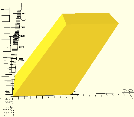

Looking at it two-dimensionally, this is a square that has been
sheared.  (I'm not clear on whether it's sheared X along Y, or vice
versa.)  The key thing is that for every unit of +Y, X has been shifted.
Now, actually, that's a face-on view of a cube that's been sheared in
two axes, but that's harder to see in a single 2D image:
Here, for every unit of +Z, X and Y have been shifted +1.

I'll try.  Simple transformation matrixes are relatively
understandable.  Here's the program that generated that cube:
module shearXY(xy) {
    m = [
        [1, 0, xy.x],
        [0, 1, xy.y],
        [0, 0, 1],
    multmatrix(m) children();
shearXY([1,1]) cube(10);
This is the combination of the identity matrix (1s all along the
diagonal) and shear factors along the third column.  The first shear
factor says how much X will change for each unit of Z change, and the
second says how much Y will change for every unit of Z change.

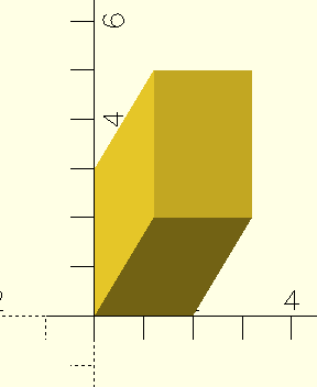

Let's use a more interesting example, so that the numbers are all different:
shearXY([0.3,0.5]) cube([2,3,4]);

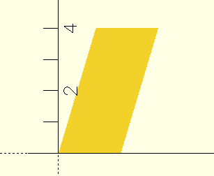

Sanity check... here's a top-down view of that figure:
Again, we're looking at the topmost, rightmost, backmost point on the
cube.  X... yeah, that looks like 3.2.  Y... yeah, looks like 5.  For Z
we need one of the side views; here's the front view:
Yep, Z is 4.
Again, for this shear we have said - the parameter to shearXY - that for
each unit of +Z, we want to change X by +0.3 and Y by +0.5.
