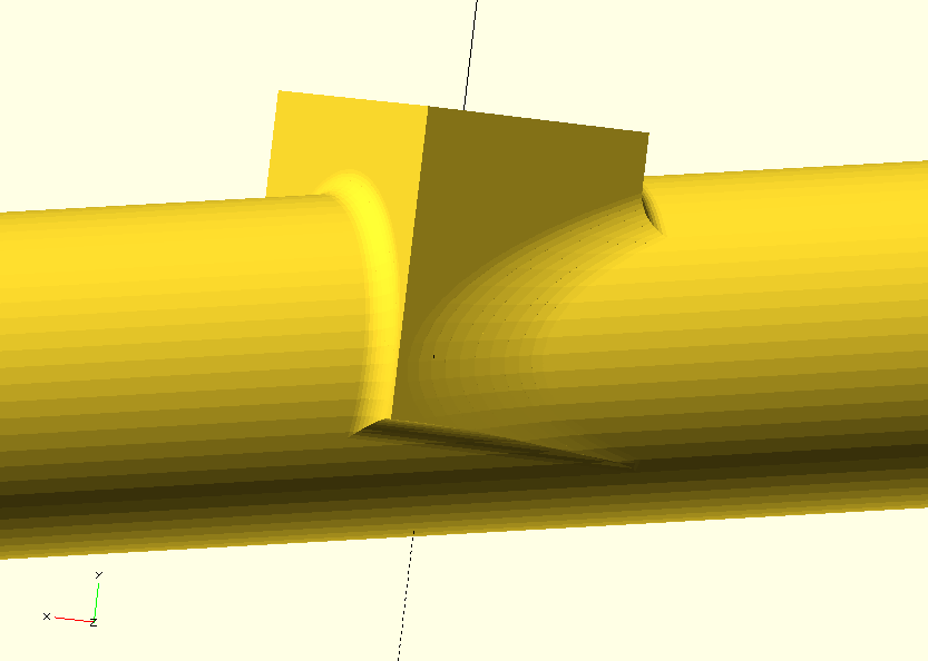

Hello,
It's possible that I have re-invented the wheel here, but I thought I would
share a simple solution I came up with to create fillets for the
intersection of two objects. It requires the objects to be defined with a
parametric size-offset, and it uses an iterative approach with hull() to
create a fillet. Here's an example with a cuboid (box()) embedded in a
cylinder (shaft()).
module shaft(dd=0) {
rotate([0,0,-10]) rotate([0,90,0]) cylinder(d=22+dd, h=100, $fn=60,
center=true);
module box(dd=0) {
translate([0,5,5]) cube([15+dd,18+dd,25+dd], center=true);
module filletSlice(ro, ang) {
p = ro * [(1-cos(ang)), (1-sin(ang))];
shaft(p.x);
box(p.y);
da = 10;
for (a=[0:da:90-da]) {
hull() {
filletSlice(2, a);
filletSlice(2, a+da);
shaft();
box();

There's the obvious limitation that if the area of intersection has native
curvature then the fillet will pull away from the part (because hull() {
object1() } != object1() in that area). So if eg object1() had a wave
pattern, like some corrugated decking material... the result would not be
good.
On a case by case basis this sort of thing could probably be dealt with by
iterating over another parameter, and intersecting with a third parametric
object that creates small interpolations of the negative curve. But I am
not sure how this will affect the computation time (geometric increase in
calls to hull(), though each call on a much smaller object).

Daniel, I think what you really mean is that if the object is not convex in
the area around the intersection then you're in trouble.  There's no good
solution to this problem.  The hull() operation is called CONVEX hull for a
reason.  But I think this is an interesting approach, and I, at least, have
not seen it before.  (And I'm really interested in rounding.)
I wrote a version that assumes you have two children at unit scale and uses
scale() to make the joined object.  That doesn't require having a
parametrized module for each object, though it's limited in other ways.
With BOSL2 it would be natural to combine at least the translate and rotate
operators into a single matrix that you pass in.  I also added a chamfer
option.  (Note that there's no way to avoid the code duplication because
you can't pass children separately to a submodule.)
native curvature then the fillet will pull away from the part (because
hull() { object1() } != object1() in that area). So if eg object1() had a
wave pattern, like some corrugated decking material... the result would not
be good.
by iterating over another parameter, and intersecting with a third
parametric object that creates small interpolations of the negative curve.
But I am not sure how this will affect the computation time (geometric
increase in calls to hull(), though each call on a much smaller object).

Thanks for the embellishments Adrian. It is a pity that OpenSCAD doesn't
allow you to pass one module definition as an argument to another, as
Python does - and I was grasping for. Your approach cleans that up nicely.
Given the limitations of what OpenSCAD gives you access to, this seemed to
be like the simplest and most direct way to achieve this outcome.
in the area around the intersection then you're in trouble.  There's no
good solution to this problem.  The hull() operation is called CONVEX hull
for a reason.  But I think this is an interesting approach, and I, at
least, have not seen it before.  (And I'm really interested in rounding.)
uses scale() to make the joined object.  That doesn't require having a

Thanks for the embellishments Adrian. It is a pity that OpenSCAD doesn't allow you to pass one module definition as an argument to another, as Python does - and I was grasping for. Your approach cleans that up nicely. Given the limitations of what OpenSCAD gives you access to, this seemed to be like the simplest and most direct way to achieve this outcome. On Tue, Feb 14, 2023 at 3:02 PM Adrian Mariano <avm4@cornell.edu> wrote: > Daniel, I think what you really mean is that if the object is not convex > in the area around the intersection then you're in trouble. There's no > good solution to this problem. The hull() operation is called CONVEX hull > for a reason. But I think this is an interesting approach, and I, at > least, have not seen it before. (And I'm really interested in rounding.) > > I wrote a version that assumes you have two children at unit scale and > uses scale() to make the joined object. That doesn't require having a > parametrized module for each object, though it's limited in other ways. > With BOSL2 it would be natural to combine at least the translate and rotate > operators into a single matrix that you pass in. I also added a chamfer > option. (Note that there's no way to avoid the code duplication because > you can't pass children separately to a submodule.) > > // Invoke with 2 children that are at unit scale and create a > // fillet joint between them, while applying specified transformations. > // > // r = radius of fillet (relative to scale of children) > // T0,R0,S0 = translation, rotation and scaling for object 0 > // T1,R1,S1 = translation, rotation and scaling for object 1 > // steps = number of steps in fillet > // chamfer = set true to get chamfer instead of rounding > > module fillet_join(r, T0,R0,S0, T1,R1,S1, steps=10, chamfer=false) > { > assert($children==2); > da=1/steps; > for(a=[0:da:1-da/2]){ > hull() { > first_offset = chamfer ? r * [a,1-a] > : r * [1-cos(90*a), 1-sin(90*a)]; > first_scale0 = [for(s=S0) first_offset[0]+s]; > first_scale1 = [for(s=S1) first_offset[1]+s]; > second_offset = chamfer ? r * [a+da, 1-a-da] > : r * [1-cos(90*(a+da)), > 1-sin(90*(a+da))]; > second_scale0 = [for(s=S0) second_offset[0]+s]; > second_scale1 = [for(s=S1) second_offset[1]+s]; > intersection(){ > translate(T0)rotate(R0)scale(first_scale0) children(0); > translate(T1)rotate(R1)scale(first_scale1) children(1); > } > intersection(){ > translate(T0)rotate(R0)scale(second_scale0) children(0); > translate(T1)rotate(R1)scale(second_scale1) children(1); > } > } > } > translate(T0)rotate(R0)scale(S0) children(0); > translate(T1)rotate(R1)scale(S1) children(1); > } > > > fillet_join(3,[0,0,3], [0,90,-10], [22,22,100], > [0,6,6], [0,20,0], [15,20,28],chamfer=false) > { > cylinder(d=1,center=true,$fn=64); > cube(center=true); > } > > [image: image.png] > > > On Tue, Feb 14, 2023 at 10:15 AM Daniel Harvey <dwaharvey@gmail.com> > wrote: > >> There's the obvious limitation that if the area of intersection has >> native curvature then the fillet will pull away from the part (because >> hull() { object1() } != object1() in that area). So if eg object1() had a >> wave pattern, like some corrugated decking material... the result would not >> be good. >> On a case by case basis this sort of thing could probably be dealt with >> by iterating over another parameter, and intersecting with a third >> parametric object that creates small interpolations of the negative curve. >> But I am not sure how this will affect the computation time (geometric >> increase in calls to hull(), though each call on a much smaller object). >> >> On Tue, Feb 14, 2023 at 5:20 AM Sanjeev Prabhakar < >> sprabhakar2006@gmail.com> wrote: >> >>> It looks great, although not gone in detail. >>> Does it work for all type of solid to solid intersections? >>> >>> On Tue, 14 Feb, 2023, 9:58 am Daniel Harvey, <dwaharvey@gmail.com> >>> wrote: >>> >>>> Hello, >>>> It's possible that I have re-invented the wheel here, but I thought I >>>> would share a simple solution I came up with to create fillets for the >>>> intersection of two objects. It requires the objects to be defined with a >>>> parametric size-offset, and it uses an iterative approach with hull() to >>>> create a fillet. Here's an example with a cuboid (box()) embedded in a >>>> cylinder (shaft()). >>>> >>>> module shaft(dd=0) { >>>> rotate([0,0,-10]) rotate([0,90,0]) cylinder(d=22+dd, h=100, $fn=60, >>>> center=true); >>>> } >>>> >>>> module box(dd=0) { >>>> translate([0,5,5]) cube([15+dd,18+dd,25+dd], center=true); >>>> } >>>> >>>> module filletSlice(ro, ang) { >>>> p = ro * [(1-cos(ang)), (1-sin(ang))]; >>>> intersection() { >>>> shaft(p.x); >>>> box(p.y); >>>> } >>>> } >>>> >>>> da = 10; >>>> for (a=[0:da:90-da]) { >>>> hull() { >>>> filletSlice(2, a); >>>> filletSlice(2, a+da); >>>> } >>>> } >>>> shaft(); >>>> box(); >>>> >>>> _______________________________________________ >>>> OpenSCAD mailing list >>>> To unsubscribe send an email to discuss-leave@lists.openscad.org >>>> >>> _______________________________________________ >>> OpenSCAD mailing list >>> To unsubscribe send an email to discuss-leave@lists.openscad.org >>> >> _______________________________________________ >> OpenSCAD mailing list >> To unsubscribe send an email to discuss-leave@lists.openscad.org >> > _______________________________________________ > OpenSCAD mailing list > To unsubscribe send an email to discuss-leave@lists.openscad.org >

Sanjay, I agree with you, and getting a list of the intersection points was
what I was originally thinking about, but I'm not aware of any OpenSCAD way
to obtain that information. I imagine in a python notebook one could do it
(?), but I am doing everything in OpenSCAD directly and was looking for a
good/simple way to get this done.

Sanjay, I agree with you, and getting a list of the intersection points was what I was originally thinking about, but I'm not aware of any OpenSCAD way to obtain that information. I imagine in a python notebook one could do it (?), but I am doing everything in OpenSCAD directly and was looking for a good/simple way to get this done. On Tue, Feb 14, 2023 at 6:50 PM Sanjeev Prabhakar <sprabhakar2006@gmail.com> wrote: > If the points of intersection between the 2 solids can be found then > creating fillet would be possible. > 3 list of intersection points would be required > a. both the solids at their original dimensions > b.1st solid at original dimension and 2nd solid at offset = the fillet > radius (approximate) > c.1st solid at offset= the fillet radius and 2nd solid at original > dimension > > with the above 3 list of points > group the points e.g. first point of each list and create a fillet arc and > so on > > finally create a polyheadron with all the fillet arcs > > this works in most of the cases > > On Wed, 15 Feb 2023, 03:32 Adrian Mariano, <avm4@cornell.edu> wrote: > >> Daniel, I think what you really mean is that if the object is not convex >> in the area around the intersection then you're in trouble. There's no >> good solution to this problem. The hull() operation is called CONVEX hull >> for a reason. But I think this is an interesting approach, and I, at >> least, have not seen it before. (And I'm really interested in rounding.) >> >> I wrote a version that assumes you have two children at unit scale and >> uses scale() to make the joined object. That doesn't require having a >> parametrized module for each object, though it's limited in other ways. >> With BOSL2 it would be natural to combine at least the translate and rotate >> operators into a single matrix that you pass in. I also added a chamfer >> option. (Note that there's no way to avoid the code duplication because >> you can't pass children separately to a submodule.) >> >> // Invoke with 2 children that are at unit scale and create a >> // fillet joint between them, while applying specified transformations. >> // >> // r = radius of fillet (relative to scale of children) >> // T0,R0,S0 = translation, rotation and scaling for object 0 >> // T1,R1,S1 = translation, rotation and scaling for object 1 >> // steps = number of steps in fillet >> // chamfer = set true to get chamfer instead of rounding >> >> module fillet_join(r, T0,R0,S0, T1,R1,S1, steps=10, chamfer=false) >> { >> assert($children==2); >> da=1/steps; >> for(a=[0:da:1-da/2]){ >> hull() { >> first_offset = chamfer ? r * [a,1-a] >> : r * [1-cos(90*a), 1-sin(90*a)]; >> first_scale0 = [for(s=S0) first_offset[0]+s]; >> first_scale1 = [for(s=S1) first_offset[1]+s]; >> second_offset = chamfer ? r * [a+da, 1-a-da] >> : r * [1-cos(90*(a+da)), >> 1-sin(90*(a+da))]; >> second_scale0 = [for(s=S0) second_offset[0]+s]; >> second_scale1 = [for(s=S1) second_offset[1]+s]; >> intersection(){ >> translate(T0)rotate(R0)scale(first_scale0) children(0); >> translate(T1)rotate(R1)scale(first_scale1) children(1); >> } >> intersection(){ >> translate(T0)rotate(R0)scale(second_scale0) children(0); >> translate(T1)rotate(R1)scale(second_scale1) children(1); >> } >> } >> } >> translate(T0)rotate(R0)scale(S0) children(0); >> translate(T1)rotate(R1)scale(S1) children(1); >> } >> >> >> fillet_join(3,[0,0,3], [0,90,-10], [22,22,100], >> [0,6,6], [0,20,0], [15,20,28],chamfer=false) >> { >> cylinder(d=1,center=true,$fn=64); >> cube(center=true); >> } >> >> [image: image.png] >> >> >> On Tue, Feb 14, 2023 at 10:15 AM Daniel Harvey <dwaharvey@gmail.com> >> wrote: >> >>> There's the obvious limitation that if the area of intersection has >>> native curvature then the fillet will pull away from the part (because >>> hull() { object1() } != object1() in that area). So if eg object1() had a >>> wave pattern, like some corrugated decking material... the result would not >>> be good. >>> On a case by case basis this sort of thing could probably be dealt with >>> by iterating over another parameter, and intersecting with a third >>> parametric object that creates small interpolations of the negative curve. >>> But I am not sure how this will affect the computation time (geometric >>> increase in calls to hull(), though each call on a much smaller object). >>> >>> On Tue, Feb 14, 2023 at 5:20 AM Sanjeev Prabhakar < >>> sprabhakar2006@gmail.com> wrote: >>> >>>> It looks great, although not gone in detail. >>>> Does it work for all type of solid to solid intersections? >>>> >>>> On Tue, 14 Feb, 2023, 9:58 am Daniel Harvey, <dwaharvey@gmail.com> >>>> wrote: >>>> >>>>> Hello, >>>>> It's possible that I have re-invented the wheel here, but I thought I >>>>> would share a simple solution I came up with to create fillets for the >>>>> intersection of two objects. It requires the objects to be defined with a >>>>> parametric size-offset, and it uses an iterative approach with hull() to >>>>> create a fillet. Here's an example with a cuboid (box()) embedded in a >>>>> cylinder (shaft()). >>>>> >>>>> module shaft(dd=0) { >>>>> rotate([0,0,-10]) rotate([0,90,0]) cylinder(d=22+dd, h=100, >>>>> $fn=60, center=true); >>>>> } >>>>> >>>>> module box(dd=0) { >>>>> translate([0,5,5]) cube([15+dd,18+dd,25+dd], center=true); >>>>> } >>>>> >>>>> module filletSlice(ro, ang) { >>>>> p = ro * [(1-cos(ang)), (1-sin(ang))]; >>>>> intersection() { >>>>> shaft(p.x); >>>>> box(p.y); >>>>> } >>>>> } >>>>> >>>>> da = 10; >>>>> for (a=[0:da:90-da]) { >>>>> hull() { >>>>> filletSlice(2, a); >>>>> filletSlice(2, a+da); >>>>> } >>>>> } >>>>> shaft(); >>>>> box(); >>>>> >>>>> _______________________________________________ >>>>> OpenSCAD mailing list >>>>> To unsubscribe send an email to discuss-leave@lists.openscad.org >>>>> >>>> _______________________________________________ >>>> OpenSCAD mailing list >>>> To unsubscribe send an email to discuss-leave@lists.openscad.org >>>> >>> _______________________________________________ >>> OpenSCAD mailing list >>> To unsubscribe send an email to discuss-leave@lists.openscad.org >>> >> _______________________________________________ >> OpenSCAD mailing list >> To unsubscribe send an email to discuss-leave@lists.openscad.org >> > _______________________________________________ > OpenSCAD mailing list > To unsubscribe send an email to discuss-leave@lists.openscad.org >
Wed, Feb 15, 2023 2:43 AM
Daniel, it's not that you need to be able to pass modules, but at least it
would be cleaner if you could pass the children rather than just the union
of all the children to a called module.  Maybe there is a way to streamline
my code a bit by applying the transformation to each object separately in a
module---I think it would only be a slight improvement.  Of course, the
real ideal is to have access to the geometry data explicitly in your
modules, which is not (yet?) possible.  Note that a few months ago, Sanjeev
and I  had a lengthy discussion about rounding the joint between two
objects.  Both Sanjeev and I wrote code to do it, but Sanjeev has moved to
doing everything in Python and using OpenSCAD just as a display engine.
Both of us assumed that the objects were available as point lists, not as
OpenSCAD geometry, so it was possible to actually compute those
intersections and make fillets work even for concave objects, though there
are some complications that can still arise when your fillet ends up
self-intersecting.  To see my results take a a look at join_prism() from
the BOSL2 library:
https://github.com/revarbat/BOSL2/wiki/rounding.scad#functionmodule-join_prism
There are 55 examples to show how it works.  :)    But for convex objects
your approach can handle cases that my code cannot, like objects that
half-intersect each other.  And it doesn't require that the objects be one
of prism, plane or sphere.
dimension
and so on
da=1/steps;
hull() {
: r * [1-cos(90a), 1-sin(90a)];
1-sin(90*(a+da))];
intersection(){
intersection(){
cube(center=true);
On Tue, Feb 14, 2023 at 10:15 AM Daniel Harvey dwaharvey@gmail.com
be good.
On Tue, 14 Feb, 2023, 9:58 am Daniel Harvey, dwaharvey@gmail.com
Hello,
cylinder (shaft()).
module box(dd=0) {
shaft(p.x);
box(p.y);
da = 10;
hull() {
filletSlice(2, a);
shaft();
box();
