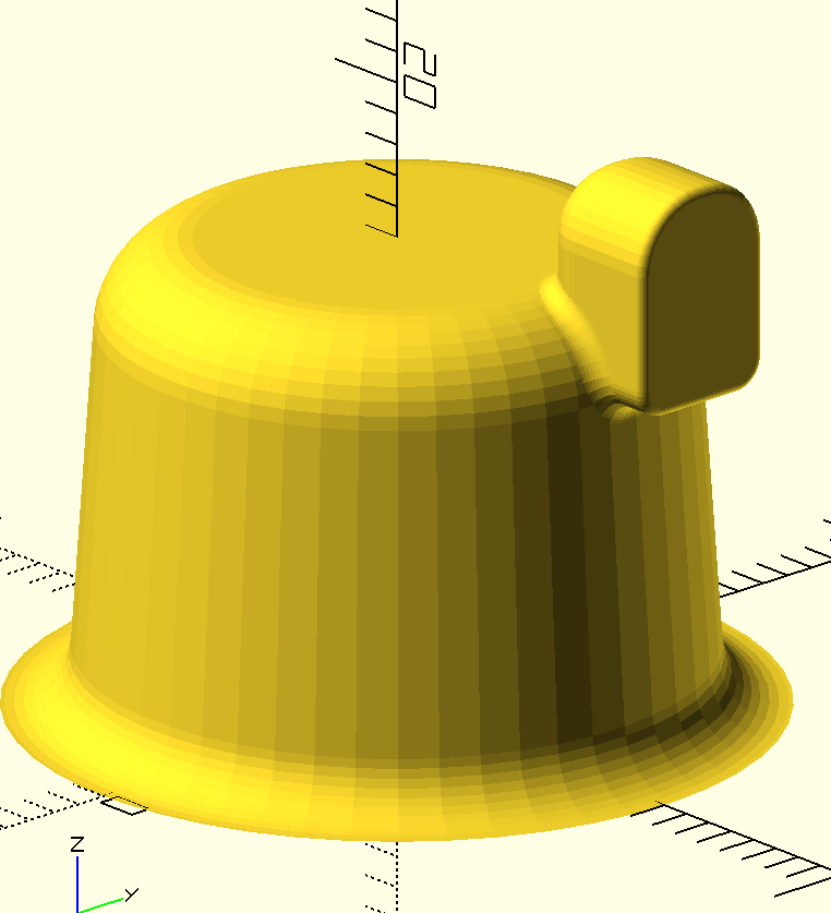

                            I realized that I overlooked a way to do this with a module.  The problem
was I tried passing children() instead of passing the children
individually, which you can do in this case because you know how many there
are.  That gives this slightly streamlined code:
// Invoke with 2 children that are at unit scale and create a
// fillet joint between them, while applying specified transformations.
// r = radius of fillet (relative to scale of children)
// T0,R0,S0 = translation, rotation and scaling for object 0
// T1,R1,S1 = translation, rotation and scaling for object 1
// steps = number of steps in fillet
// chamfer = set true to get chamfer instead of rounding
module fillet_slice(r, a, T0,R0,S0, T1,R1,S1, chamfer=false)
offset = chamfer ? r * [a,1-a]
: r * [1-cos(90a), 1-sin(90a)];
scale0 = [for(s=S0) offset[0]+s];
scale1 = [for(s=S1) offset[1]+s];
intersection(){
translate(T0)rotate(R0)scale(scale0) children(0);
translate(T1)rotate(R1)scale(scale1) children(1);
module fillet_join(r, T0,R0,S0, T1,R1,S1, steps=10, chamfer=false)
assert($children==2);
da=1/steps;
for(a=[0:da:1-da/2]){
hull() {
fillet_slice(r,a,T0,R0,S0,T1,R1,S1,chamfer){
children(0);
children(1);
fillet_slice(r,a+da,T0,R0,S0,T1,R1,S1,chamfer){
children(0);
children(1);
translate(T0)rotate(R0)scale(S0) children(0);
translate(T1)rotate(R1)scale(S1) children(1);
fillet_join(3,[0,0,3], [0,90,-10], [22,22,100],
[0,6,6], [0,20,0], [15,20,28],chamfer=false)
cylinder(d=1,center=true,$fn=64);
cube(center=true);

                            Adrian - I like where you've taken this. I rearranged the code a bit and
made it into a single module. I also allowed r to be a list, because I like
how the fillet looks when it has an elliptical section - allows you to make
one object feel "primary" and have the other object flow into it, rather
than the fillet just evening them both equally.
// r = radius of fillet (relative to scale of children, can be a list to
create elliptical fillet)
module fillet_join(r, T0,R0,S0, T1,R1,S1, steps=10, chamfer=false) {
T = [T0,T1];
R = [R0,R1];
S = [S0,S1];
module _position(i, dS=0) {
translate(T[i]) rotate(R[i]) scale(S[i]+dS*[1,1,1]) children();
function scaleR(fs, i) = fs[i] * (is_list(r) ? r[i] : r);
da=1/steps;
for(ai=[da:da:1]){
    hull() {
        for (a=[ai-da,ai]) {
            fsc = chamfer ? [a,1-a] : [1-cos(90*a), 1-sin(90*a)];
            intersection(){
                _position(0,scaleR(fsc,0)) children(0);
                _position(1,scaleR(fsc,1)) children(1);
_position(0) children(0);
_position(1) children(1);
fillet_join([2,5],[0,0,3], [0,90,-10], [22,22,100],
[0,6,6], [0,20,0], [15,20,28],chamfer=false) {
cube(center=true);
    T = [T0,T1];
    R = [R0,R1];
    S = [S0,S1];
    da=1/steps;
    for(ai=[da:da:1]){
        hull() {
                intersection(){
    cube(center=true);

                Thu, Feb 16, 2023 1:01 AM
                            Daniel, here's a slightly tweaked and better documented version.  Also
chamfers only need one step, which obviously is faster.   I'm not sure if
it's possible for the loop to fail to run the "1" case, since it's floating
point with an equality test.  It could be changed to loop through
integers.
// Module: fillet_join()
// Usage:
//   fillet_join(r, T0, R0, S0, T1, R1, S1, [steps], [chamfer])
// Description:
//   Invoke with 2 children that are at unit scale and centered at the
//   origin.  You supply translation, rotation and scaling parameters
//   for each of the children.  The fillet_join module creates a fillet at
//   the intersection of the two objects in their transformed position.
//   The children must be locally convex in the region where they intersect.
//   If your objects are not unit sized then the fillets may end up
//   scaled, possibly differently in different directions.  You can give the
//   radius as a list of two values to scale the fillet differently on the
//   two objects.
// Arguments:
//   r = radius of fillet, relative to scaled of children.  Can be a list
of 2 values.
//   T0, R0, S0 = translation, rotation and scaling for object 0
//   steps = number of steps in fillet.  Default: 10
//   chamfer = set true to get chamfer instead of rounding.  Default: False
T = [T0,T1];
R = [R0,R1];
S = [S0,S1];
r = is_num(r) ? [r,r] : r;
module _position(i, dS=0) translate(T[i]) rotate(R[i])
assert(is_list(r) && len(r)==2,"radius must be a number of length 2
list");
da=1/steps;
for(ai=[da:da:1]){
hull() {
fsc = chamfer ? [a,1-a] : [1-cos(90a), 1-sin(90a)];
intersection_for(i=[0,1]) _position(i,fsc[i] * r[i])
children(i);
for(i=[0,1]) _position(i) children(i);
cube(center=true);
intersection(){
da=1/steps;
hull() {
children(0);
children(1);
children(0);
children(1);
cube(center=true);
integers.
// Usage:
// Description:
//   two objects.
// Arguments:
of 2 values.
    T = [T0,T1];
    R = [R0,R1];
    S = [S0,S1];
list");
    da=1/steps;
    for(ai=[da:da:1]){
        hull() {
children(i);
    cube(center=true);

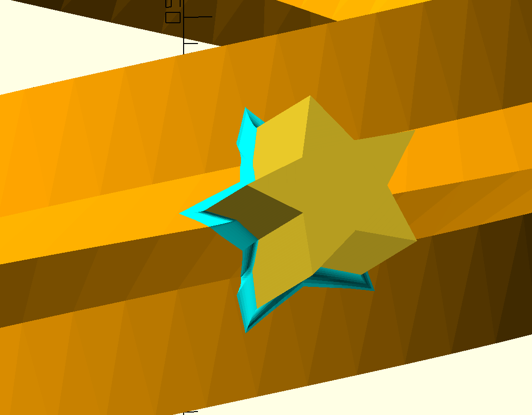

                Thu, Feb 16, 2023 4:50 PM
                            I would suggest someone to find a solution for the intersections as shown
below.
I have tried this but it's not so good.
[image: Screenshot 2023-02-16 at 10.10.47 PM.png]
also please see if the below is possible with the method proposed here
[image: Screenshot 2023-02-16 at 10.18.19 PM.png]
below.
