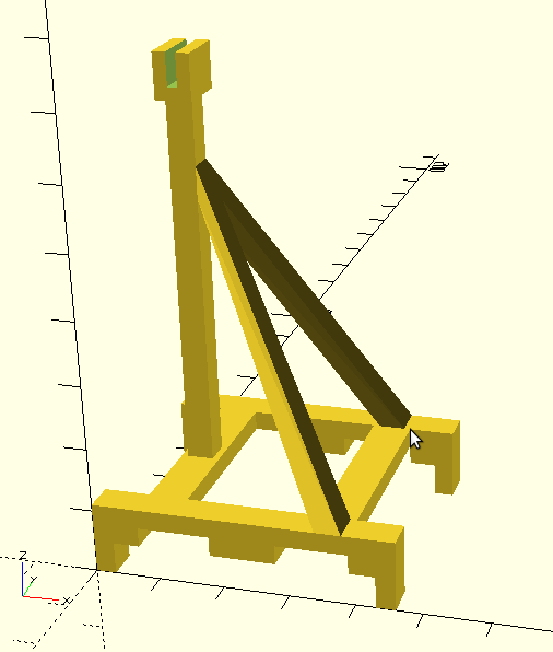

Hello all,
i made a little "thing" (attached below).
If i press F5 i get it rendered with no problem. By pressing F6 i get :
violation! Expr: ss_plane.has_on(sv_prev->point()) File:
/usr/include/CGAL/Nef_3/polygon_mesh_to_nef_3.h Line: 294
i am using OpenSCAD version 2017.12.21
sometimes it will be rendered, but without the polyhedron.
can you help me, what i did wrong ?

Hello all, i made a little "thing" (attached below). If i press F5 i get it rendered with no problem. By pressing F6 i get : ERROR: CGAL error in CGAL_Nef_polyhedron3(): CGAL ERROR: assertion violation! Expr: ss_plane.has_on(sv_prev->point()) File: /usr/include/CGAL/Nef_3/polygon_mesh_to_nef_3.h Line: 294 i am using OpenSCAD version 2017.12.21 sometimes it will be rendered, but without the polyhedron. can you help me, what i did wrong ? /* * Thing starts here */ translate([0,35,0]) bodenprofil(); bodenprofil(); translate([3+4,0,5+3])cube([6,40,3]); translate([40-7,0,5+3])cube([6,40,3]); translate([3+5,18,5+3])cube([4,4,60]); translate([3+4.25,16,5+3+60]) difference() { cube([5.5,8,7]); translate([2,-1,2]) cube([1.5,10,6]); } module bodenprofil() { translate([0,5,0]) rotate([90,0,0]) linear_extrude(height = 5) polygon([[0,0],[3,0],[3,5],[7,5],[7,8],[18,8],[18,5],[28,5],[28,8],[39,8],[39,5],[43,5],[43,0],[46,0],[46,11],[0,11]]); } polyhedron([ [39-5,0,11], [43-5,0,11], [43-5,5,11], [39-5,5,11], [12,18,58-5], [12,18,58], [12,22,58], [12,22,58-5] ], [ [0,1,2,3], // bottom [4,5,1,0], // front [7,6,5,4], // top [5,6,2,1], // right [6,7,3,2], // back [7,4,0,3]] ); polyhedron([ [39-5,0+35,11], [43-5,0+35,11], [43-5,5+35,11], [39-5,5+35,11], [12,18,58-5], [12,18,58], [12,22,58], [12,22,58-5] ], [ [0,1,2,3], // bottom [4,5,1,0], // front [7,6,5,4], // top [5,6,2,1], // right [6,7,3,2], // back [7,4,0,3]] ); /* * Thing stops here */ best regards corpsman
Mon, Jan 15, 2018 8:32 PM
I had no problem to render (F6) your model with snapshot version
2018.01.06. The "front" facets of your polyhedra are not planar and that
could be the reason of CGAL complaints for version 2017.12.21. Either
install the new snapshot version or triangulate those facets.

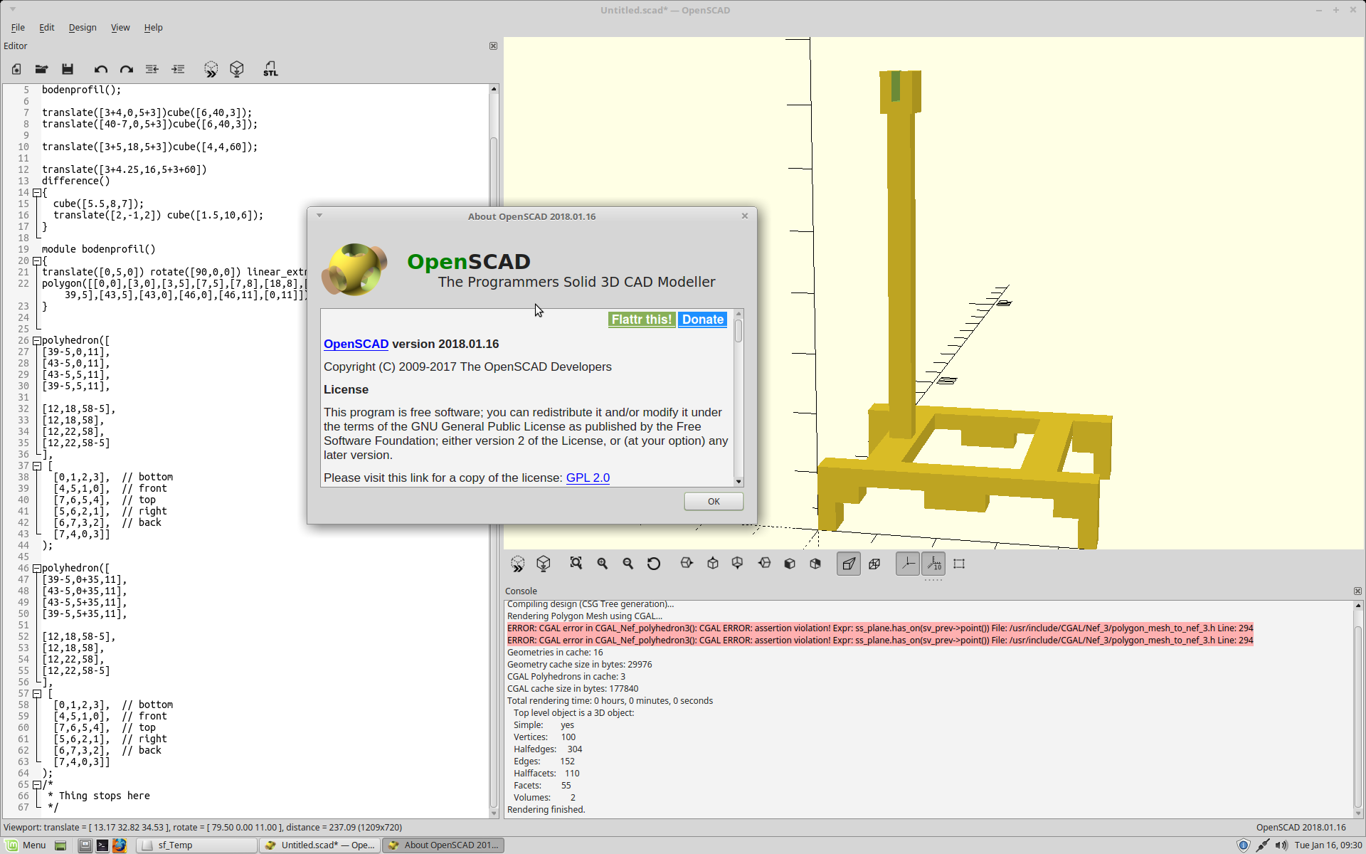

Tue, Jan 16, 2018 11:32 AM
my fault, i do not run Windows, (i tested it on Windows, there it works
with the version from 6.01.) is there a way to get the Linux version
from 6.01 ? to double check?
i am using Ubuntu Mate64 and tested it with the nightly build from
tonight, see attachment.

Uwe Schächterle
Wed, Jan 17, 2018 4:10 PM
To inform the ones that are interested in.
The Problem under Linux still exists, but i found a workaround.
if you write
hull()
around the polyhedron then F6 is possible under Linux too.
