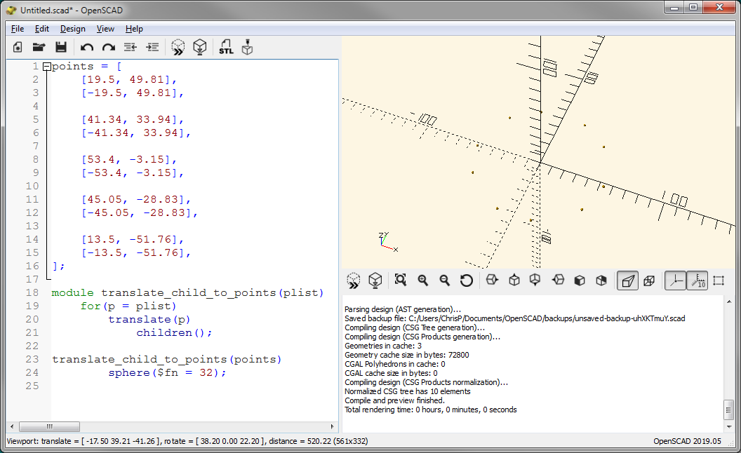

I'm not a wizard at OpenSCAD, but enjoy using it for model creation. It
appeals to the logical side of my alleged mind. Unfortunately, the grey
matter is deteriorating too fast to encompass the massive power of coding
with OpenSCAD, so I'm asking for a bit of help.
I have been using  SolveSpace http://solvespace.com/index.pl  to create
quick-and-dirty drawings that also happen to have valuable parametric data.
As a result, my latest project allowed me to type out a list of 2D points on
a circle, ten in all, with semi-regular spacing. "Here's a hole, there's a
hole x mm away, then a hole y mm away, repeat five times."
I've attempted to understand the children() feature of OpenSCAD, with no
luck. Perhaps if children is/are the answer, I may understand it better in
the long run, but I'm not able to figure it out on my own.
If children isn't the best approach, what would be?
As it stands, the brute force method would be to create cylinders and
translate each one individually to the correct location. Is there a better
way?
19.5, 49.81
-19.5, 49.81
41.34, 33.94
-41.34, 33.94
53.4, -3.15
-53.4, -3.15
45.05, -28.83
-45.05, -28.83
13.5, -51.76
-13.5, -51.76
thanks

Does this help?
points = [
[19.5, 49.81],
[-19.5, 49.81],
[41.34, 33.94],
[-41.34, 33.94],
[53.4, -3.15],
[-53.4, -3.15],
[45.05, -28.83],
[-45.05, -28.83],
[13.5, -51.76],
[-13.5, -51.76],
module translate_child_to_points(plist)
for(p = plist)
translate(p)
translate_child_to_points(points)
sphere($fn = 32);

Troberg
Wed, Aug 21, 2019 6:52 AM
I find it easiest to think of children() as a function pointer. Whenever it
is used, it calls everything you pass to your module.
So, if I have this (all very simplified, and not necessarily exactly how I'd
do it):
module screw(){
module nut(){
module washer(){
module screwassembly(){
screw();
washer();
translate([0,0,-20])
washer();
nut();
module placesstuff(){
for(some logic to get some coordinates){
translate(coord)
placestuff()
screwassembly();
In this case, each time children() is called, all the code in the other
modules will be run, creating a new screwassembly.

Maybe this would help you...
First, recognize that your openscad scripts, in order to draw something,
construct a tree of operations.
                                                             rotate([90,
0, 0])
translate([20, 20, 0])
union()
cube(size = [5, 5, 5])
cube(size = [10, 3, 5], center = false)
Next recognize in Openscad there are two types of operations; modules and
functions.
Functions only return values.  These can be used to calculate some value,
iterate over a list of values and do something with them, or whatever else
you can dream up so long as the result is one or more values.  The return
values are expressed as either a number, a list of numbers, or a matrix of
numbers.
Modules on the other hand do not return anything, but rather either act on,
or draw shapes.  The "cube" operation obviously draws a shape.  The "union",
"translate", and "rotate" operations act on a shape.  Which shape?  Their
children in the operation tree.  So these modules are coded to do stuff to
"children()".
The next time you go to craft a module, ask yourself is the module going to
draw something, or manipulate something that is already drawn.  If the
latter, you'll need to use "children()".

That bit confused me
slightly as well, as there were no curly braces after the module call, but
copy/paste worked anyway.
You don't need curly braces to translate a single object:
translate([10,0,0]) sphere(10);
The same happens with modules and it children().
Note that translate() is itself an operator module that could be
pseudocoded by:
module translate(v=[0,0,0])
rebuild children() adding v to each of its vertices;
I interpret children as the argument name of a module that operates on an
object. OpenSCAD language does not allow that objects (models) be passed as
parameter to functions and modules. So, children replaces the role a
parameter for modules that operates on objects. So, instead of :
module rotranlate(ang, vec, object) {
rotate(ang)
translate(vec)
object;
rotranslate( 30, [10,0,0], cube(10) );
which is forbidden, we may write:
module rotranslate(ang, vec) {
rotate(ang)
translate(vec)
rotranslate( 30, [10,0,0] ) cube(10);
or, equivalently:
rotranslate( 30, [10,0,0] ) { cube(10); }

children to identify each object:
module hullDifference() {
hull() children(0);
hull() children(1);
hullDifference()  { translate([10,0,0]) cylinder(h=20,r=10);
rotate(30) translate([0,0,-0.5]) cube(21);
Note that here the curly braces are necessary to embrace the two children
in the hullDifference() call. Try to eliminate the braces and see what
happens.
