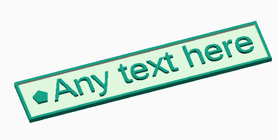

As a side comment without arguing against that, with some ingenuity its is
possible to generate fully parametric models like the one bellow:
[image: fob.PNG]
The design would be simple to be done from the bounding box data of the
inscription and so we are tempted to give up before realizing that the data
is not essential, the bounding box itself is enough.
// inscription data
text = "Any text here";
size = 10;
// fob data
margins  = [7, 4];
border    = 2;
thickness = 2;
depth    = 1;
fob(margins, border, thickness)
text(text,size=size,valign="center");
translate([-size7/16,0])
rotate(18)
circle(size
5/16,$fn=5);
module fob(margins, border, thickness) {
module simple_fob(dimens) {
        minkowski() {
        translate([0,0,.01])
        cube([dimens[0], dimens[1],.02], center=true);
        bbox()
            linear_extrude(dimens[2], convexity=10)
    simple_fob([margins[0]+border,margins[1]+border, thickness])
        translate([0,0,thickness-depth])
            simple_fob([margins[0],margins[1], thickness])
        linear_extrude(thickness, convexity=10)
The code relies on an operator (a module that handles children() ), bbox(),
to generate the bounding box geometry that is a simple cube. That operator
may be coded in OpenSCAD as it can be seen in the now overlooked OpenSCAD
Manual section, Tips and Tricks
https://en.wikibooks.org/wiki/OpenSCAD_User_Manual/Tips_and_Tricks#Computing_a_bounding_box.
Although the code makes use of minkowski(), an operator usually considered
slow, its operation involves only cubic shapes and it is fast. In my
machine, the render (F6) of this model takes a few seconds.
The bbox() operator may be also helpful for defining a clipping box fitted
to a design as discussed here elsewhere.
