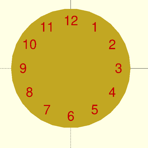

While trying to do this inversion 2015.03-2
linear_extrude(height = 10, center = true, convexity = 10)
import (file = "BrainiacDisc.dxf", layer = "plate");
I get this output:
Geometries in cache: 8
Geometry cache size in bytes: 544
CGAL Polyhedrons in cache: 0
CGAL cache size in bytes: 0
Normalized CSG tree has 1 elements
Compile and preview finished.
Total rendering time: 0 hours, 0 minutes, 0 seconds
but no graphics in the preview window with either F5 or F6. Adding a
render () ; doesn't help. This is the file:
https://content.instructables.com/ORIG/FVW/KRMO/JYOOS8QT/FVWKRMOJYOOS8QT.dxf
I can open it in CorelDraw and it looks OK there. What am I doing wrong?
- Michele

it has a long layer name, not the one you set it scad:
[image: Bildschirmfoto 2021-06-03 um 21.55.52.png]
I renamed this layer to 'aaa' and changed that in scad as well - works for
me (mac)
[image: Bildschirmfoto 2021-06-03 um 21.59.51.png]
