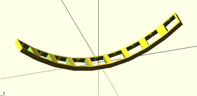

Apologies, for a more concrete example, I have these housings that I would
like to connect together so they print as a single piece.
https://github.com/Chocrates/keyboard/blob/master/demo.scad
So connect together in this case means that for the object centered at the
origin, I would like to connect the edge at -x and -y with the object next
to it.

Sat, Dec 30, 2017 6:44 PM
I haven't seen Torleif's code but from his images I think I had basically
the same idea.
I correct the arrangement of the frames in order to make them tangent to
the parabola.
And added two more frames just for fun.
a    = 2/20/20; // parabola constant
step =  20;
xini = -80;
xend =  80;
for(x =[xini:step:xend]) {
position(x) frame();
if(x>xini)
hull(){ // left gap filling
position(x)      slice( 19/2) frame();
position(x-step) slice(-19/2) frame();
module position(x) { // along the parabola
translate([-x, 0, axx])
rotate([0, atan(2ax), 0])
// cut a slice of children
module slice(x=10) {
// x is the slice position
thickness = 0.1;
intersection(){
translate([x,0,0]) cube([thickness,10000,10000],center=true);
module frame() {
union () {
difference () {
cube ([19, 19, 4.9], center=true);
cube ([15, 15,  10], center=true);
translate ([0, -7.125, 0]) frame_tappet();
translate ([0,  7.125, 0]) frame_tappet();
module frame_tappet()
rotate (a=90.0, v=[0, 0, 1])
rotate (a=180.0, v=[0, 1, 0])
difference () {
cube ([0.75, 2.9, 3.85], center=true);
translate ([0.5, 0, 3.85])
rotate (a=45.0, v=[0, 1, 0])
cube ([7.5, 3, 3.85], center=true);

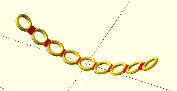

Sat, Dec 30, 2017 7:14 PM
It works equally well with tori!
step =  20;
xini = -80;
xend =  80;
position(x) torus(2,9);
color("red")
if(x>xini)
position(x)      slice( 9) torus(2,9);
position(x-step) slice(-9) torus(2,9);
module torus(r1=1,r2=3)
rotate_extrude() translate([r2,0,0])circle(r1);
Certainly the slice cut position (9 in this case) should be adjusted
