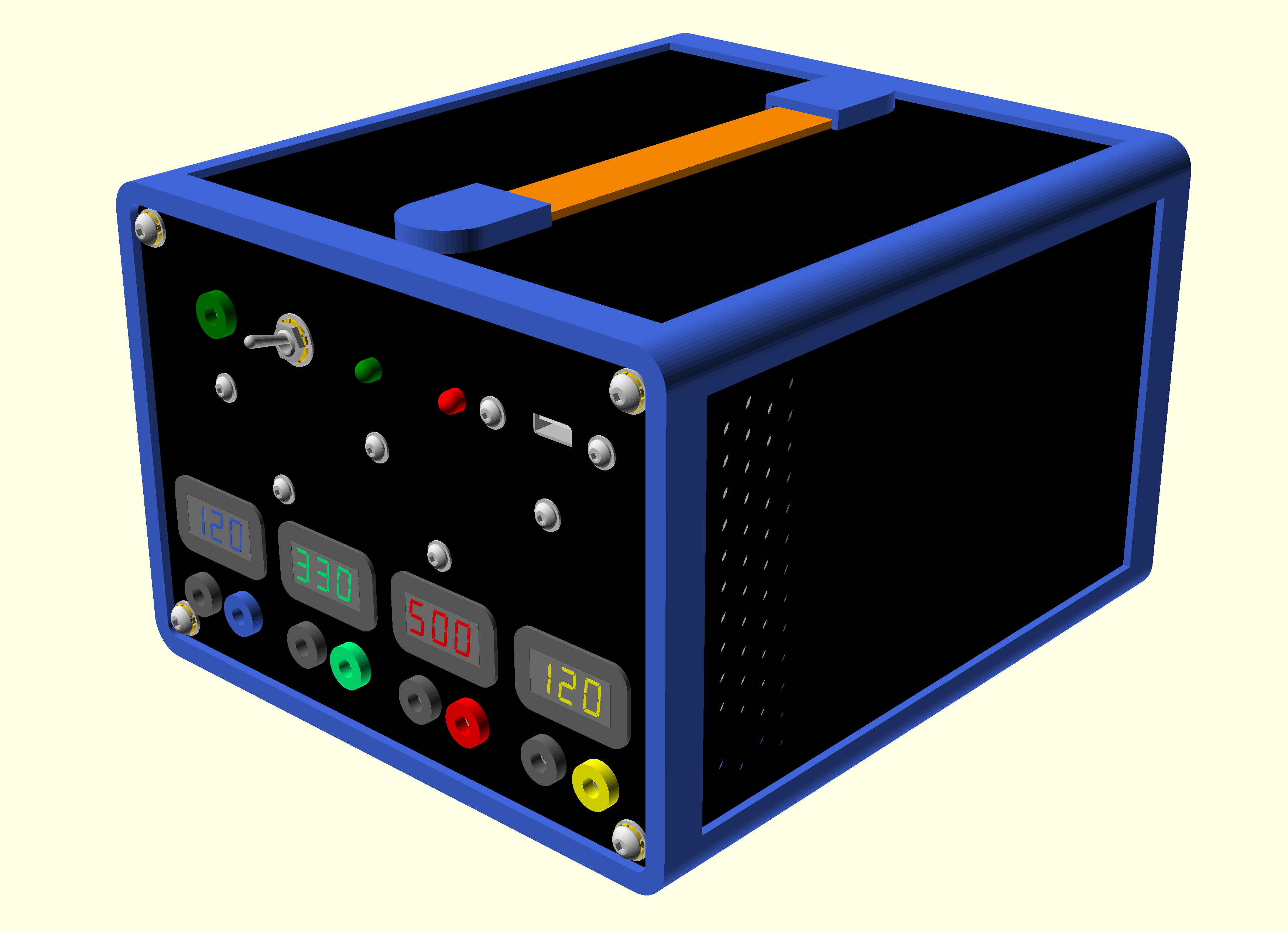

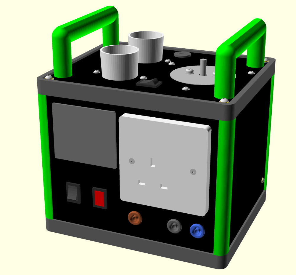

I use my own library in all but my simplest projects and find I need to​
add to it for most projects. It is mainly models of non printed parts that
I use in assemblies but does have some utilities and some printed parts
that I use across projects such as boxes, feet, handles and fixing blocks.
I started it about a year ago. I include it in every printed part design
because at the very least it sets $fa and $fs for printing and defines
polyholes. These are the the larger things I have made with it over the
last year.

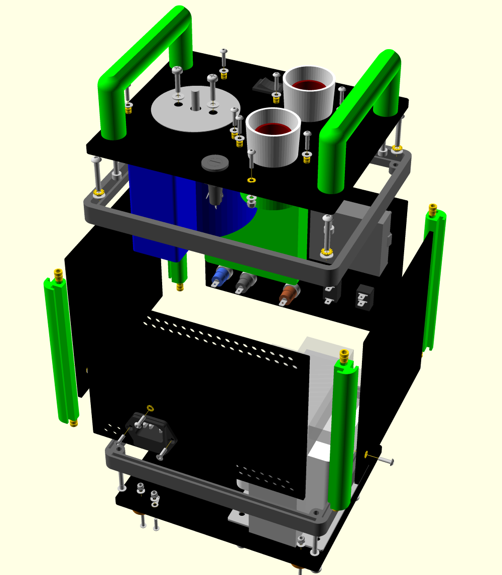

Cover and laser mount for HydraRaptor.
RPI LCD display case.
ATX lab PSU.
Mains PSU.
WiFi controlled photographic turntable.
Solder fume filter.

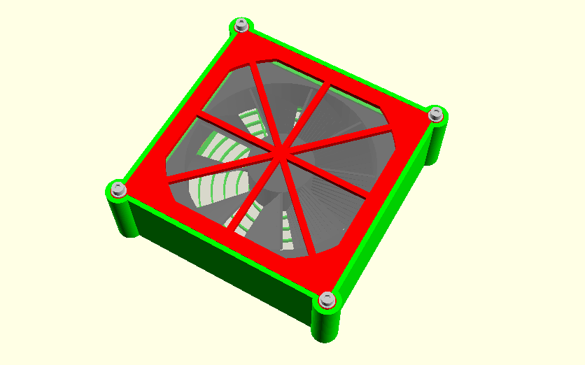

Troberg
Tue, Jan 2, 2018 8:37 AM
I often find there is a difference between cad programming and software
programming in that there is less returned value in the effort to find very
general solutions to a loose set of problems.
I don't agree, I find it extremely useful to have a good library of useful
generic code, both for convenience and for readability.
Unlike most here, I use OpenSCAD for making plans for builds, not for 3D
printing. So, I have a library with all the parts I use, screws, eyebolts,
threaded bars, nuts, washers, wooden parts, chains, hinges and so on. I also
have some useful math functions. There is also a bunch of useful operations,
such as modules to put a radius on a corner, drilling holes, making
transition curves and so on.
How does this help me?
  • I don't have to re-do each part.
  • If I make a better, more detailed model, it'll be replaced in every
    design. Fix once, apply everywhere.
  • Sure, I could just to a difference with a cylinder to make a hole, but if
    I make a difference with a hole object, it will clearly say "hole" in the
    code. Likewise, a threaded bar is simply a cylinder if a certain diameter in
    a certain color, but it makes for clearer code if it says threadedbar().
  • Since each object has it's own call, I get a part list. I know exactly how
    many screws I need, how many meters of each type of wood I need and so on. I
    get it with prices, where to buy it, product number, sometimes even which
    shelf in the store, and even the weight of the parts.
  • Since each object and operation have it's own call, I also get an
    "operations list". So, I know that I will have to measure and drill 300
    holes, and that'll take approximataley so many minutes. I know that I'll
    have to cut this many planks, and it'll take this long. If I want, I can
    also add extra operations that aren't parts-based, or just because I know
    that "rigging this up squarely will take some extra time...".
  • It helps me remember what resources I have. Often, I sit and think "how
    will I solve this problem?", looking at the parts and suddenly "Hmm, if I
    take a hinge and lock it with a slide bolt...".
  • It helps me keep a certain selection of standard parts. Nothing wrong with
    having more different parts, but if there is no good reason for it, stick
    with a part you have.
  • You can adapt the modules so that it's more handy to use. For example, my
    screws and bits that goes on screws (nuts, washers, wingnuts...) all have a
    z-offset and a parameter to flip them (where applicable). So, I create the
    screw, then simply stack everything that goes on it using only the z-offset,
    then move it in place. Example:
    bolt_M10(3);
    squarewasher_M10(0,false);
    squarewasher_M10(45,true);
    wingnut_M10(48,true);
This creates a bolt with a wingnut on the other end, and two square washers.
This can then be translated and rotated to wherever it's supposed to be.
Very simple and clear code.
