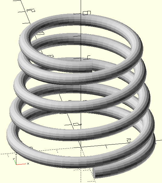

I don't see much difference, to be honest, left is my simulation of
linear_extrude with sweep:
http://forum.openscad.org/file/t887/rectquad.png
I also changed my springs code to get more lengthy quads.
http://forum.openscad.org/file/t887/springquad.png
Of course, the less crooked the rects are, the less negative effects you
get. So better design your code to produce almost rect quads.

I have been experimenting with sweeping and found a curious fact: If I use
the absolute minimum rotation angle method then a sweep that orbits the Z
axis gets twisted. If I use the relative method then it doesn't, my spiral
springs are no longer twisted around the wire's axis.
By absolute I mean each slice is rotated from flat to align it with the
tangent. This is the result. It goes wrong when the tangent points straight
down as there is no minimum rotation from up to down, they are all the
same.

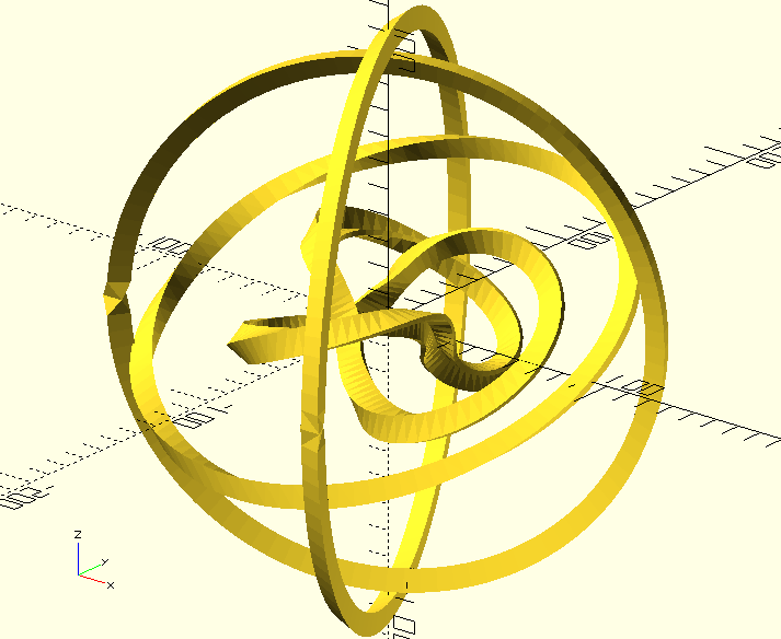

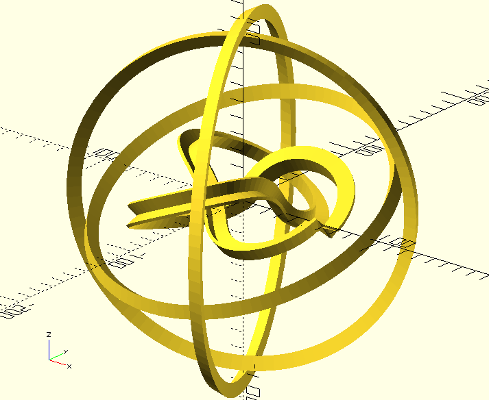

By relative I mean calculate the rotation from each tangent to the next one
and accumulate those rotations by multiplication. That of course has the
advantage that it doesn't go wrong when the path points straight down as a
smooth path never fully doubles back on itself.
A consequence is that closed loops don't always meet at the same rotation,
see the knot below. It is less twisty but it needs to twist 180 to meet
properly.
Looking at Ronaldo's solution he ensures it twists the right amount to meet
properly when the path is closed by distributing a calculated axial
rotation.
I was surprised that the absolute rotation gives a different result to the
accumulated relative rotations. I expected them to be mathematically
equivalent, but obviously they are not. I think it is because the absolute
one sort of takes a short cut when it does the minimum rotation all in one
go so arrives at a different orientation around the tangent than it does if
it follows the path of rotations. On the other hand the absolute method
always lines up where it meets because the absolute rotations for the start
and the end must give the same twist as they are the same rotation.
Any rotation is a minimum rotation for a pair of directions in a specific
set: those in the plane orthogonal to the rotation axis. So, if you compose
a minimum rotation from a to b with the minimum rotation from b to c, the
resulting rotation will be a minimum rotation from a to c if and only if
vectors a, b and c are coplanar, that is they all have the same rotation
axis. I haven't test it but I would expect that the global (absolute) and
local (relative) methods would have the same result if all path tangent
vectors are in a plane (and no twist adjustment is needed for closed
paths). Otherwise, they would differ.

Yes I appreciate that there are an infinite number of ways to specify the
rotation. I am aiming for the simplest code to draw springs and wires, etc,
so I want to specify just the path and let the code work out the rotations.
Speed is more important to me than numerical accuracy.
I was using a mixture of the absolute minimum angle method and
Frenet-Serret for different sections of this ribbon cable depending on
which broke. I.e. up and down are a problem for the former and
discontinuous curvature for the latter.
By moving to the relative mode it all seems stable and doesn't have wild
twists when the curve changes direction, so I can ditch Frenet-Serret
unless I want to design a roller coaster!
So thanks for all your help.
