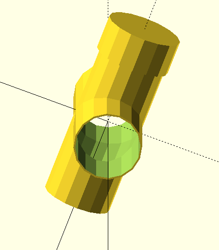

I think that the most obvious application for "negative objects" is in
intersecting pipes.
module pipe(length, od, id) {
        cylinder(h=length, d=od, center=true);
        cylinder(h=length+2, d=id, center=true);
pipe(length=5, od=2, id=1.9);
rotate([90,0,0]) pipe(length=5, od=2, id=1.9);
You might think this would work, but of course it doesn't because the
hole isn't part of the definition of the pipe, and so pipe A's walls
block pipe B, and vice versa.  If the holes were "negative objects",
then pipe A's hole would cut both pipe A and pipe B, and pipe B's hole
would cut both B and A.
But now I want to put a plug into one of the pipes, and the hole cuts
through the plug.
I think that the most obvious application for "negative objects" is in intersecting pipes. module pipe(length, od, id) { difference() { cylinder(h=length, d=od, center=true); cylinder(h=length+2, d=id, center=true); } } pipe(length=5, od=2, id=1.9); rotate([90,0,0]) pipe(length=5, od=2, id=1.9); You might think this would work, but of course it doesn't because the hole isn't part of the definition of the pipe, and so pipe A's walls block pipe B, and vice versa.  If the holes were "negative objects", then pipe A's hole would cut both pipe A and pipe B, and pipe B's hole would cut both B and A. But now I want to put a plug into one of the pipes, and the hole cuts through the plug.
Sat, Feb 5, 2022 2:52 AM
That's a nice application.  I had to give it a quick try.  So here's
two crosses with a plug:
include<BOSL2-fork/std.scad>
$fn=16;
tags("") cylinder(h=length, d=od, center=true);
module plug(length,od) {
cylinder(h=length, d=od,center=true);
diff("rem",keep="keep")
pipe(length=5, od=2, id=1.9,$tags="rem")
rotate([90,0,0])
up(5/2) plug(1,od=2.2,$tags="keep");
And the result is below.  I'm not sure if this is practical or not for
a full pipe network.  I think you'd have to build your pipes in a tree
structure, where pipe segments were children of other pipe segments
throughout the whole network.  Maybe that would work?  Hmmm.
ACtually I don't think you do have to do that.  It think you can just
give diff() a block of stuff in braces and tag everything
appropriately.  On the other hand, building pipe by connecting pieces
to other pipe is pretty natural.

That's a nice application. I had to give it a quick try. So here's two crosses with a plug: include<BOSL2-fork/std.scad> $fn=16; module pipe(length, od, id) { tags("") cylinder(h=length, d=od, center=true); cylinder(h=length+2, d=id, center=true); children(); } module plug(length,od) { cylinder(h=length, d=od,center=true); } diff("rem",keep="keep") pipe(length=5, od=2, id=1.9,$tags="rem") rotate([90,0,0]) pipe(length=5, od=2, id=1.9,$tags="rem") up(5/2) plug(1,od=2.2,$tags="keep"); And the result is below. I'm not sure if this is practical or not for a full pipe network. I think you'd have to build your pipes in a tree structure, where pipe segments were children of other pipe segments throughout the whole network. Maybe that would work? Hmmm. ACtually I don't think you do have to do that. It think you can just give diff() a block of stuff in braces and tag everything appropriately. On the other hand, building pipe by connecting pieces to other pipe is pretty natural. On Fri, Feb 4, 2022 at 9:11 PM Jordan Brown <openscad@jordan.maileater.net> wrote: > > I think that the most obvious application for "negative objects" is in intersecting pipes. > > module pipe(length, od, id) { > difference() { > cylinder(h=length, d=od, center=true); > cylinder(h=length+2, d=id, center=true); > } > } > > pipe(length=5, od=2, id=1.9); > rotate([90,0,0]) pipe(length=5, od=2, id=1.9); > > You might think this would work, but of course it doesn't because the hole isn't part of the definition of the pipe, and so pipe A's walls block pipe B, and vice versa. If the holes were "negative objects", then pipe A's hole would cut both pipe A and pipe B, and pipe B's hole would cut both B and A. > > But now I want to put a plug into one of the pipes, and the hole cuts through the plug. > > > _______________________________________________ > OpenSCAD mailing list > To unsubscribe send an email to discuss-leave@lists.openscad.org
