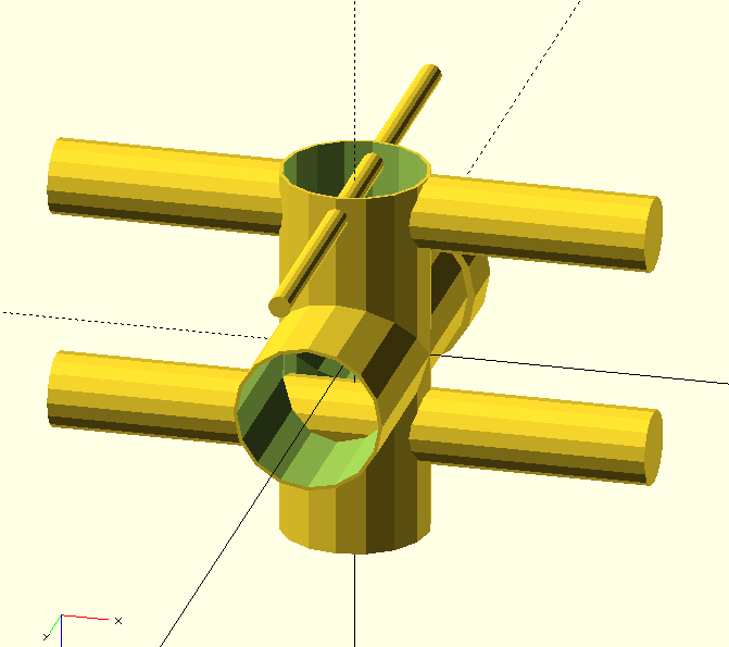

I've been experimenting with the BOSL2 tagging method to do this kind
of thing and it seems like it can do what you want without needing
changes to OpenSCAD.  In the example below based on pipes the pipe
interiors are subtracted from higher level parts of the model, the way
you want.  The subtraction stops at a certain level.  But maybe I
don't fully understand your vision.  So I'm curious what is the next
level of challenge for the vision you have?  How does this solution
(seem to) fall short?
Also note that there is another library, the General Library of
Relativity, that does something similar (maybe more complicated?).
https://github.com/davidson16807/relativity.scad
include<BOSL2/std.scad>
$fn=16;
module pipe(length, od, id) {
cylinder(h=length, d=od, center=true,$tags="");
cylinder(h=length+.02, d=id, center=true);
module plug(length,od) {
cyl(h=length, d=od,rounding2=.2,center=true,$tags="");
// Higher level objects don't have pipe interiors removed
down(2.2) ycyl(h=8, d=.3,$tags="keep");
diff("rem",keep="keep"){
up(1) xcyl(h=8, d=1,$tags="keep");  // Don't subtract pipe interiors from this
down(2) xcyl(h=8, d=1);
pipe(length=5, od=2, id=1.9,$tags="rem")
rotate([90,0,0])
pipe(length=5, od=2, id=1.9)
up(5/2) plug(1,od=2.2);

I've been experimenting with the BOSL2 tagging method to do this kind of thing and it seems like it can do what you want without needing changes to OpenSCAD. In the example below based on pipes the pipe interiors are subtracted from higher level parts of the model, the way you want. The subtraction stops at a certain level. But maybe I don't fully understand your vision. So I'm curious what is the next level of challenge for the vision you have? How does this solution (seem to) fall short? Also note that there is another library, the General Library of Relativity, that does something similar (maybe more complicated?). https://github.com/davidson16807/relativity.scad include<BOSL2/std.scad> $fn=16; module pipe(length, od, id) { cylinder(h=length, d=od, center=true,$tags=""); cylinder(h=length+.02, d=id, center=true); children(); } module plug(length,od) { cyl(h=length, d=od,rounding2=.2,center=true,$tags=""); } // Higher level objects don't have pipe interiors removed down(2.2) ycyl(h=8, d=.3,$tags="keep"); diff("rem",keep="keep"){ up(1) xcyl(h=8, d=1,$tags="keep"); // Don't subtract pipe interiors from this down(2) xcyl(h=8, d=1); pipe(length=5, od=2, id=1.9,$tags="rem") rotate([90,0,0]) pipe(length=5, od=2, id=1.9) up(5/2) plug(1,od=2.2); } On Sun, Feb 6, 2022 at 2:41 AM Carsten Fuchs <carsten.fuchs@cafu.de> wrote: > > I agree with everyone that all this only leads somewhere if it can be formulated for the general case. > > But why are many here assuming that such an formulation that is reasonably useful within OpenSCAD does not exist or cannot be found? > > a) It seems to have become clear that it is required to have a way to flag negative objects that are intended to have the property to also subtract from parents. > > b) And also required is a way to stop the property upwards the hierarchy. > > MichaelAtOz found an interesting link about this: > https://github.com/SolidCode/SolidPython/issues/11 > > which links to an example: > https://github.com/SolidCode/SolidPython/blob/master/solid/examples/hole_example.py > > Yes, this is very crude for a spec. But wouldn't you agree that this is the basics of a formulation that meets all requirements that have been requested so far? > > Best regards, > Carsten > > > Am 05.02.22 um 11:32 schrieb nop head: > > I don't think the problem is well defined enough for there to be a new operator. For a simple box the inside is easy to define but what if it is a convoluted shape where the outside is concave or is open on one face? > > > > Consider just a round pipe with a hole cut out of it merged with a panel. Should the hole in the panel be circular or a circle with a flat on it where the pipe has its hole? > > > > On Sat, 5 Feb 2022 at 09:43, Carsten Fuchs <carsten.fuchs@cafu.de <mailto:carsten.fuchs@cafu.de>> wrote: > > > > Am 04.02.22 um 16:51 schrieb nop head: > > > For that example you could subtract the hull of the box from the panel before unioning but you might get errors due the the lack of an overlap then. > > > > > > If the upstream box needs to have the internals marked, then why not just make the inside a module as well as the complete box? Then you can union the box with the panel and subtract the inside again. > > > > Yes, both are good and pragmatic solutions, but each also has its downsides. > > > > I think that I'll eventually apply the subtraction of the hull to my concrete assembly. It would still be great though if there was a solution in the form of some binary geometry operator like union() or difference(). > > > > Best regards, > > Carsten > _______________________________________________ > OpenSCAD mailing list > To unsubscribe send an email to discuss-leave@lists.openscad.org
Sun, Feb 6, 2022 10:08 PM
The power demonstrated here is amazing.  The only quibble I have is that
I often use "#" to figure out which code relates to which visible
object, and if you put that "#" at the start of the line
"pipe(length=5...", you end up highlighting two pipes and a plug. Adding
a ";" at the end of that line does not seem to damage the object being
described.  I guess I could separate out each object if I wanted/needed
to be able to get at them separately.
$fn=16;
rotate([90,0,0])
The power demonstrated here is amazing.  The only quibble I have is that I often use "#" to figure out which code relates to which visible object, and if you put that "#" at the start of the line "pipe(length=5...", you end up highlighting two pipes and a plug. Adding a ";" at the end of that line does not seem to damage the object being described.  I guess I could separate out each object if I wanted/needed to be able to get at them separately. Jon On 2/6/2022 9:41 AM, Adrian Mariano wrote: > I've been experimenting with the BOSL2 tagging method to do this kind > of thing and it seems like it can do what you want without needing > changes to OpenSCAD. In the example below based on pipes the pipe > interiors are subtracted from higher level parts of the model, the way > you want. The subtraction stops at a certain level. But maybe I > don't fully understand your vision. So I'm curious what is the next > level of challenge for the vision you have? How does this solution > (seem to) fall short? > > Also note that there is another library, the General Library of > Relativity, that does something similar (maybe more complicated?). > https://github.com/davidson16807/relativity.scad > > include<BOSL2/std.scad> > > $fn=16; > > module pipe(length, od, id) { > cylinder(h=length, d=od, center=true,$tags=""); > cylinder(h=length+.02, d=id, center=true); > children(); > } > > module plug(length,od) { > cyl(h=length, d=od,rounding2=.2,center=true,$tags=""); > } > > // Higher level objects don't have pipe interiors removed > down(2.2) ycyl(h=8, d=.3,$tags="keep"); > > diff("rem",keep="keep"){ > up(1) xcyl(h=8, d=1,$tags="keep"); // Don't subtract pipe interiors from this > down(2) xcyl(h=8, d=1); > pipe(length=5, od=2, id=1.9,$tags="rem") > rotate([90,0,0]) > pipe(length=5, od=2, id=1.9) > up(5/2) plug(1,od=2.2); > } > >
