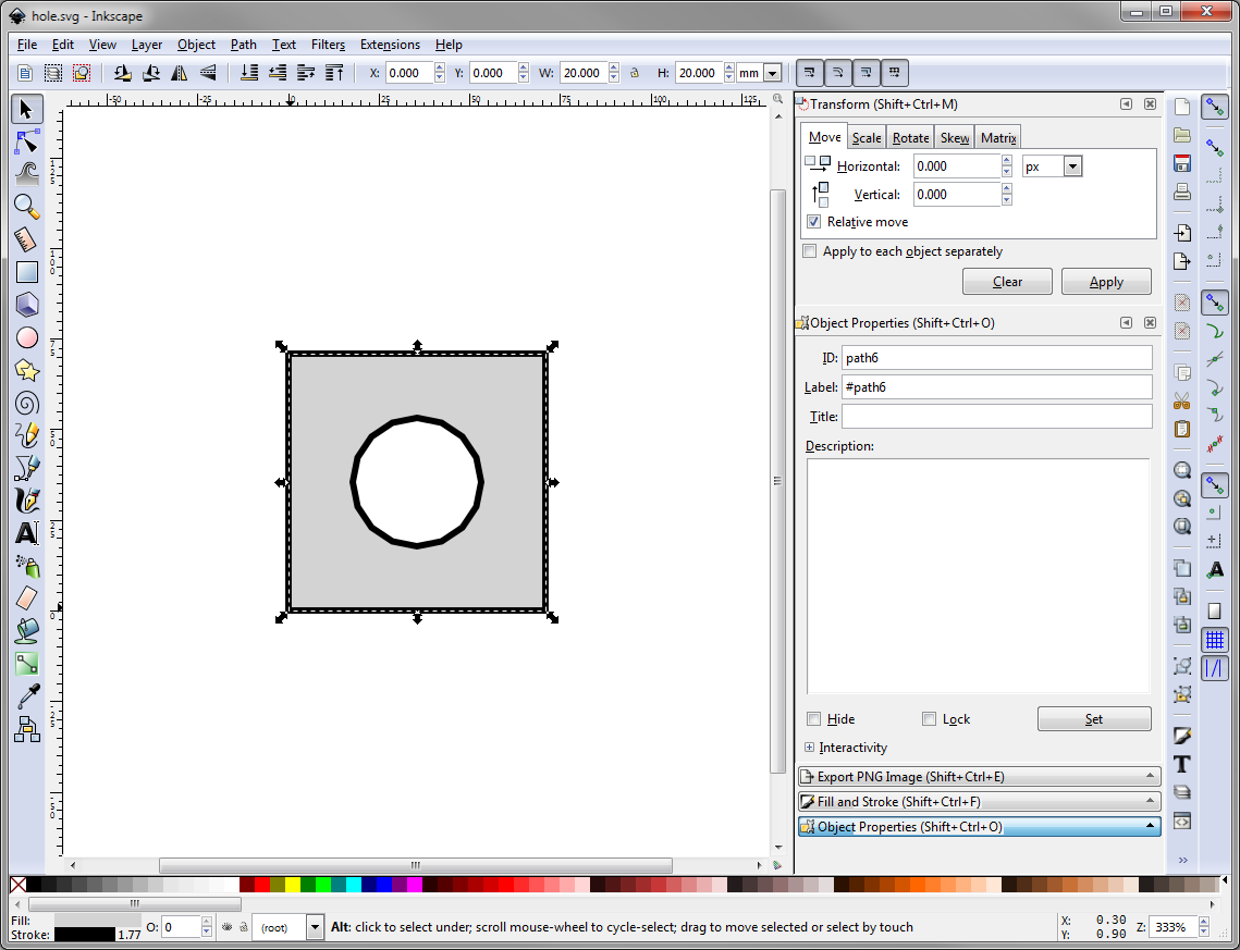

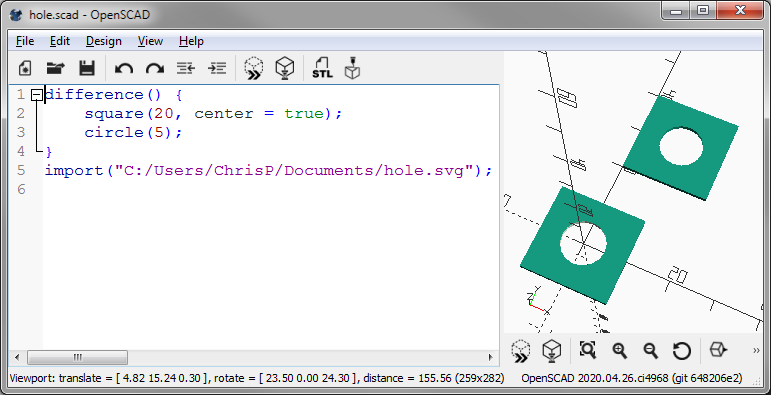

When I export a simple shape centered around the origin in SVG format and
then import it again it comes in with an offset, different for X and Y.
If I import it into InkScape it ends up with a corner at the origin.
Is there no standard for interpreting the coordinates?

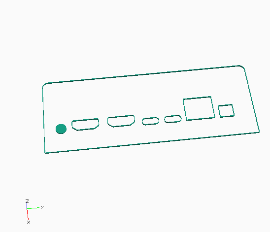

Another problem I have is when I import a panel with holes that was made
from a PDF using InkScape it imports outlines instead of a solid.
What determines if a path is interpreted as an outline of a polygon or a
stroke with finite width?

Well the viewport is supposed to give the origin indirectly, OpenSCAD seems
to set it correctly on export but interprets it wrongly on import. I am
surprised there isn't a test in the test suite that notices.
InkScape does seem to ignore it and makes the bottom left the origin. Also
if I convert it to DXF with https://cloudconvert.com/ it also puts the
bottom left on the origin.
It is probably a mess because SVG is designed to represent pictures, not
CAD data. I think OpenSCAD should be consistent with itself though.

I work with inkscape and have a setting (Viewbox X and Y=0, as I mentioned
here before) which is exactly what it should be!
The disadvantage is that the object is not made for "to look at".
Attached a simple circle around [0,0] with an unchanged document size (A4).
The preview (on mac) shows the 'empty' A4 sheet and I have to scroll down,
at the bottom left you can see a quarter circle.
In Inkscape this is also in the lower left, just where [0,0] is. In
OpenSCAD it is nicely centered, as expected with center at [0,0].
That's the thing about coordinates...

..so OpenSCAD import is fine.
I think OpenSCAD exports in a way for better "look at", moves the content
to >=0 (by adding some View x,y to it) so that the content appears on the
"light side"
If you import the attached svg in OpenSCAD and export it back to svg and
open it elsewhere you can see what I mean.

So basically you can't display anything with negative coordinates without
shifting it in SVG?
The OpenSCAD export coordinates range from -10 to +10. The viewBox starts
at -10 and has an extent of 20, which seems correct to me. I would expect
to see the full circle, not a quarter, but I don't expect the circle to be
moved. I expect the viewPort to range from -10 to plus 10 and the circle
stay on the origin in InkScape.
OpenSCAD has an infinite viewport, so I think it should ignore the viewBox
on import. I have no idea why it doesn't treat X and Y the same either.
