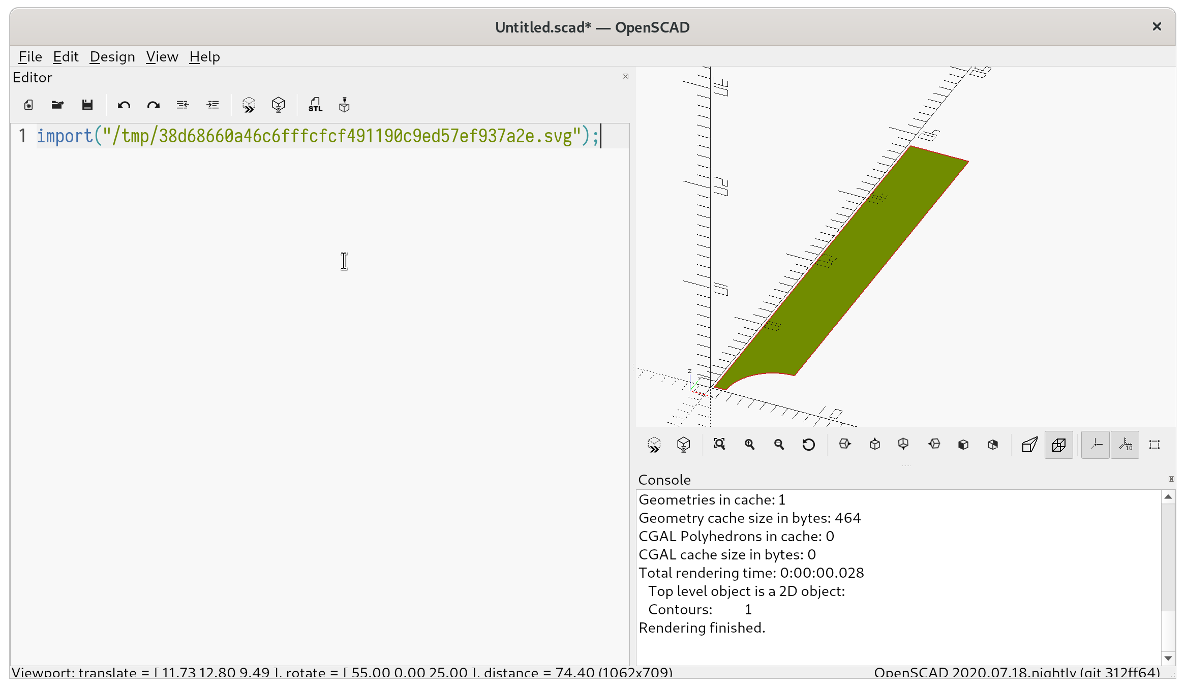

Thu, Jul 23, 2020 10:11 PM
On 23.07.20 23:11, WillAdams via Discuss wrote:
Seems to work for me (using snapshot version of OpenSCAD).
On 23.07.20 23:11, WillAdams via Discuss wrote: > https://community.carbide3d.com/uploads/default/original/3X/3/8/38d68660a46c6fffcfcf491190c9ed57ef937a2e.svg Seems to work for me (using snapshot version of OpenSCAD). ciao, Torsten.
Thu, Jul 23, 2020 10:17 PM
Shouldn't the tip be exactly at the origin if it is a milling bit?
Shouldn't the tip be exactly at the origin if it is a milling bit? On Thu, 23 Jul 2020 at 23:12, Torsten Paul <Torsten.Paul@gmx.de> wrote: > On 23.07.20 23:11, WillAdams via Discuss wrote: > > > https://community.carbide3d.com/uploads/default/original/3X/3/8/38d68660a46c6fffcfcf491190c9ed57ef937a2e.svg > > Seems to work for me (using snapshot version of OpenSCAD). > > ciao, > Torsten. > _______________________________________________ > OpenSCAD mailing list > Discuss@lists.openscad.org > http://lists.openscad.org/mailman/listinfo/discuss_lists.openscad.org >
