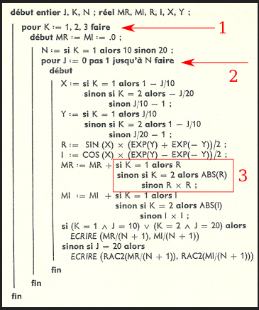

As the C language is very typical, it took a bit to compose to program the
equivalent.
I will however point out that this type of ternary statment is very old
since this writing was very used in the language "Algol" (Algo 60), first
language that I had learned in the university at the beginning of the years
1960. I enclose an example below taken fron the programmer's guide that I
kept (statment 3 and othesr) :
This this type of programming was widely possible at the time and I didn't
quite agree with a lot of colleagues who found this instruction great.
regards,
Lou Papet
