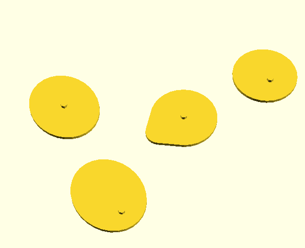

I don't know what you mean by a "true, mathematically accurate eccentric".
An eccentric circle simply means off centre, so you can just translate it
relative to the axis of rotation.
If you mean an ellipse then that is mathematically the same as a circle
scaled on one axis. E.g.
module ellipse(xr, yr) scale([1, yr / xr]) circle(xr);

That looks as if it should do it except that will make a single lobe (I
think but what do I know, my algebra teacher was far more interested in
getting the girls to the wet panties stage with his off color jokes than
in teaching the class algrebra, one of the reasons I quit school in the
middle of my freshman year and went to work fixing tv's for a living
in '48, ending up switching to broadcasting in '62, with a sign on my
saying Chief Engineer for most of the last 30 years of my working life.
I am also a C.E.T.) it needs to be like the usual woodworkers ellipse
layout tool, consisting of 2 pins and a string loop to fix the reach,
the string is dropped over the two pins, and a pencil is then used to
make the outline mark by using the string as a "thats as far as I can
reach" and stay inside the string. I want to do that in openscad so it
can be scaled and printed on a 3d printer. In this particular case an
Ender 5 Plus. At about 100mm in diameter, so the ellipse will have two
lobes. With about a 6 to 7mm total diff between x and y.

But the need for the ellipse continues. I'm making the bearings circular,
then insert the ellipse made on a mill from alu, to make it
non-circular. I have one made, but with the bearing groove too small, so
its a bit tight when filled with bb's and I can stretch it plenty far
enough to do this with only a couple ounces pull with my thumbs.

Can you make the shape you want by using hull() on two circles or
cylinders of different diameters spaced a bit apart?

It seems to me that Gene is describing an ellipse:
A video of this technique: https://www.youtube.com/watch?v=Et3OdzEGX_w
In which case the answer has already been posted by Nop Head (module
ellipse(xr, yr) scale([1, yr / xr]) circle(xr); ), and any confusion about
lobes or asymmetry is just that.

// 3 "eccentric"s
module disc(r) { cylinder(r=r,h=2) ; }
module rod() cylinder(h=4,r=2) ;
translate([60,0,0]) {// A circle is a circle. Can't be anything else
// if you rotate elsewhere than its centre, then it's motion is eccentric
rotate(360*$t) translate([5,0,0]) disc(20);
rod() ;
translate([-60,0,0]) {
// An elongated circle is mathematically the same as an ellipse
// if you rotate it about its center it has two "lobes" in Genes parlance
translate([0,40,0]) {
rotate(360*$t) scale([1.2,1,1]) disc(20); // ellipse 40x48
rod() ;
// you can rotate it about one of the foci, in which case it has one "lobe".
focus = (sqrt(201.2201.2-2020)); // distance of focus from center
translate([0,-40,0]) {
rotate(360*$t) translate([focus,0,0]) scale([1.2,1,1]) disc(20);
rod() ;
// a "hull" round two circles (with plenty of overlap) is a traditional
"cam" as in camshaft
rotate(360*$t) hull() {disc(20); translate([0,18,0]) disc(8);}
rod() ;
Best viewed as an animation, f.eks. FPS 5, steps 25

// 3 "eccentric"s module disc(r) { cylinder(r=r,h=2) ; } module rod() cylinder(h=4,r=2) ; translate([60,0,0]) {// A circle is a circle. Can't be anything else // if you rotate elsewhere than its centre, then it's motion is eccentric rotate(360*$t) translate([5,0,0]) disc(20); rod() ; } translate([-60,0,0]) { // An elongated circle is mathematically the same as an ellipse // if you rotate it about its center it has two "lobes" in Genes parlance translate([0,40,0]) { rotate(360*$t) scale([1.2,1,1]) disc(20); // ellipse 40x48 rod() ; } // you can rotate it about one of the foci, in which case it has one "lobe". focus = (sqrt(20*1.2*20*1.2-20*20)); // distance of focus from center translate([0,-40,0]) { rotate(360*$t) translate([focus,0,0]) scale([1.2,1,1]) disc(20); rod() ; } } // a "hull" round two circles (with plenty of overlap) is a traditional "cam" as in camshaft rotate(360*$t) hull() {disc(20); translate([0,18,0]) disc(8);} rod() ; Best viewed as an animation, f.eks. FPS 5, steps 25 [image: image.png] On Thu, 29 Apr 2021 at 14:29, Will Hardiman <bill.hardiman1995@gmail.com> wrote: > It seems to me that Gene is describing an ellipse: > > >it needs to be like the usual woodworkers ellipse > layout tool, consisting of 2 pins and a string loop to fix the reach, > the string is dropped over the two pins, and a pencil is then used to > make the outline mark by using the string as a "thats as far as I can > reach" and stay inside the string. > > A video of this technique: https://www.youtube.com/watch?v=Et3OdzEGX_w > > In which case the answer has already been posted by Nop Head (module > ellipse(xr, yr) scale([1, yr / xr]) circle(xr); ), and any confusion about > lobes or asymmetry is just that. > > On Thu, 29 Apr 2021 at 13:05, jon <jon@jonbondy.com> wrote: > >> Gene: >> >> Can you make the shape you want by using hull() on two circles or >> cylinders of different diameters spaced a bit apart? >> >> >> On 4/29/2021 7:59 AM, doug@milmac.com wrote: >> >> Gene, I’m afraid it’s still far from clear (to me, at least) what exactly >> you’re trying make. Ellipses don’t have “lobes”. Perhaps you could post a >> hand-drawn sketch of what you want to make? >> >> Gene Heskett wrote: >> >> …That looks as if it should do it except that will make a single lobe … >> so the ellipse will have two lobes >> >> _______________________________________________ >> OpenSCAD mailing list >> To unsubscribe send an email to discuss-leave@lists.openscad.org >> > _______________________________________________ > OpenSCAD mailing list > To unsubscribe send an email to discuss-leave@lists.openscad.org >
